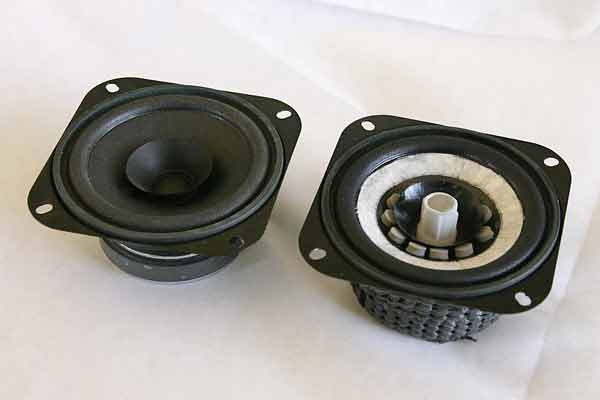

Inrank, here is a pic of the modded and non modded 4 inch drivers, the modded one also has a phase plug made from the cut down cap of a glue tube nozzle, the Phase plug works really well making the highs smoother. These drivers sound brilliant in a double bass setup with sub, I have also used them on winged open baffles and the results were very nice.

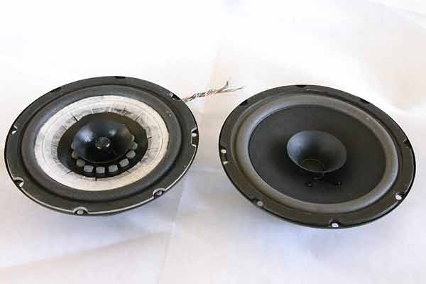

Inrank just for interest here is a similarly modded 6.5 inch driver, these also sound good, and I will probably use them on an open baffle. These cost just $5.00 OZ (about $3.20) US and including the mods owe me about $7.50 each. No specs but efficiency is pretty high and they reproduce the highs very nicely as well without a super tweeter.
I have other pics if you need more info.
The phase plug is actually the top of a black whiteboard marker, I go through heaps of these as I run a digital training business, so its a freeby.
