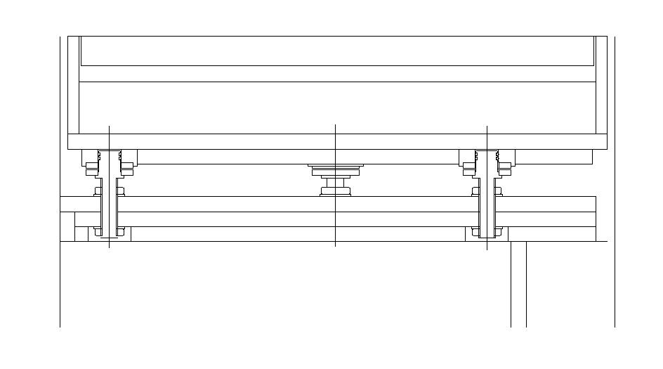

I put my TT on decent sturdy sandbox, made of birch plywood and suspended on three pairs of superstrong neodimium magnets. Buzz is gone forever. The lesson learned (again): your arm is not suspended in free space; everything is mutually depending. The better your arm becomes, the more weak points is being revealed along the whole playback chain.

Interesting support you have going on there. So your levitating a sandbox with magnets? My plinth is birch ply, although im going to make another as im re-designing the TT. I always planned to incorperate a sand box but need to build a decent table first. Any chance of a pic of your magnet set up? I know theres some pretty strong magnets out there these days, but how much weight can they levitate?

Here ya go!Any chance of a pic of your magnet set up?
Magnets bear the box/TT weight, double o-rings hold it in lateral direction.
Thanx, i think i get the idea.
