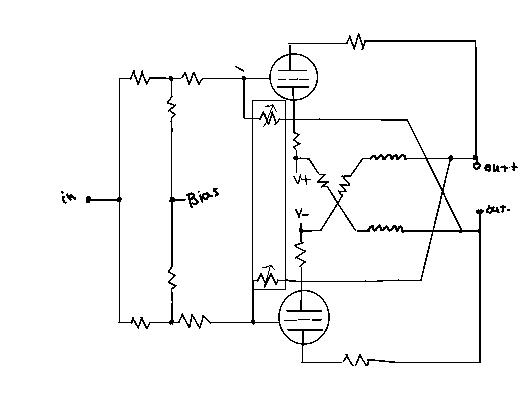

Would this work
Y hallo there! This is my fist attempt at designing any sort of amp, and I would like to know if it would even work!
Is my basic amplifier scematic solid?
All I can do is some wild guesses...What is it for and why these bootstraps at the output?
I can't seem to figure out what it is you want to do with it really...
Would you recomend that tube?
I certainly plan to use it in the near future, the feedback I heard from others seems quite positive so why not...
Cheers,😉
ok, it said voltage control so i was confused. the schematic is for a minimalist tube amplifier. All I want to do with it is to be able to say I built a simple amp that sounds great. The crisscross inverter thingy on the output is a stupid idea I had of a way to avoid putting a capacitor directly in the output line (it seems to me like a cap there would depreciate SQ) Or would grounding each side with an inductor work just as well?
