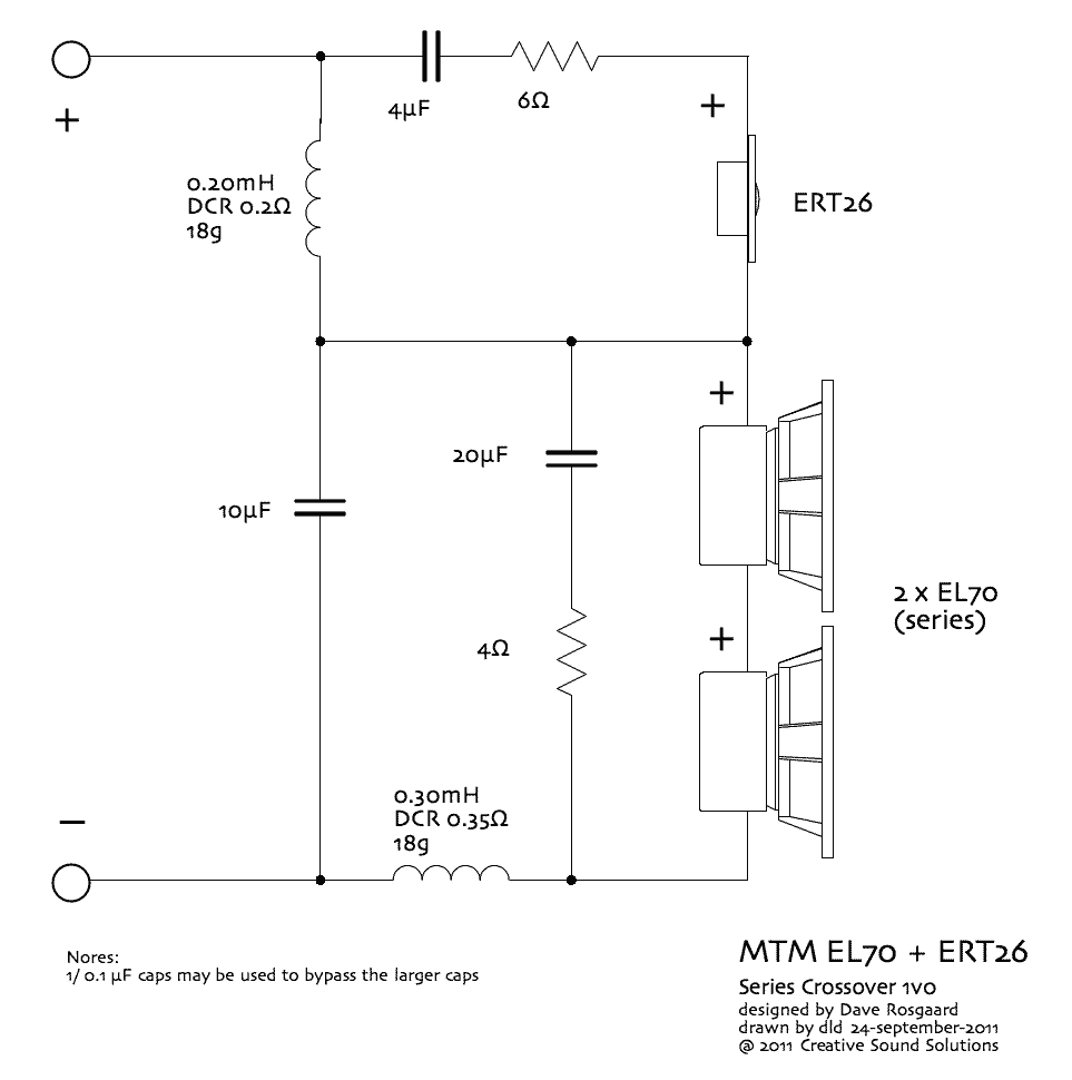

Bob commissioned Dave Rosgard to do some XOs for the EL70, and has given me permission to post them. He will be working on gathering parts kits for these (and XIs for the CHBW+ERT70)
As per Robert's comment it will be noted that these are 2nd order. The MTM in particular is intriguing. The tweeter could likely be pod mounted on the top of Cogitech's Castles (the tweeter might need a little additional padding) or one could use the TM and just run the top EL70 FR (you'd need a secound amp or something 2 ohm capable.
I have the little Daytons, they are a nice form factor but not near the tweeter the ERT26
dave

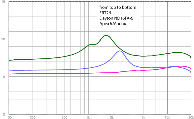

But given the impedance rise of the ERT or the Dayton, likely not a lot of worry, and if the XO is up were it would be for just a cap XOed T you could get away with the ApexJr which has no issues with impedance rise, and is the price leader to boot.
attachment.php
dave
Those are mild impedance plots, which is great. The problem is, Fs is going to be attenuated less than 9db no matter what the plot looks like, and that may sound like a door buzzer at even modest levels.
I think we're all agreeing to cross higher. With those schematics, now there's a lot less guessing 🙂
Is that apex a piezo? Or a ribbon? Price leader so likely not a ribbon 😉
