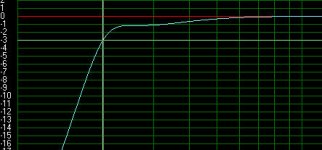

A quick input of the parameters for the Diamond Audio shows it should make a fine HT sub in a ported enclosure. The plot below was with 2.5 cub. ft. ported enclosure tuned at 22 Hz & shows f3 (3 dB down) at about 20 Hz. Can't run a simulation on the Arc Audio because you don't have Vas spec listed but it looks like it could work also but with such a low Qt & it's starting fs of 22 Hz may not tune quite as low as smoothly. Qt's that low generally need to be tuned at least somewhat above fs for decent response curve & power handling. I don't think either would do as well for HT in a sealed enclosure as the fs is a little high for the Diamond & either Qt is to low or fs to high for the Arc.

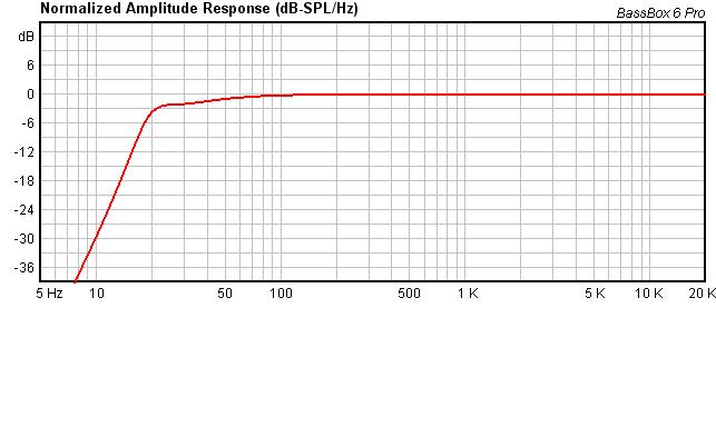

Thanks Stephen, I was able to come up with very similar results using bass box pro. I think the Diamond will make a good temporary sub, I will get one of the plate amps that are atleast 250 w, and the Diamond sub is a dual 2 ohm so it will get the 250w. When I run simulations, what should I be looking for? I know a good flat response curve, but as far as the Fb and F3, what would be ideal?

An Fb of around 20-40Hz. as you want the box tuned in the area where punchiness for HT will count and the F3 around this range as well. Without EQ though, the box may simulate as having a higher F3 so, you shouldn't be too worried about that as EQ's around the 25-45Hz. range are common and usually extend the flat response about half an octave or so. Though the specs are incomplete for some estimations on perf. and such, the Fb may end up at about 35-40Hz, perfect for your application. Right now I have a Shiva w/100WPlate-amp w/25Hz +-6dB EQ..great sound from a fairly large enclosure though....At 53L. it's on the edge of being too large for most people. This is where the Linkwitz transform comes in.

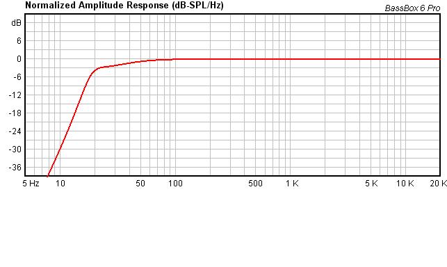

nuttinbutSQ said:how is this, I was able to get this out of a 2.5 cf with a fb of 21hz and a f3 of 20.4hz. Has a single port of 3"ID X 15.47" long. Please bare with me this a all a new learning experience for me.
I'd say that's dandy. With that low of tuning I don't think you'd have to worry about putting a high pass filter to protect against infrasonic below the port tuning causing excessive wasted excursion & you've gone plenty deep enough to enjoy every earth quake & bomb blast HT can hit you with. I might suggest trying to fit a larger diameter port in though (which then would also be longer) because at 3" the port air velocity will be pretty excessive at high SPL in that range & could cause audible port noise not to mention some power compression. One complication of ported cabs with low fb's is the ports can get very long. For a 4" port WinISD shows 27.66" for a 2.5 cf enclosure with fb of 21 Hz! Would need to curve the port with elbows or make wood rectangle port following cabinet walls or something like that. Also remember, port volume & speaker displacement volume are added to calculated enclosure volume to give actual final volume of enclosure.
Flat response is one thing to aim for but it's not the only thing & not really a priority as it can be EQ'd. Other things to look for are max SPL, cone excursion & extended bass response. Often we sacrifice a little flatness in response curve to optimize something else like extended bass range, max SPL over a certain range or even enclosure size limitation.
I ran a simulated SPL plot at 250 watts with that speaker & enclosure & WinISD shows 105.66 dB/1 meter at 20 HZ & roughly flattens out to about 107.7 dB at 50 Hz & above.
Did a cone excursion plot at 250 watts & it doesn't max out till about 17 Hz. 20 Hz & above is nowhere close to approaching Xmax.
Should be pretty kick but HT sub. Go for it.
Thanks for your help, I did a few more calculations to try and squeese a 4" port in, I thought 3 could have some port noise. But any how I had to increase the enclosure size to a 3cf cube design that is 17.64" (internal dimentions) all the way around. A single 4" port that is 22.14" in length. I will have to put a bend in it but that is not a problem. The final parameters vb: 3cu.ft, fb: 21hz, and F3 of 20.9hz. Here is my final graph. If all goes well I won't even have to change this sub. Thanks again for your help and guidance in the right direction.

I just wanted an enclosure that would give me the best low end I could get out of the subs I have. Sealed are very easy to build, generally have a flater response (except in this case as the sub will only be playing from around 50 to 60hz down). So in this case ported is the way to go, a bit more difficult to build and some what larger, I was able to get a good response all the way down to 20hz.
