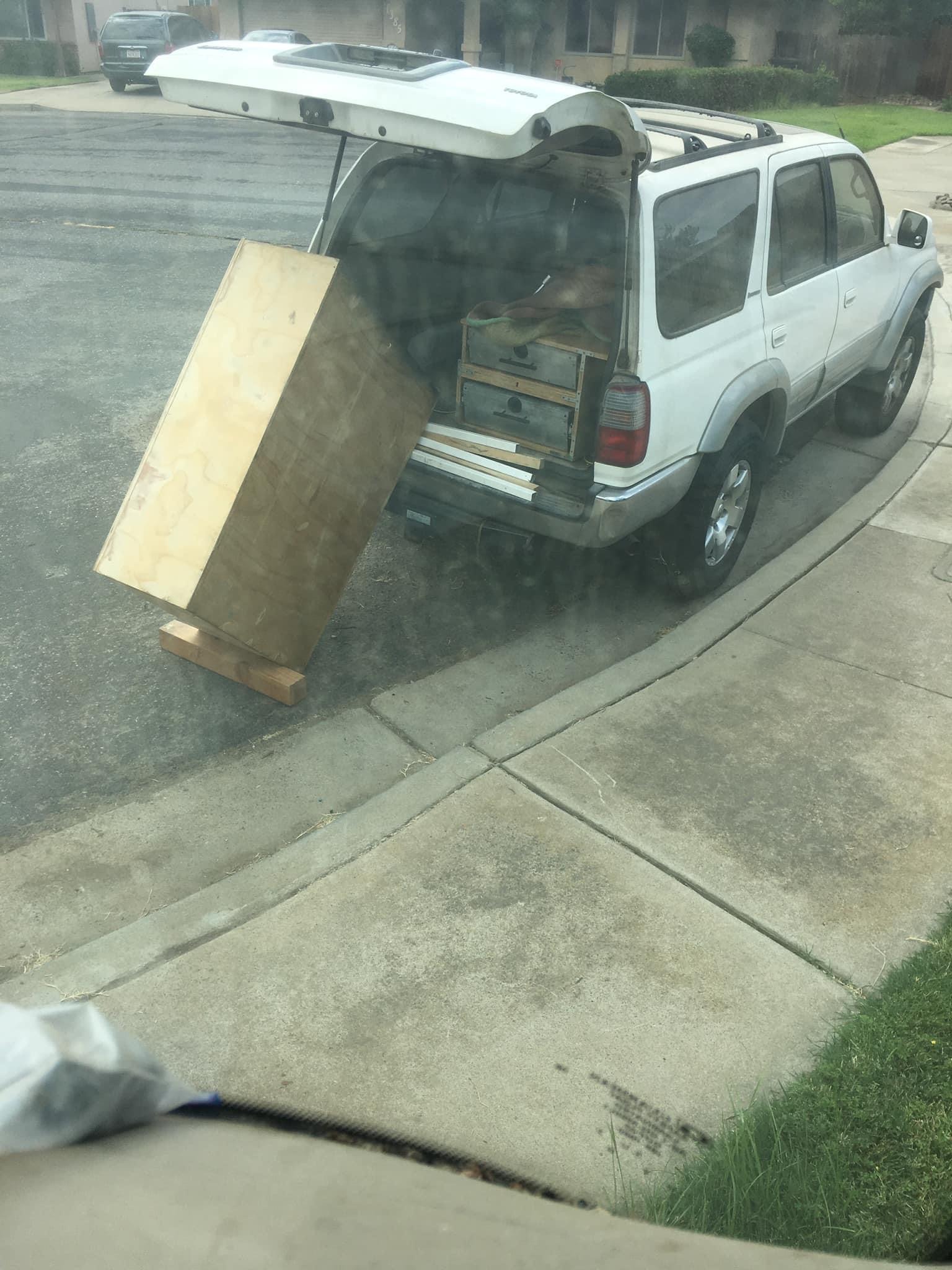

I currently have a rectangular box with the sub facing the passenger side window and the port facing the driver side window, centered in the cargo area What's nice about Suburbans is that its a box inside a box so you get quite at more out of a smaller sub. At least what I noticed compared to my friends builds inside normal sedans.Inside a vehicle you can get stuck with a bunch of weird scenarios that can create the same thing as an offset driver position does in a TL. Isnt it a total sh!t show if you’re not just bouncing it off the rear glass and sitting at the front glass In a nice rectangle shaped interior?

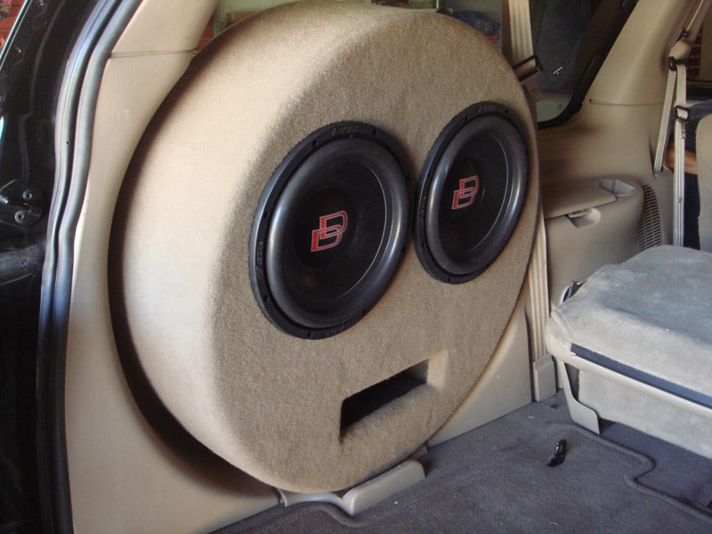

And I was thinking the same thing with the offset driver position but I've seen a few other builds. The picture attached is one that I really like. And funny enough they used DD woofers too.

I have a table saw so I was going to do spaces out cuts and cut them at an angle, then come back over those cuts and hit the angle the other way. Maybe a little bit of steam to keep it from cracking, but I don't want the wood to swell. My father is a carpenter/woodworker and he will most likely help me with the whole process. I also could probably just make good prints and take it to a cabinet shop to have them build it for me if I want to. I mean they have more fancy tools than I have. I do like in the San Francisco Bay Area so I could try to hit up Bobby Gately or Steve Meade and see if they can build my design. Last time I talked to Bobby to get a quote it was starting $1600, his design. So probably a front port like the DD picture I posted.Conceptually the shape of the box/port is no problem.
