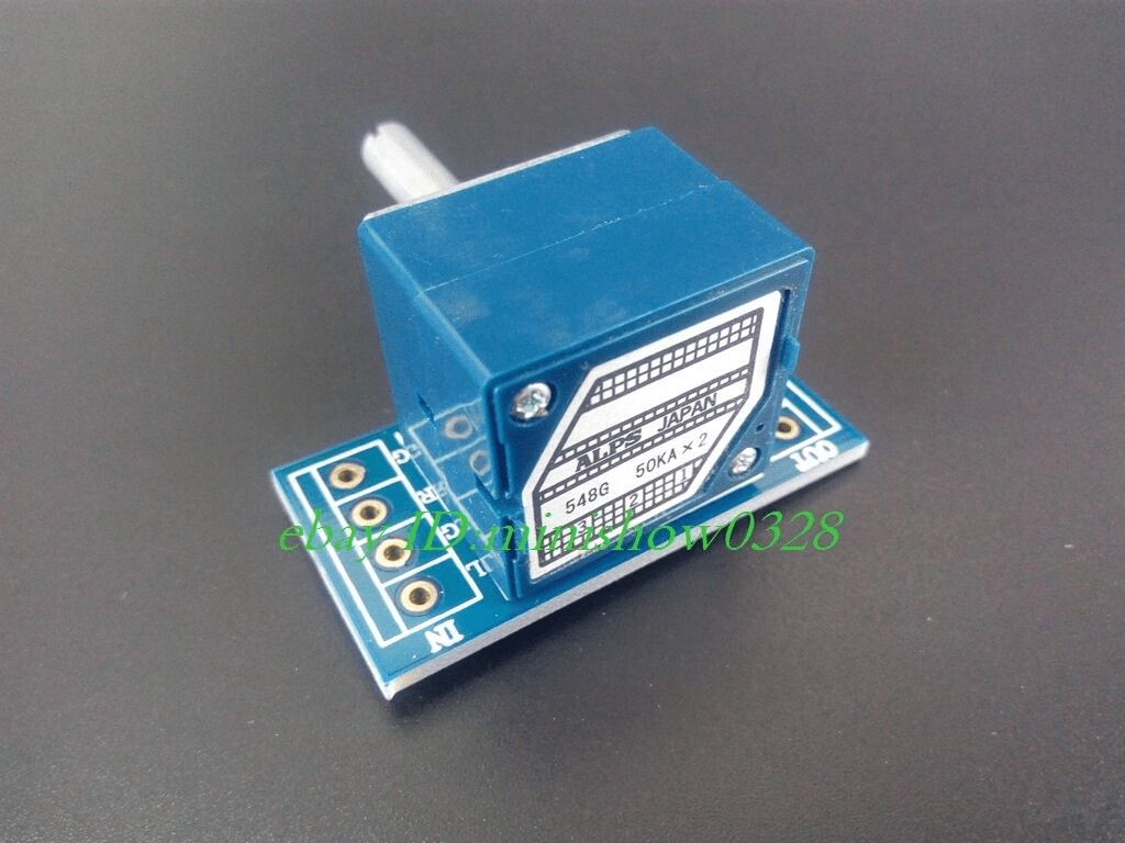

In my boat I need a way to control line level to power amps volume, first to the subwoofers, but I will expand it to the two other power amps, to the front and rear speakers. The headunit sending out the line level signal is a Pioneer car audio headunit with nothing special, the subs are JBL marine 10" active, sealed subs and the two amps are Alpine and something I can't remember right now. But basically it works like any plain vanilla car audio stuff. The creator of CamillaDSP, @HenrikEnquist gave me the idea that I will go for, using stuff I know from before: A potmeter turned by an RC servo directly connected to it (I have a few ideas for that, it will be simple and totally reliable), controlled by an ESP32 (he actually said an Arduino, but I know ESPHome and didn't really need to learn Arduino, so I will use the servo library in ESPHome). The servo position will give me the position of the potmeter in degrees, which I can convert to a 0-10 or similar scale. That's not even the most important, the important is that I can hear that nothing is distorting.
So what kind of a potmeter should I use? I don't do advanced soldering, so I would prefer something either ready made or very easy. I found this on eBay:
https://www.ebay.co.uk/itm/144711214369
It's an ALPS, seemingly legit, RK27 A100K, so 100 ohm. It also has a PCB where the connections are easy, I can solder that without problems. It's like replacing keys on my Matias Ergo Pro Keyboard. Would that one do what I need? Or do I need a different resistance, like 50 ohm? I see that it says 2x 50, so maybe 50 is per channel. I know close to nothing about this stuff (somewhere between Manuel and Basil Fawlty) and hope somebody can help me, and that I gave the necessary information.

I would say it is neither an ALPS nor 100R.
It looks to me like it is a copy, the font is wrong and stereo 50k with two of the contacts cut off. Plus they are supplied from Japan not China.
Active subs require a mono line input, not stereo. The human ear cannot detect stereo sub bass. All that happens is loss of bass in pockets as you walk around the room/area.
If you have a 50k potentiometer or indeed a voltage controller attenuator will be fine.
Beware of ground and power supply loops!
@JonSnell Electronic Goes to show how much I know... So where do you suggest I get the real stuff? As you understand this is not high-end, so if there's a well functioning cheaper potmeter I'm all for it.
And I forgot to say that there is a dual sub output from the headunit, and they have separate signals (but they are marked as Sub1 and Sub2, not left and right). That's why I thought a two channel pot was warranted.

Also the subs have different profiles for the crossovers in the menu of the headunit, so I think they must have different signal paths.
But then I'll order a few different pots and test them out, thanks!
