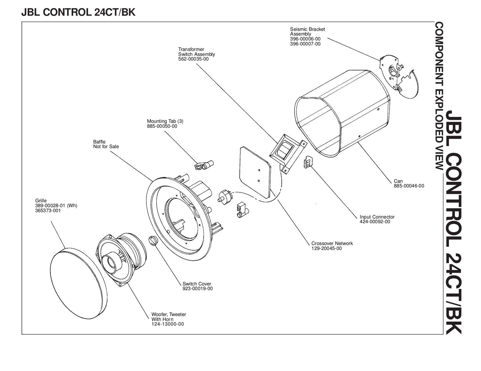

I have the opportunity to buy 50 sets of these co-axial in-ceiling JBLs. I was wondering if these would make good floor to ceiling line-arrays? What do you all think?

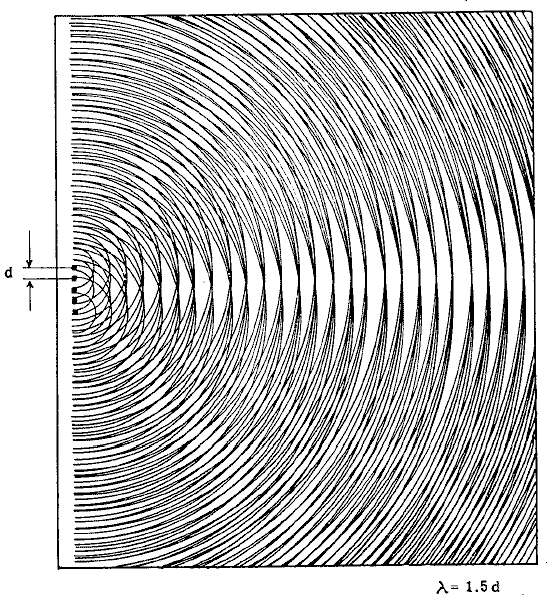

If the price is right, it could make a fun exercise. The high frequency combing on the tweeters will be comparable to a full-range speaker array though, as the distance between tweeters is the same (center to center). Though that horn on the tweeter might help limit dispersion. It's behavior could be simulated with Vituixcad. Much like what we did for full-range arrays in this thread: Array simulation starter set

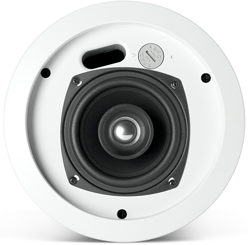

What's the frame size of the coax?

They are 4" drivers. At a buck a pair, I don't have much to lose. at 4" each, that would be approximately 20 drivers for an 8 ft tall cab. I'll measure them to see if they'll work in open baffle too. If nothing else, they would work on either side of the TV.
In an arrary with tweeters, the tweeters need to be as close as possible.
They will make a lousy line array becasue you cannot achieve that.

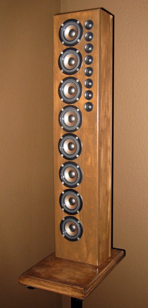

if possible, can I remove the tweeter/horn and mount them nut-to-butt off to the side of the mids? Like this?
Extreme comb filtering in the HF.

HF gets “confused”. Not sure what the high spacing does to the 3dB/octave fall-off due to the disparate distances from the listener.
Yes. Good luck extracting the tweeters.

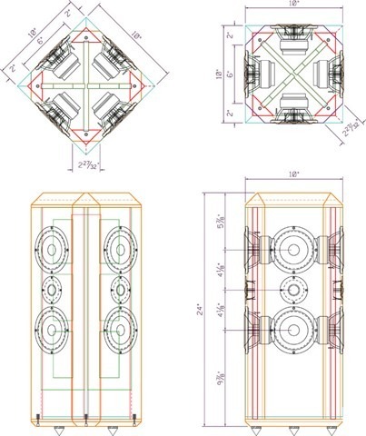

For fun at that price I would build either Open Baffle with a bunch on each side (you can get 50 pair wow, sounds like? At that price who cares.) or Gary Eickmeir- IMP
