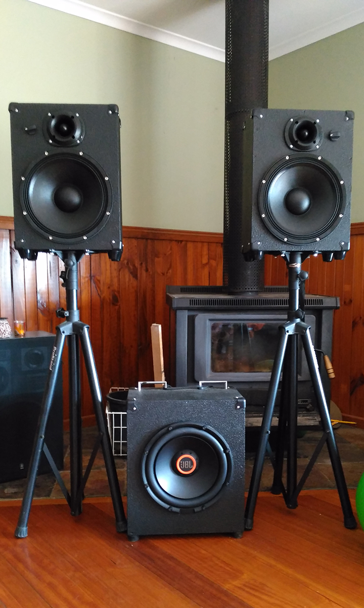

A pic of a home-made PA is attached, consisting of:
JBL 12" S3-1224 sealed sub.
Lanzar Evo294 Class AB amp plus 850W AC/DC powersupply.
2x Faital Pro 12FH520 12" mid-bass.
2x JBL Pro Selenium ST400 tweeters.
SYNQ DIGIT 2k2 amplifier.
It is a tiny portable system I built. Works amazing and measures amazing once setup for a space, and very sensitive. There is good feedback from average people - 'big' sound, 'detailed' and very happy. But bums wiggling is all that matters. I have been hobbling together foldback from old powerful book-shelf speakers, but they do not cut it if and when the punters want the FOH/sub louder for more raucous moments.

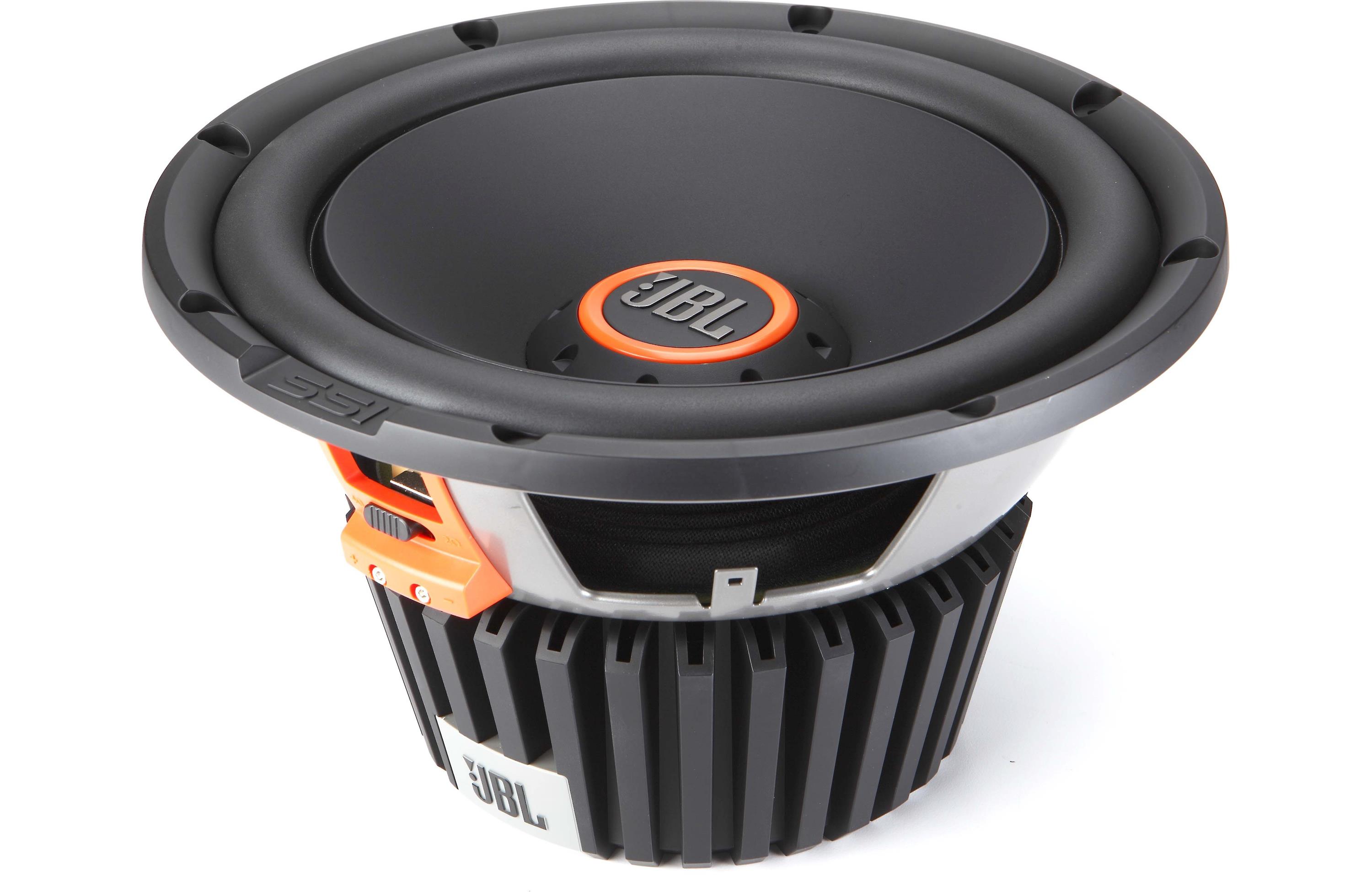

I have owned 18" ported subs many times - but moving them sucks.
Not all 12" drivers are made equal 😉 And 'bass' is rarely below 40hz. Sure, you might see it, but not really hear it. Shaking things isn't really music. The sub weighs 28kg as is (active).
'Mobile', one man, no roadies, not even a trolley. Home made. Would anyone check out the driver list and calculate the SPL for me? It has been years since I did that now.
That JBL sub would be the best I have heard. I also own a heap of Richard Allen gear and all kinds of stuff. I have a very special collectors 12" driver from the early 80's supposed to be a 'best ever' from the UK....
I use Yamaha NS-7171's and Sansui B-2101 in top condition (thank you Clarke Audio) to compare anything.
I went for that sub because all competeing 'hifi' OR 'pa' speakers were not ACTUALLY subwoofers. 'Car audio' JBL sells ACTUAL subwoofer drivers (as in they cannot reproduce over 200hz due to the cone design).
I fail to see why 'pro' gear does not use them, except to keep cost down and reuse the 'sub's in two-way systems.

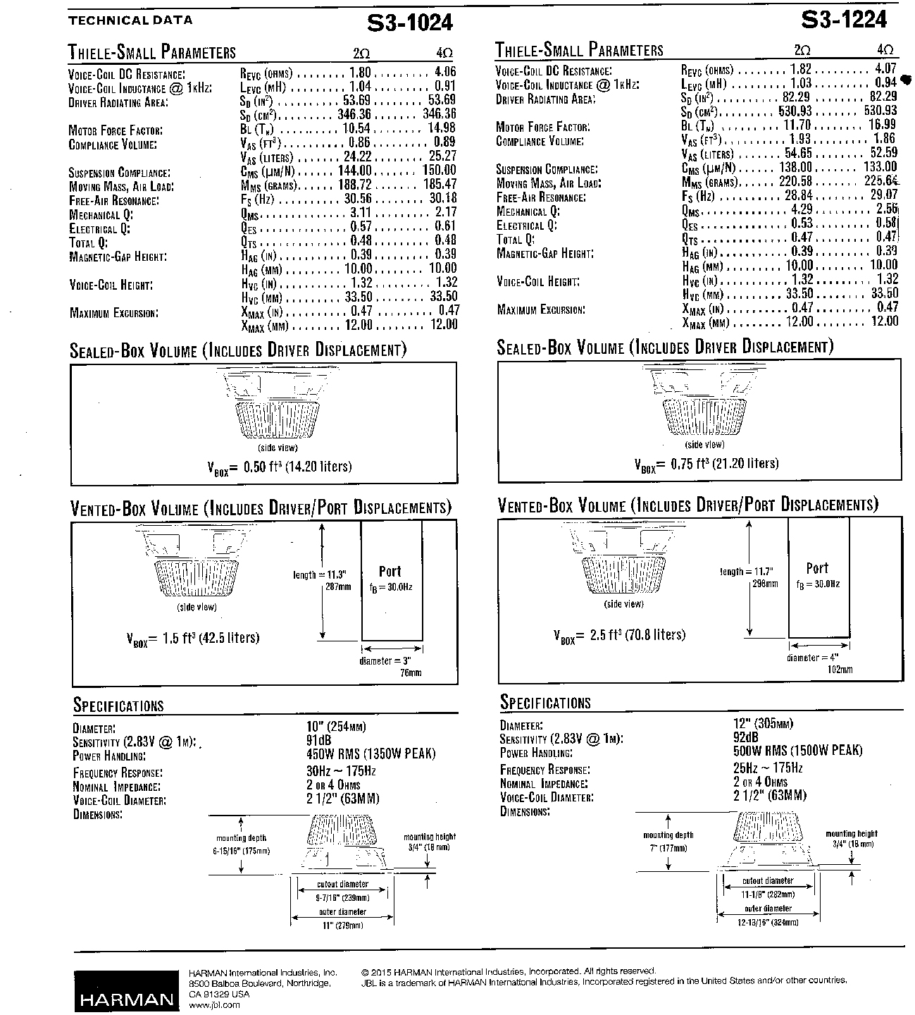

I do know one reason not to use that driver (for a sub) - getting the tech specs online first, is hell - but they are in the box.
They are very good and I can scan and upload them if anyone needs. Unbelievable that you can't find them - maybe they are new?

JBL S3-1224 Specifications
Comments/thoughts on the driver data there, anybody?
Curious about peoples opinions. I will post these over on subs forum.
Yep - pretty sure you have convinced me to build the second sealed sub, and hook it up in a 2x2 Ohm config. The Seasonic PRIME 1300 W GOLD power supply provides 108 Amps at +/- 0.5% load regulation, at less than +/- 10mV ripple. That is insane and should run the amp and both drivers fairly easy.
OR - should I build a whole new PORTED cab, with the 2x 12" drivers?
