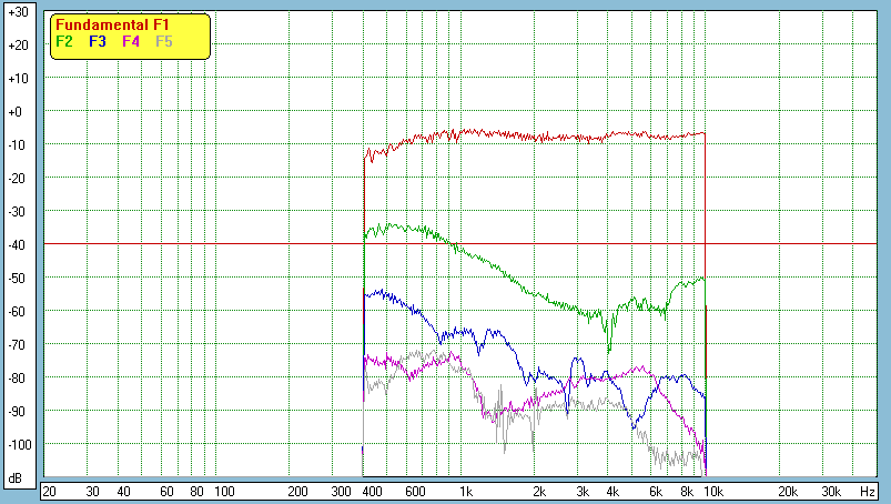

I have a new contender for the 15 inch midrange. The Faital pro 15pr300. It appears to have slightly "better" (looks like it can be crossed over higher before it becomes too directional) dispersion than most other 15s. It also looks quite well behaved off axis. I.e. the off axis response follows the on axis response. I think that means that the sweet spot will be wider. It also means that any reflections will be truer to the on axis sound. Off axis behaviour has to be right by design and like harmonics cannot be dealt with via DSP.
At 1kHz, it's wider than 90 degrees, ~90 at 1400Hz, -10dB@2kHz, somewhere around 60 degree.
