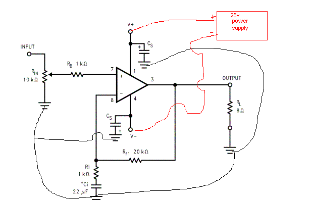

oh? so a 'normal' power supply won't do then?
Guess I'll have to find a circuit and build one of these 'dual-rail' supply thinggies 😕

Two diode Bridges are not needed
Can someone explain why again that the two bridge supply has gained favour in this Chip Amp forum? One will do for either a center-tapped tranny or two non-center-tapped trannies. This fellow needs a simple logical straightforward design and that two bridge design is not.
IIRC, If you use a transformer with 2 secondary windings and a bridge on each secondary, you'll end up with less DC in the transformer which means less heat / better regulation etc etc. Of course, you lose twice as much in diode losses.
I used such a configuration for its versatility: it can be combined into a +/- rail supply, or two independent single-rail supplies. works wonderfully.
the absolute bare minimum requires two resistors: Rfi (20k) and Ri(1K?). Of course, you need the speaker (RL) to make any sound, 🙂.
I have done such a test up successfully. what else you may need depends on a lot of other factors. I would, to be safe, use two small decoupling caps on the power supply rails. In my actual gainclone, I used also two 3300uf caps (one on each rail) as my power supply is pretty skinny in terms of capacitance.

This is not the main reason here. Just read what Rb is in the datasheet, very good described. This resistor is to avoid possible damage at low voltage conditions.theChris said:Rb is to reduce DC offset
MC said:heh, I guess I'll get them all as soon as I can figgure out what Cs is suppose to be
Cs - Supply Capacitance. in general, analog circuits use bypassing capcacitors located close to the IC. most professional circuits at least. Cs is typically an electrolytic capacitor between 1000uF and 10000uF with the preferance being to 1000uF for the gainclones. sometimes a 100nF or 1uF mylar (or some other cap) is used as close to the IC pins as possible. the idea to to improve the high frquency preformance of the capacitor combo.
My testclone is at heart just 2 100nF caps and 2 resistors on the lm1875 ICs with hot glue preventing it from touching the heatsink which is a few mm from the pins on 2 sides... located further away from the ICs is a 4700uF capacitor on each rail (the PSU caps). this gives a little over 1000uF per IC per rail voltage. there is no volume control or power switch... or case...
there is a difference buffer followed by an active crossover before the lm1875s.
there is a bit of DC offset, and the lack of sheilding means the signal wire needs to be further from the transformer. otherwise the amp works fine.
the lack of a volume control or power switch is annoying.
also, you do realize that you need a transformer and full-wave bridge if you plan to run this circuit from AC?
