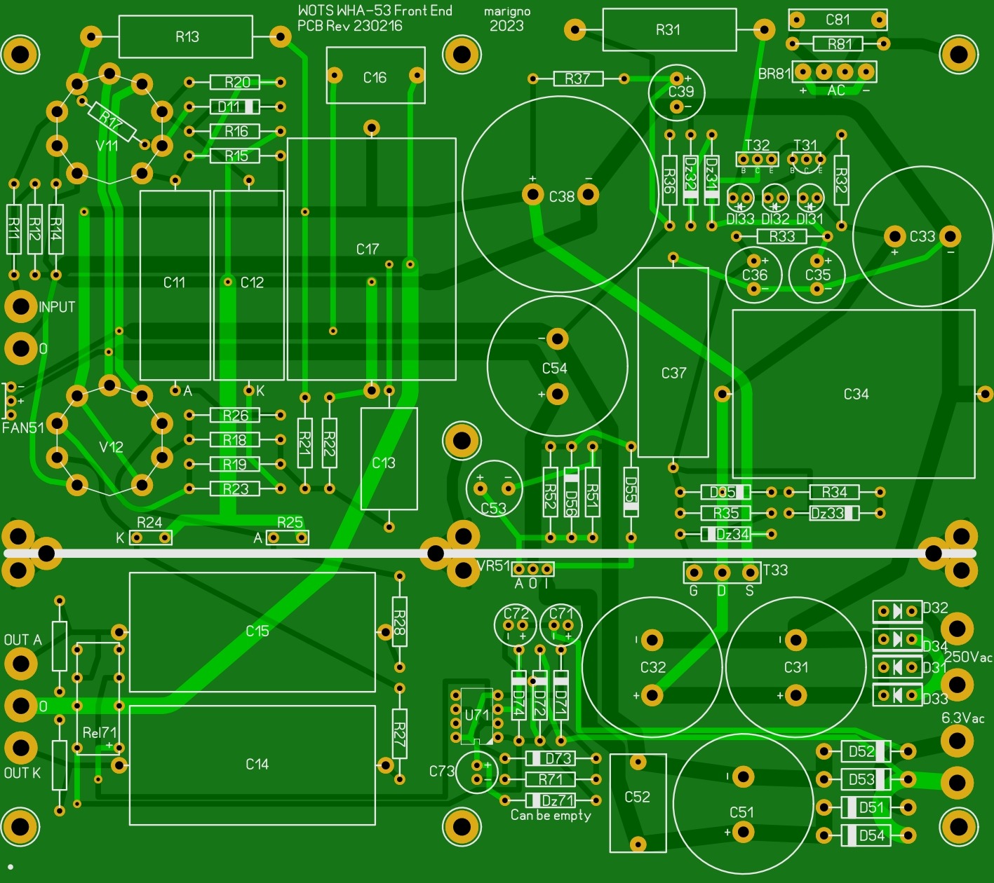

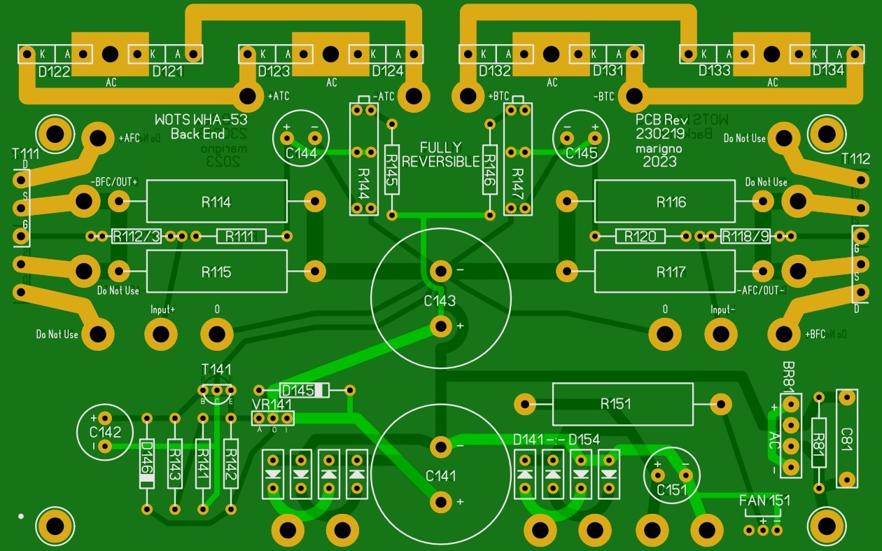

Once it was decided to adopt the Back-End as per the original project, it was a matter of deciding how to make the Front-End (gain stage and phase shifter), consequently making only the necessary modifications to the Back-End, for the part regarding the bias.
We have considered different solutions, focusing on a mu-follower differential, followed by a cathode follower to interface the “Circlotron” Back-End.

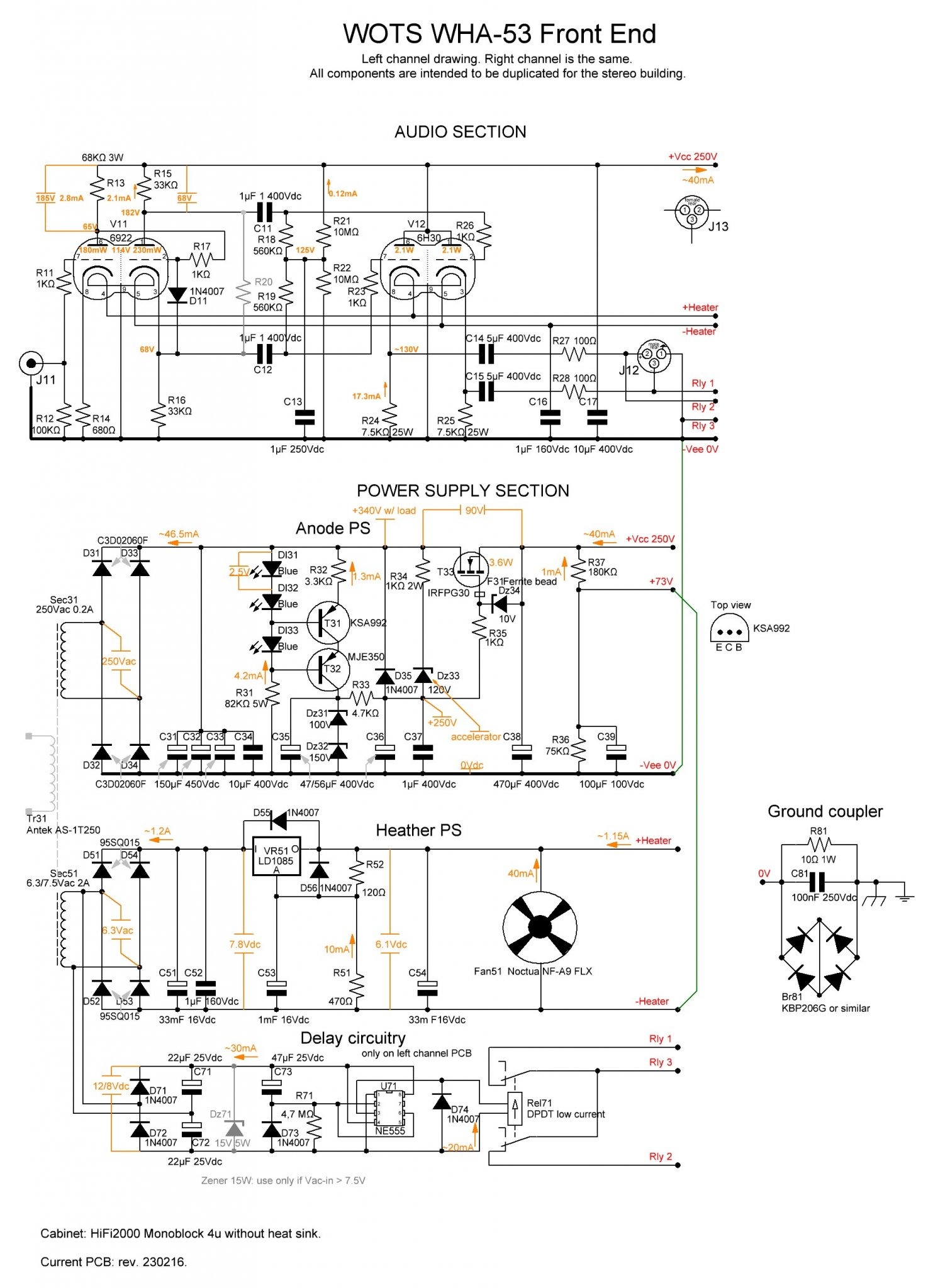

At this point, Stefano was no longer able to follow the project, but I wanted to go ahead anyway, and I started looking for the "best practice" in terms of phase shifters. I discovered that the "Cathodyne", if well configured and well used, is at the top of the list because it is maximally symmetrical; but it has two problems:
The second problem seems to be negligible, as no author cares much about this aspect, so I feel entitled to neglect it too, even though this is the first time I present a project with a reverse polarized filament.
There are several examples of “Cathodyne” on the net, I chose the Williamson input stage, formed by a first amplifier triode coupled directly to the phase shifter grid. This solution, with the values shown in the scheme (ref. www.valvewizard.co.uk/cathodyne.pdf – by Merlin Blencowe) ensures a greater gain than the differential.
In addition, "Cathodyne" has a very intriguing feature, which takes me back in time, when, still a child, I enjoyed making the transistors oscillate, in order to have a transmitter and hear my voice on the home radio. Transistors were made to oscillate by introducing positive feedback created by a capacitor placed between the collector and the emitter. Transposing the concept to the "Cathodyne", a small positive reaction can be dosed very carefully to increase the gain, if necessary, by placing a resistor between the anode and the cathode. I remember that Hiraga posted somewhere a solution in this sense, but I don’t remember any explanation. Reasonably, the operation coincides with what I said. However, here the gain of the Front-End is high enough and doesn’t require any increase.
Furthermore, I am against the use of CCS in the presence or proximity of the audio signal. I only use the CCS, (relying on my memory) in the "Virtual Battery" power supply and in the "Diamond Buffer". So "Cathodyne" is the solution I prefer because it has none.

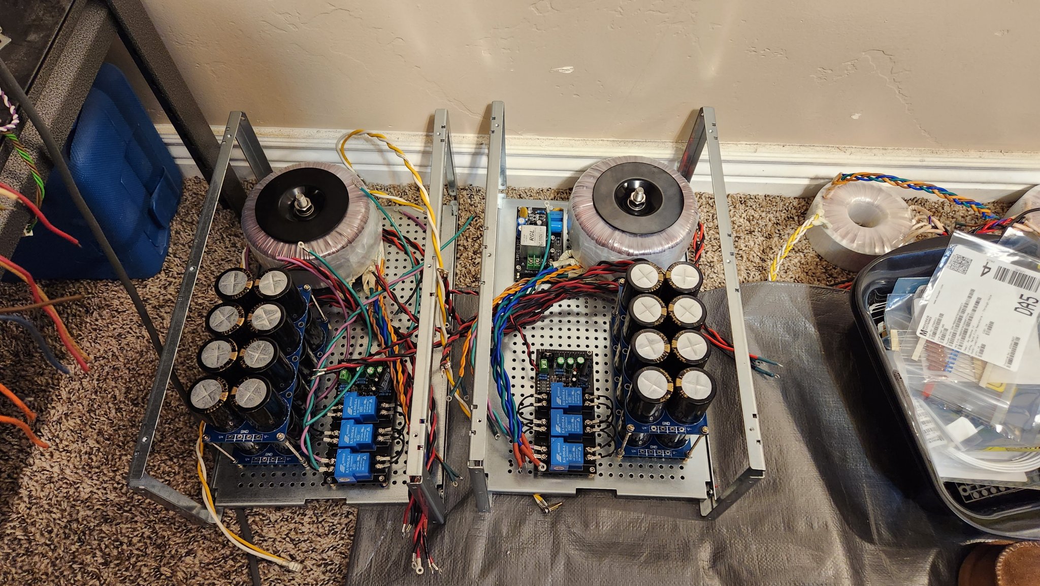

Having established the definitive configuration, taking the dual mono construction for granted, it was a question of identifying a solution to house the physical/functional blocks.
For the Front End:

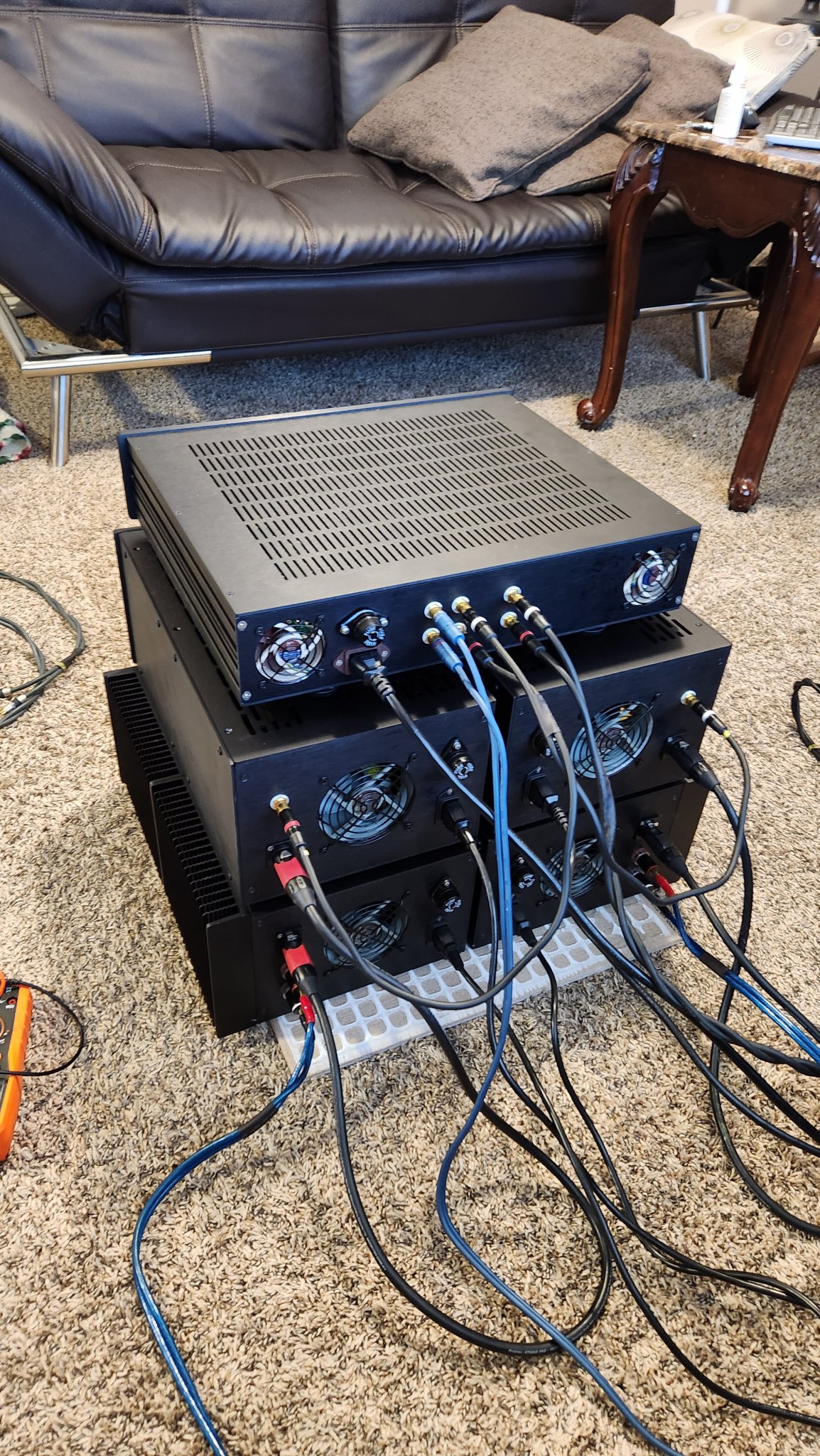

HiFi2000 has in his catalog the Monoblocks, very suitable cabinets for a dual-mono realization. But, in this case, they are small, and it is not possible to fit a complete channel in a single Monoblock. So I chose the dual-mono / dual-body configuration, housing the Front-End in two Monoblocks without a heatsink, and the Back-End in two Monoblocks with a side heatsink. Four cabinets in total.
If the circuitry is a simple one, the mechanical part is a laborious one, the worst moment lies in the realization of the four rectangular holes to house the IEC-C14 sockets.
Calibration.
There are only two calibration points, that concern the absorption of the "Back'End", here is what to do:
- turn on only the power supply relative to the bias and adjust the two trimmers to read 200mV on the 47KOhm resistor connected to the central pin of each trimmer;
- turn off and discharge the bias power supply;
- interpose a 0.1Ohm resistor between the Drains and their positive side of the high current power supply;
- turn on the whole "Back-End" and adjust the trimmers to read 100mV across the 0.1Ohm resistors using two multimeters;
- once the correct absorption value and symmetry have been obtained, move one of the two multimeters to the loudspeaker output and bring the offset to zero by adjusting the trimmers.
