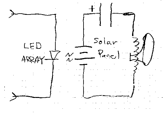

Picture this - put two subwoofer drivers face to face on opposite sides of a baffle. Conect the + of one to the - of the other. Also connect this point to earth. Run the remaing + and - connections to a pair of power transistor emitters, one to each. The collectors go to a positive dc rail. Give the bases a bit of bias but no too much because dc will be flowing in the voice coils. Drive the bases in opposite phase and voila! you have the world's most sorry subwoofer amplifier. Whichever speaker is being driven on it's own half-cycle also drives the other one.

Actually, if the speakers are facing each other, both the negatives should go to earth and the positives go to the emitters. I was initially thinking of when the speakers are facing the same way as in an isobaric system. The whole idea could be better appied to a driver that has two voice coils. This time the voice coil phasing would be as I first said. Seeing each coil would only be driven for half the time the total power input capability would remain about the same I think. The efficiency would be slightly lower though because of slightly poorer magnetic coupling.

So running class AB it would work with perhaps a single DVC driver.....????? ....But any advantages ? Seems the driver resonance would give like ??????
Most woefully tragic excuse for an amplifier
The main advantage from my point of view is that you can use exclusively N-channel fets. Mr and Mrs B. Transistor gave some of their N-channel fet children names like "Arnie" etc, whereas p-channels sometimes have names like "Tinkerbell".

With a DVC driver, maybe you could run each coil in class-A such that the DC currents are flowing in opposite directions through the voice coils, thus cancelling out the DC magnetic flux...
Good idea?
You will have to supply opposite phase signals to each coil so that they operate in unison, and if you want, you could make a single balanced amp to do this - maybe even SuSy? Imagine Aleph-X with current sources replaced by voice coils!

The heat could be a problem for sure. Not a good method for the mass market hifi, but surely within the realms of diy-ism is to drill a little hole through the back of the loudspeaker polepiece plate, that circular piece of metal at the very, very rearmost part of the speaker. Make the hole halfway between the outside circle of the centre polepiece and the inside circle of the ceramic magnet. Attach a tube somehow to this hole and feed air from say a fish aquarium air pump, or maybe from an air compressor with suitable reduction and regulation of pressure. The cooling air should travel along between the centre polepiece and the voice coil. The voice coil dust cap may need to be suitably perforated to let out the air stream. I imagine you should be able to remove quite a bit of heat this way.
