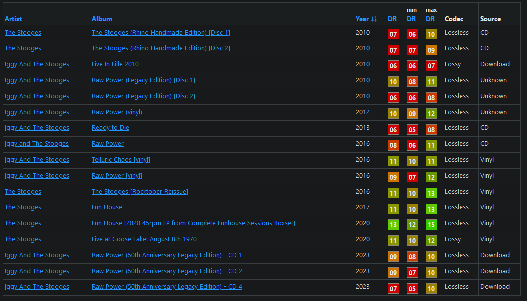

About 10 years ago, I did some analysis of the DR Database data (linked above by Mr. Shurv) and found some interesting trends at that time: "Loudness War" and the Dynamic Range (DR) Database - some observations.
About 7 months later, there appeared a JAES article on the same subject.

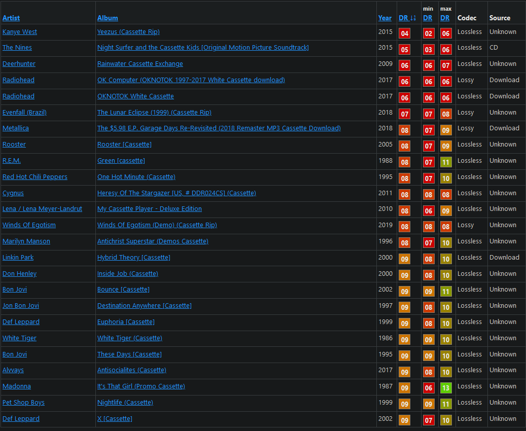

Are you sure?Ironically audio cassettes did not suffer the indignities of over compression and are generally preferable to me to their CD counterparts.
These are more like phonograph DR ratings. Not good...but perhaps not quite as bad as digital discs and downloads.
