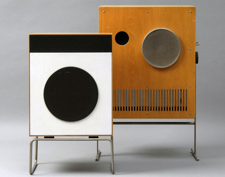

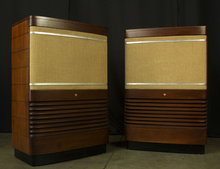

My design reminds me a bit of this :
Georg Neumann GmbH - Professional Monitoring
We called this type of speaker " Abhörschrank ".
Loudspeakers in the 60th where still big and around 100 liters of volume was common.
RCA used that kind of speaker too.
Here you see Lenny Bernstein listening.

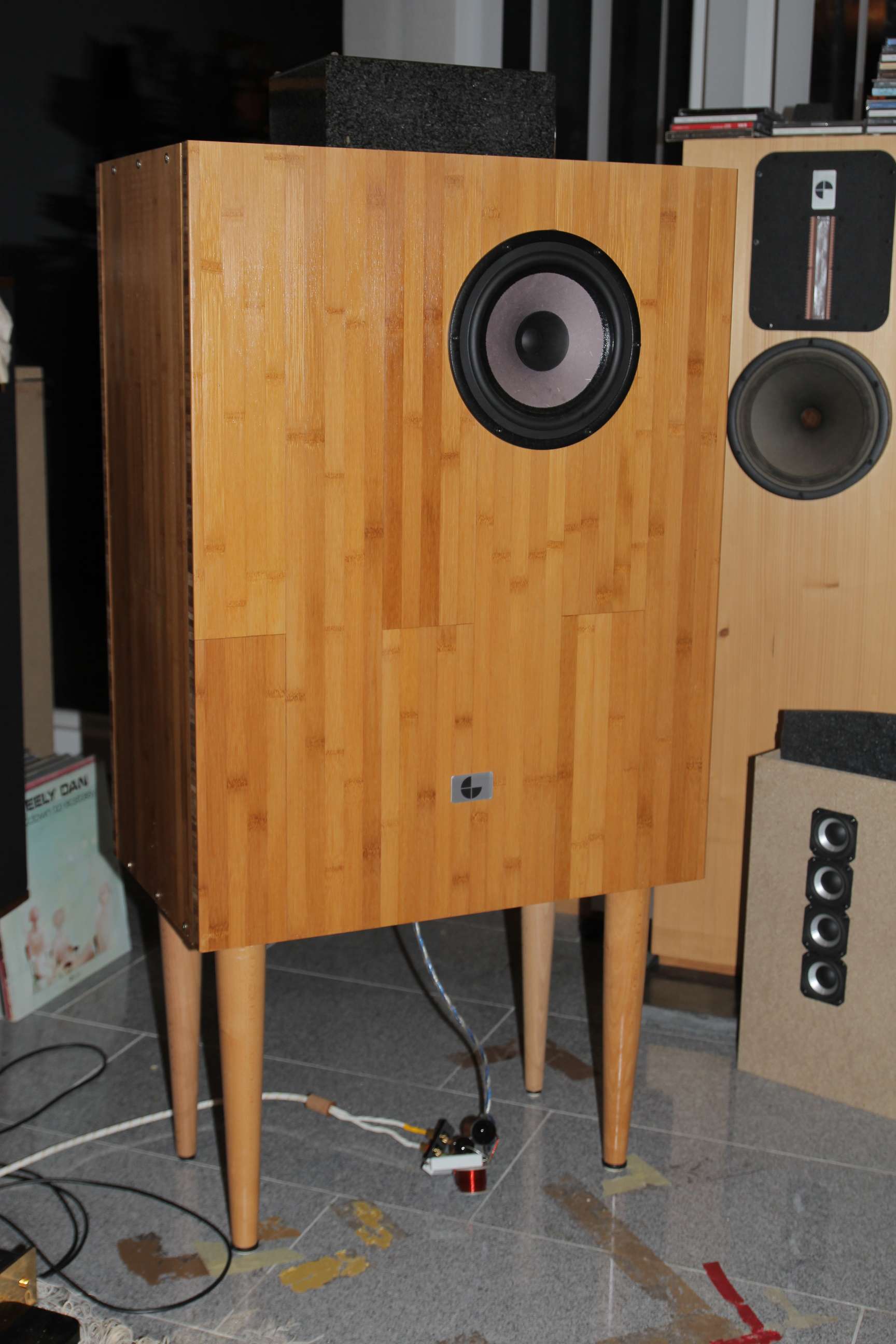

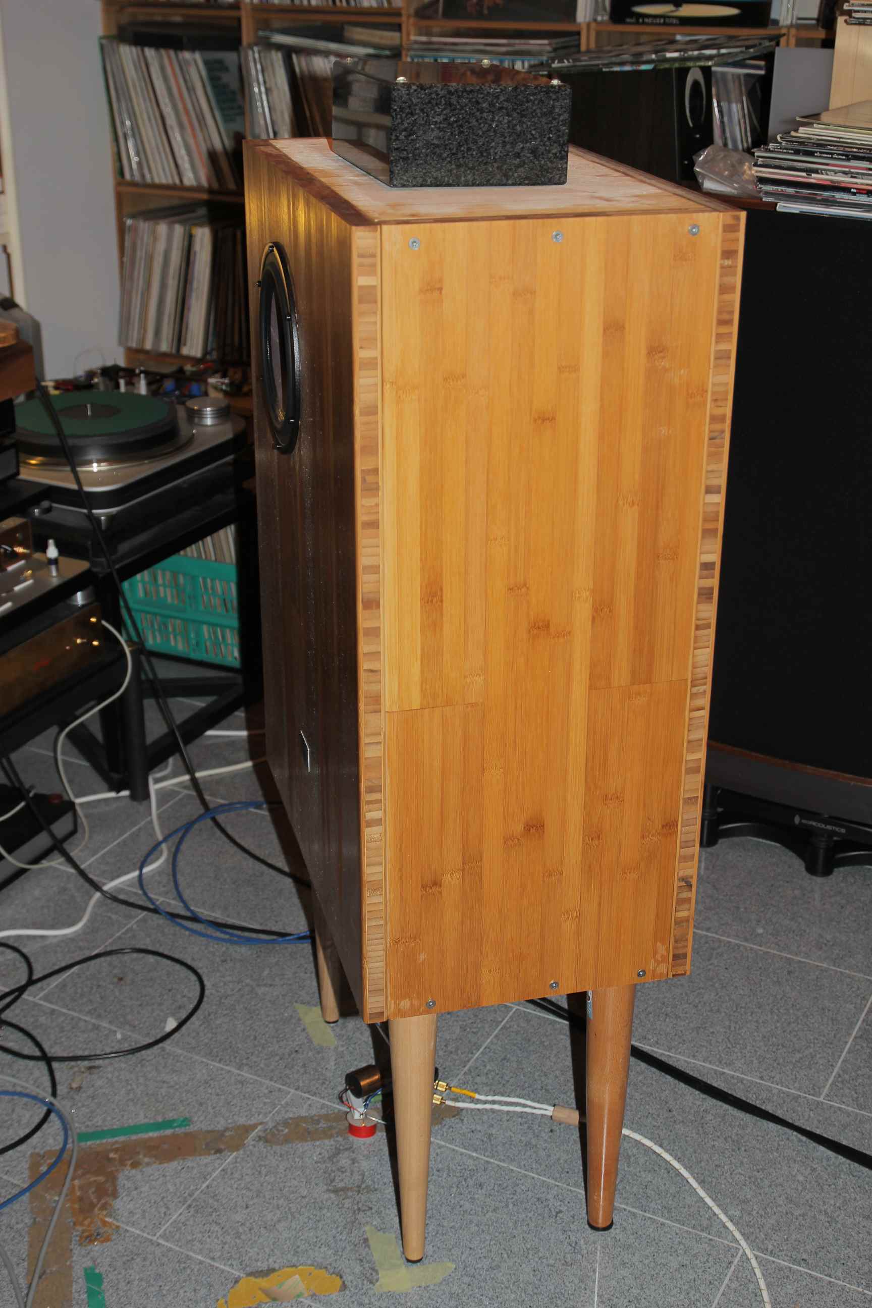

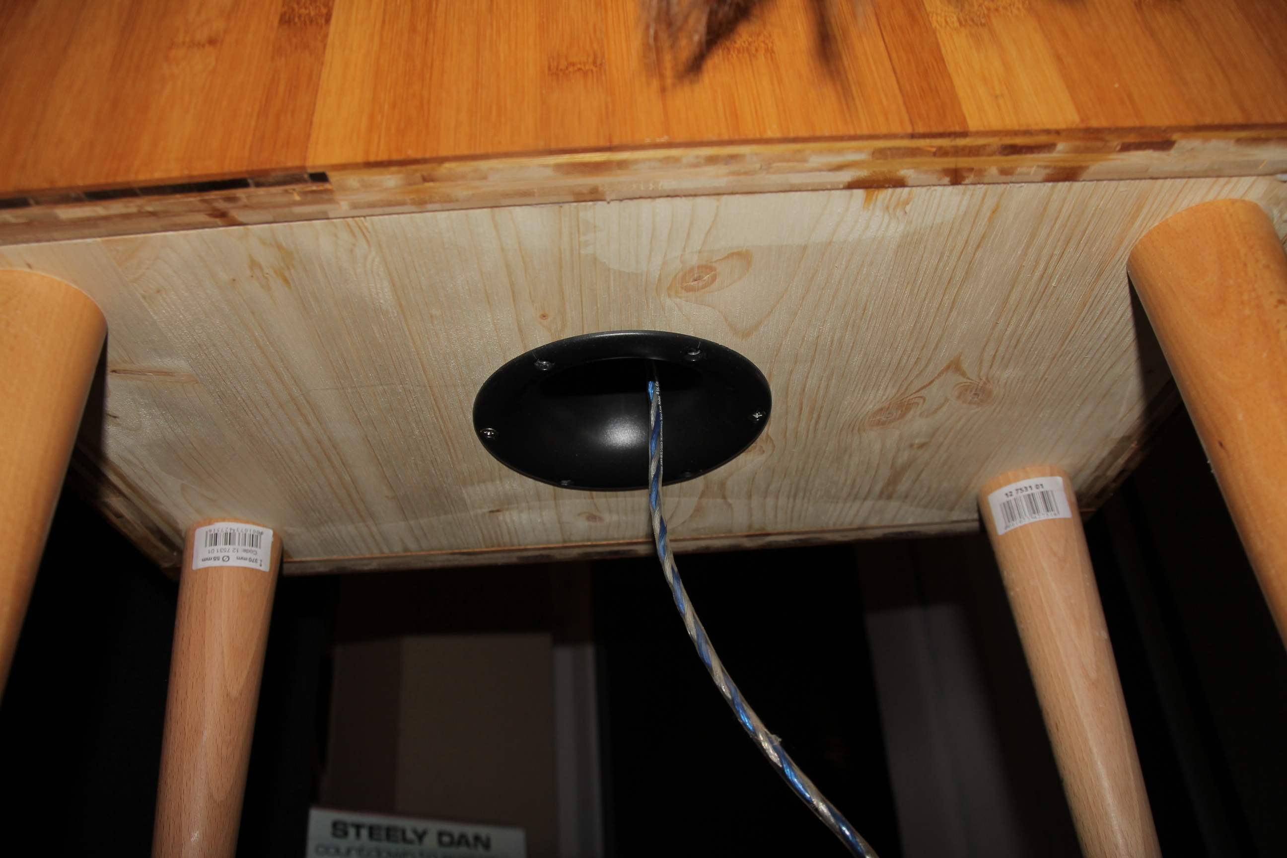

Yes, this is Bamboo ply. Besides Panzerholz it is the best wooden cabinet material that i know of. The Bamboo is around 25mm, so rather substantial and the cabinet is not braced.
I have put damping pads in strategic places though and i experimented a lot with acoustic damping.

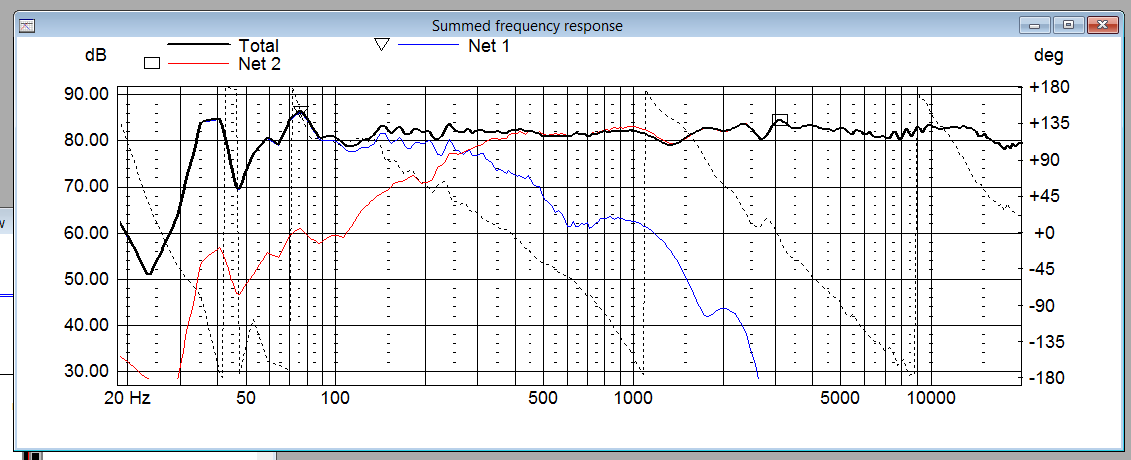

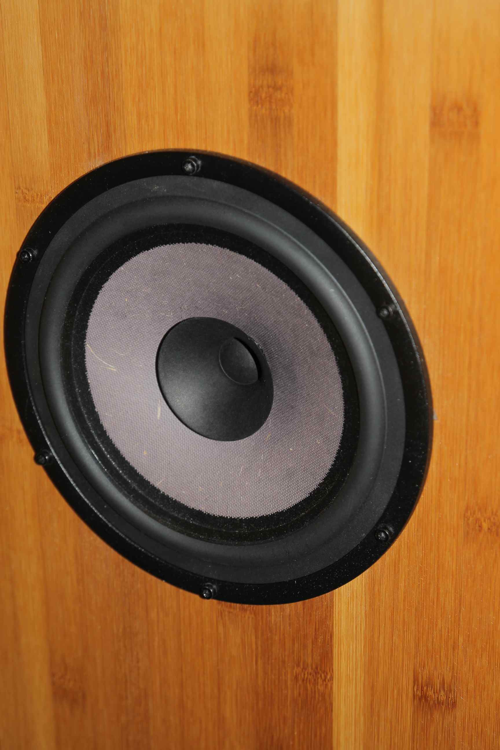

It is a reflex design with a down firing port. This drives has intersting parameters so i could put the reflex resonance at a deep 30Hz. It is abit overdamed though to compensate the room gain a bit.

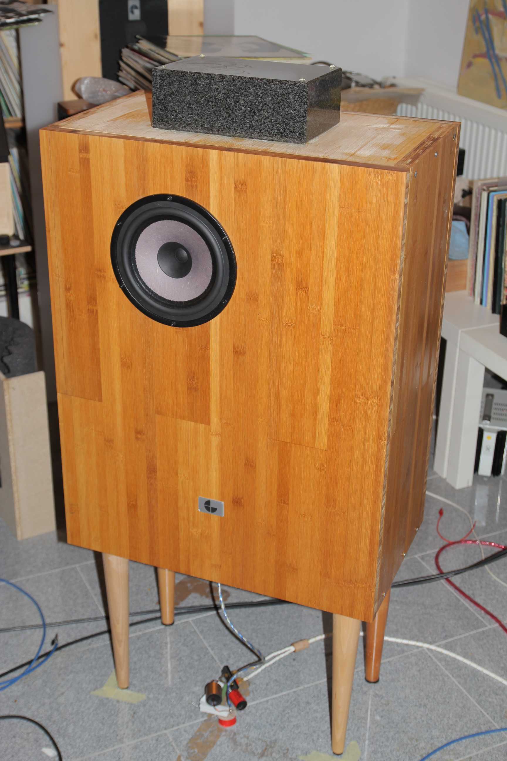

The top and bottom are from 25mm spruce ply. I use this rather soft material in a desire to damp culminating resonances. The finished version will have a granite plate on top instead of the block you see now.

I used this pads in strategic places :
https://www.intertechnik.de/Shop/Zubehoer/Daemmen-und-Daempfen/_WOTUMEX_1768,de,16,154489
I use this for damping :
https://baustoffe.koempf24.de/isove...9dVOo_5ZOxfk&gclid=CNqroOXRjsoCFUHkwgodjb8PNg
I know, some people may be alergic to it and it has a reputation to provoke scratching.
I did not have much problems with this. The material seems to be much improved over older varieties and it works better in this cabinet then other options.
I think it is beacuse it is more dense and has a bigger surface so it also damps in the lower reaches. I really went for maximun natural fundamental tone in this.

Hi ponger !
On the floor are EQ components. Most wideband speakers have a peak in the upper presence region around 3.5 kHz and this components flatten the response.
It is not a crossover as such.
The block is just a granite weight. It will be substituted with a plate.
Nice speakers Dave. That shape also works very well.
