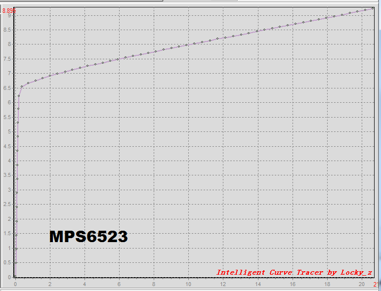

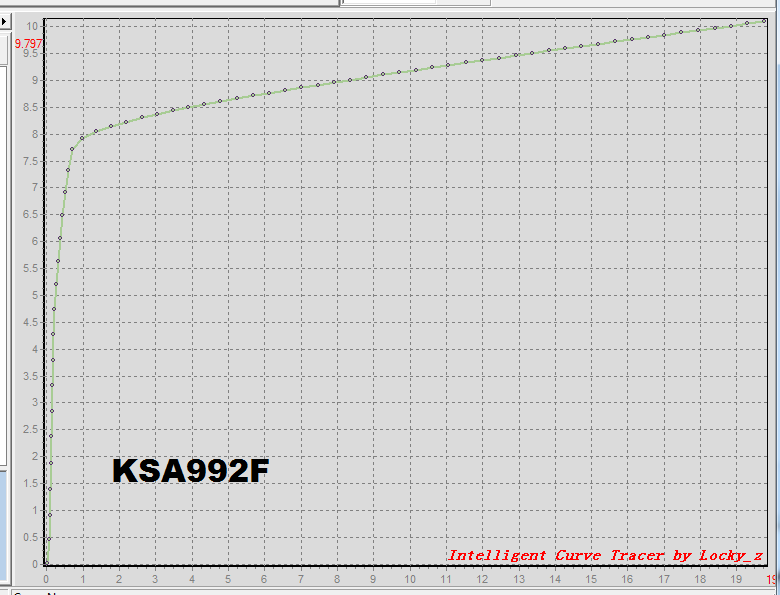

Maybe you could wring a little extra performance out of the first stage by recognizing that the mirror transistors Q3-Q4 never see more than ~ 5 volts of VCE, unlike the source follower transistors Q5-Q21. Allow me to mention the MPS6523 which sells for $0.04 link. It's got higher beta, higher fT, and the same low value of Cob. No quasisaturation at 8mA, whereas the KSA992 just barely starts to quasisaturate. The 6523's Early voltage is about 2/3rds of the 992F's; fortunately your enormous emitter degeneration resistors R7-R8 take care of that quite handily. Datasheet below.

Agreed, I wouldn't actually recommend KSA992 in the current mirror. There are better choices with less quasi-sat.
The real amp is built with 992s, only due to a mistake I made while ordering parts. I was planning to use some spare 2SC6043's which have very low quasi sat (that may have been your data on another thread?)
Well it turns out that the 2SC6043 is NPN and we need PNP here. A minor detail...

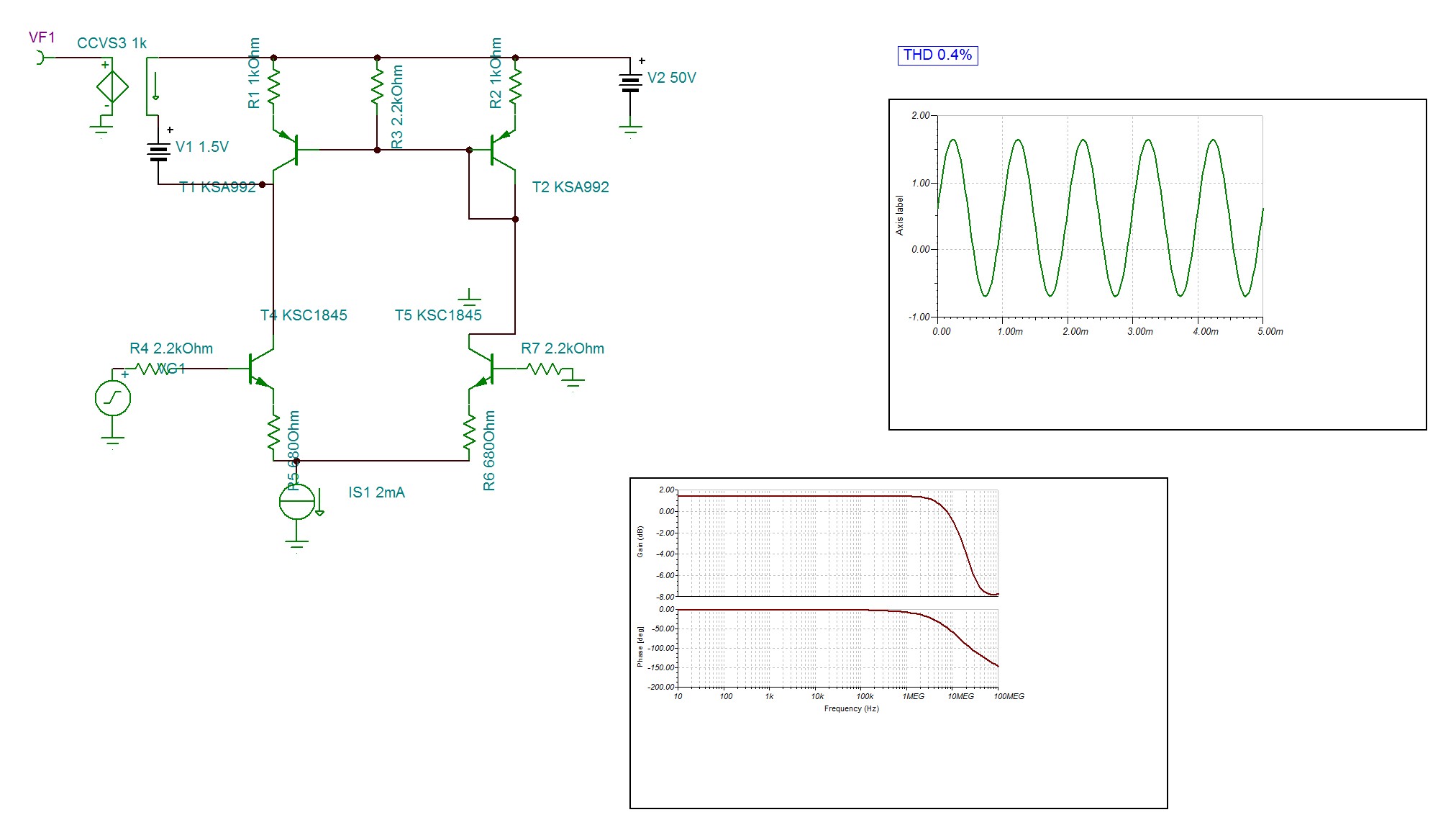

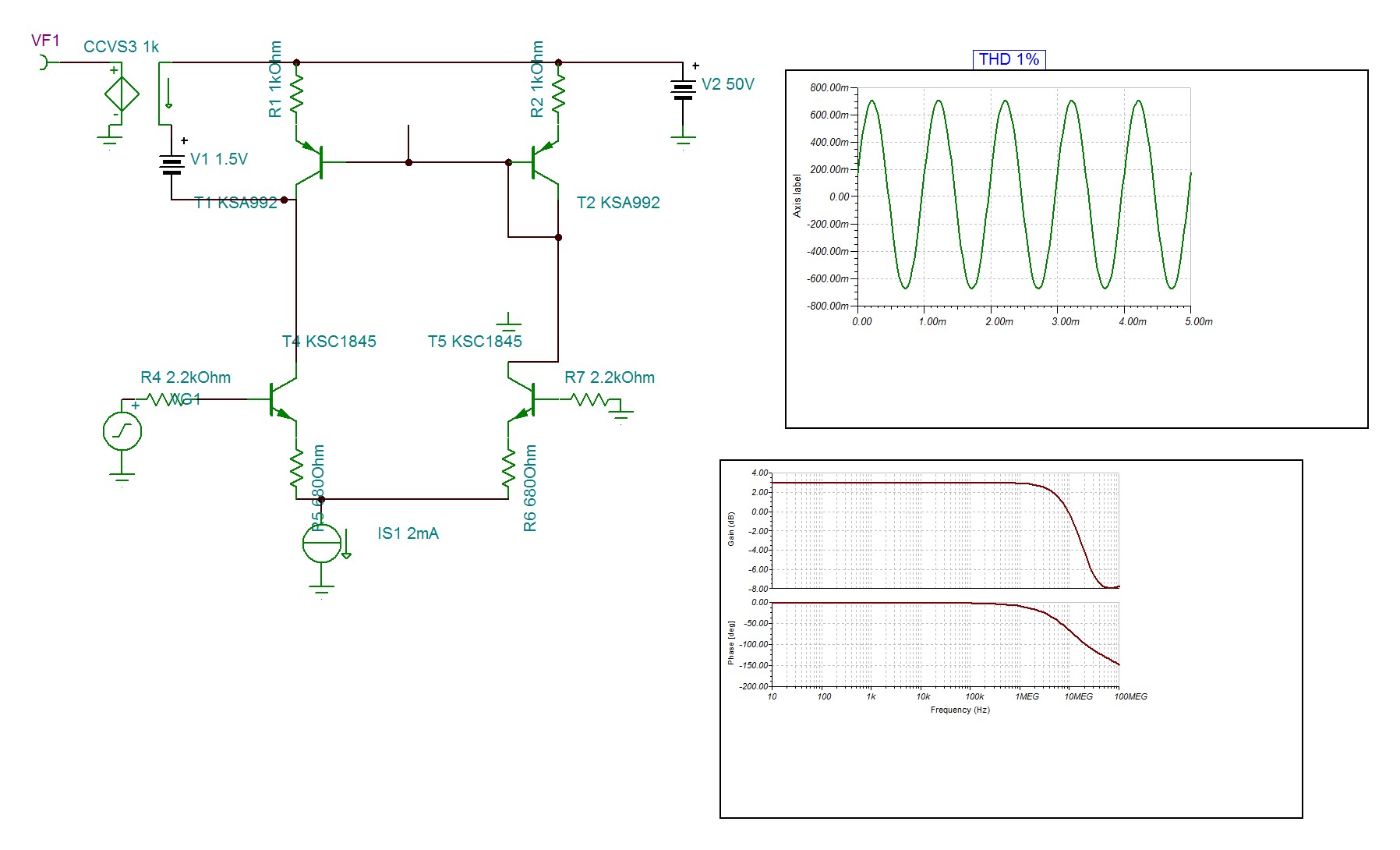

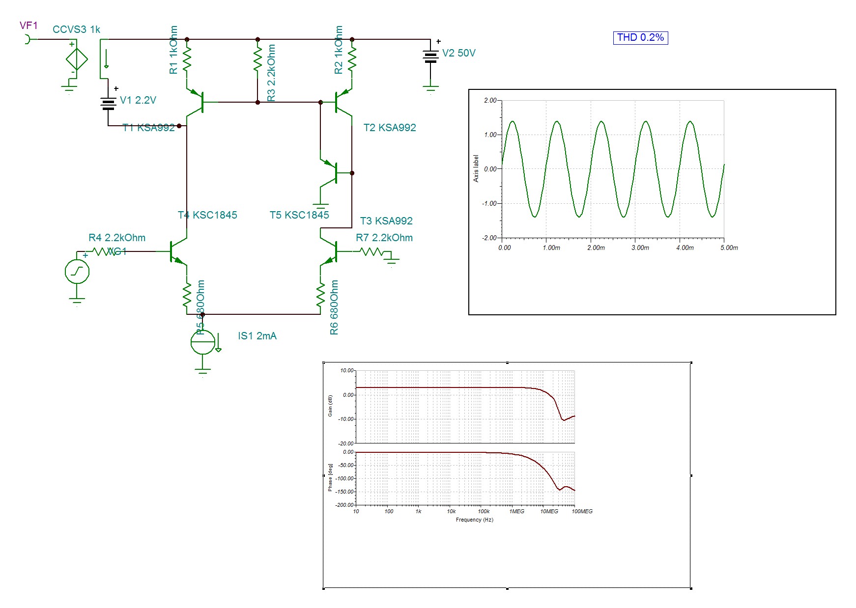

It is worthy to consider the current mirror.
attachment.php
attachment.php
The gain is higher THD is half the frequency response higher.
Without base 2.2k the input is halved to avoid saturation , despite half the output the distortion is double.
attachment.php
