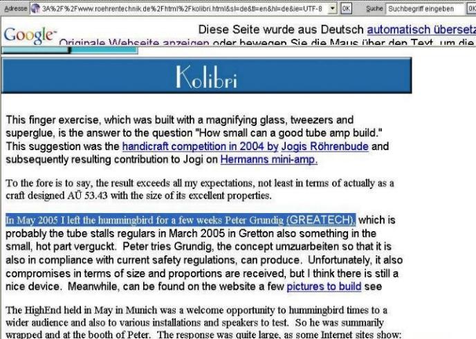

The Kolibri was the prototype for this little beauty I think...
www.greatech.de
www.greatech.de
"hummingbird"
Yes, this is written in the text
(web site translator)
"...In May 2005 I left the hummingbird for a few weeks Peter Grundig (GREATECH),..."
aquapiranha said:The Kolibri was the prototype for this little beauty I think...
http://www.greatech.de/tube_amp_05.jpg
www.greatech.de
