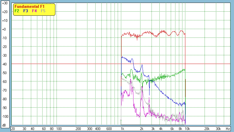

Distortion plot is H3 dominant, which is quite odd (no pun intended 😉). Step-down transformer? Usually ribbons have vanishingly low higher order harmonics above ~5khz, even the little ones.
RAAL 15D-140 90dB/1m:
Here's my Fountek Neo Pro 5i at 90dB/1m (measured with a SET tube amplifier to exclude crossover distortion):
