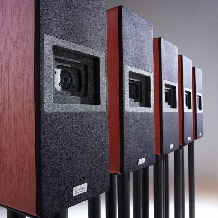

IF I was going to use a driver, it would probably be the 140 - and I'd do the crossover like Joe does for the Elsinore (..at around 3 kHz). And I'd likely do it with the vertical pads widely spaced (..though not removed). Oh, and have a nearly non-existent baffle for it - basically a cylinder shape.
Then you use this technique that Dunlavy started for creating inset into larger baffles (pic. is from Lipinski Speakers; its probably about 40 ppi open-cell foam):
