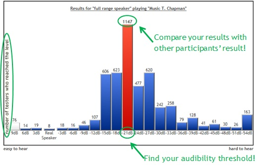

Consult (or refer to) the Statistics. Understand the distribution/spread/variance/range of a sample space or dataset. Look at the attached data (from klippel distortion test) as an example. What can be learned/concluded from this graph?
(1) People have different hearing/listening skill.
There are "outliers", those who perform so badly and those who perform so well (we can call them the 10th percentile and the 90th percentile). Observe the number of the "top outliers". Actually, this test is limited to a maximum of |-54dB| hearing skill, which is too low to show the actual skill of the top outliers.
In term of IQ score, I'm above the 99th percentile. I believe that my hearing skill is also in this percentile (this is outside of the Klippel test data range or scope). There might be a few of you who are interested in this: listening skill has more to do with brain than with ear.
Question to BurntCoil (rhetorical): What is the 99th percentile of 12 people?
The above is a simple fact, not so important imho. The more important question is: What is the relationship between a human ABX listening score with how far the exact same human can be affected by the distortion/sound? My hypothesis has been: Even if a human cannot pass an ABX test, it doesn't mean that they are not affected. This is because human ABX skill is TOO low compared to what their brain can actually do.
For me, the above hypothesis is easy to prove by logic (not by experiment), taking my own experience as an analogy: Let's say I can hear and is thus affected by -54dB distortion. Assume last year I can't past -12dB distortion test (the main point here is that this is a learned process which requires time). Can I assume that last year I'm not affected by -54dB??
Here is my opinion (or better call it my hypothesis): Researchers were wrong thinking that human is not affected by THD below 0.1% just because they couldn't pass the test. The real distortion that can affect human is far below that number!

No, that's none of my points. Look again at the Klippel distortion test. -54dB is the "limit" there. What do you think is the distortion of the drivers in Jon's test? You can safely use the Klippel test result (tho it is mistakenly conducted imo) to predict the result of Jon's test.

Difference in SPL level is the main determinant in DUT differentiation in an ABX. If FR is "flattened" then we can assume that there is no difference in SPL level (actually it is not perfect, there is always variance)...
So in Jon's test we must rely on other measures to differentiate sound, other than the SPL level. It is either the micro SPL level difference, or other measures such as the distortion...
The Klippel test shows -54dB as the limit (not a threshold). -54dB is equivalent to around 0.2% distortion... Please note that this is distortion at amplifier level, not at speaker level...
Good drivers have distortion below 0.4%. This is -48dB. If we assume that this has direct relationship with amplifier distortion, then we can predict that there are people who can differentiate it, but the number is so low (I don't want to bother using the klippel test data to calculate how many fraction of human it will be).
YES, it is difficult to differentiate, but not impossible. Do you want me to calculate statistically (based on the Klippel test result) how many respondents Jon needs to gather to get the positive result? (I hope not 😀)
My ears are good. Trust me, everything is in the measurement (People just don't agree on the threshold numbers). Like I said before, for me, measurements of these drivers tell much more than the test result.
