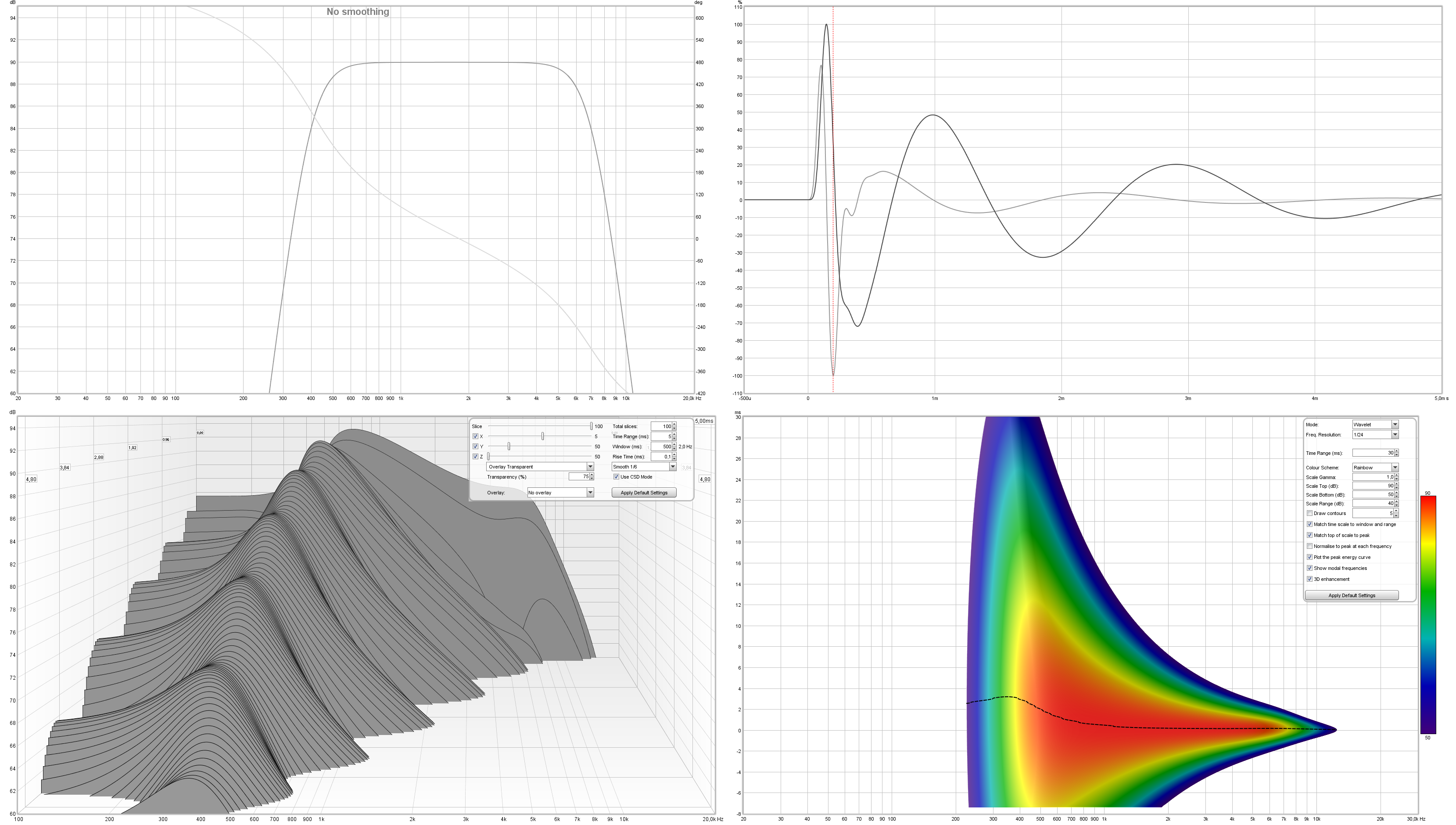

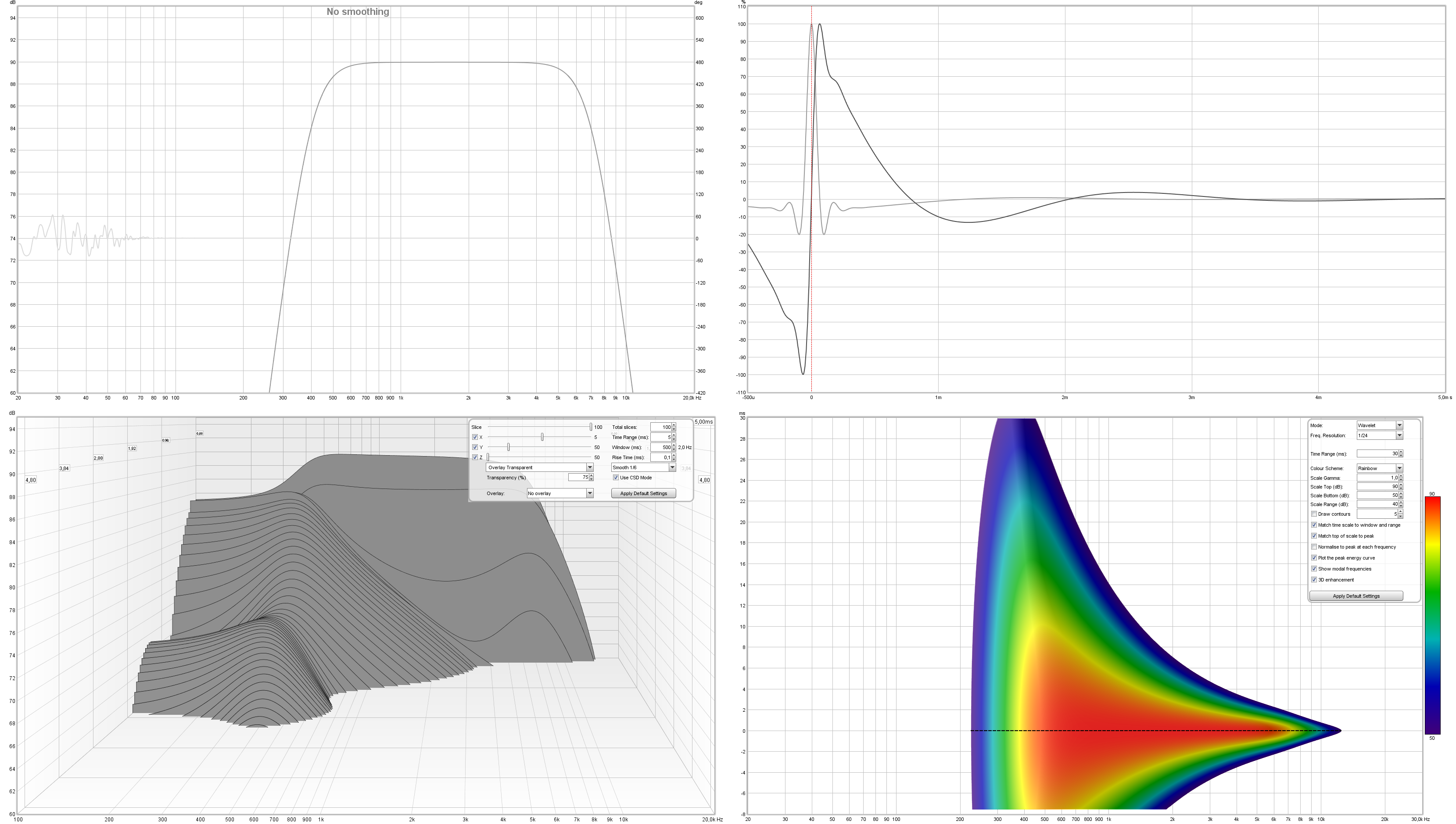

Because you announced steep stopband filter slopes and probably have plenty power full DSP engine consider some small test FIR verse IRR steep stopband filter slopes. Below two examples is IRR and then FIR domain of 0,5kHz-7kHz 8th order LR band-pass, and because those steep filters relative high time lag into IRR domain gives long decay tails in waterfall suggest such listening test IRR verse FIR if you happen run up in 8th order slope class, if you happen filter out with 4th order slopes or lower then forget above thoughts : )
