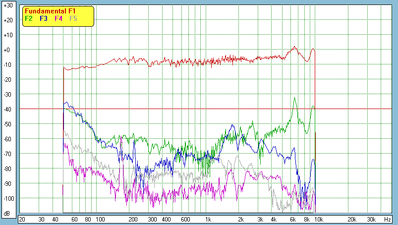

The TI 100 from Visaton is not a driver that works well without a low crossover, like 1800Hz 4th order acoustic. It has a really nasty rise in distortion due to cone resonance amplification.

When the term "2nd order distortion" is mentioned in audio circles it typically means the first harmonic to a fundamental. A 100Hz tone will be 100Hz and a bit of 200Hz when passed thru a system with asymmetric nonlinearities.
Nonlinearities will always give harmonic and inharmonic (ie IMD) with broad spectrum signals. So, 2nd order distortion does not equal IMD.
I could have worded that more carefully. Perfectly symmetrical distortion may not necessarily generate significant IM, but any asymmetry will. Either case generates harmonic D. The even harmonics and I.M. distortion are a function of asymmetry. Creating a circuit that only produces the 2nd harmonic is next to impossible, although arguably desirable. The 2nd harmonic is one octave higher than the fundamental, which is called the 1st harmonic in engineering circles.

The unit, unfiltered, IIRC (was looking at response curves right on Franks measurement set up), measures about 104db in the region were the broadband filter is needed. It is, as usual, mostly a on axis issue. 4 gram cone, IIRC. See solen for images and numbers. It really is a 'true' 100db efficency.

This driver has stellar performance if used within its optimum frequency band but it certainly is not suitable for use up to 7kHz.
If you can't use a midrange driver up to at least 7kHZ, then you can't keep crossover points outside of the F range where the ear is most sensitive (800HZ - 6kHZ), and the range where virtually all effective stereo imaging is done (since interaural crosstalk will confuse imaging below about 800HZ).
