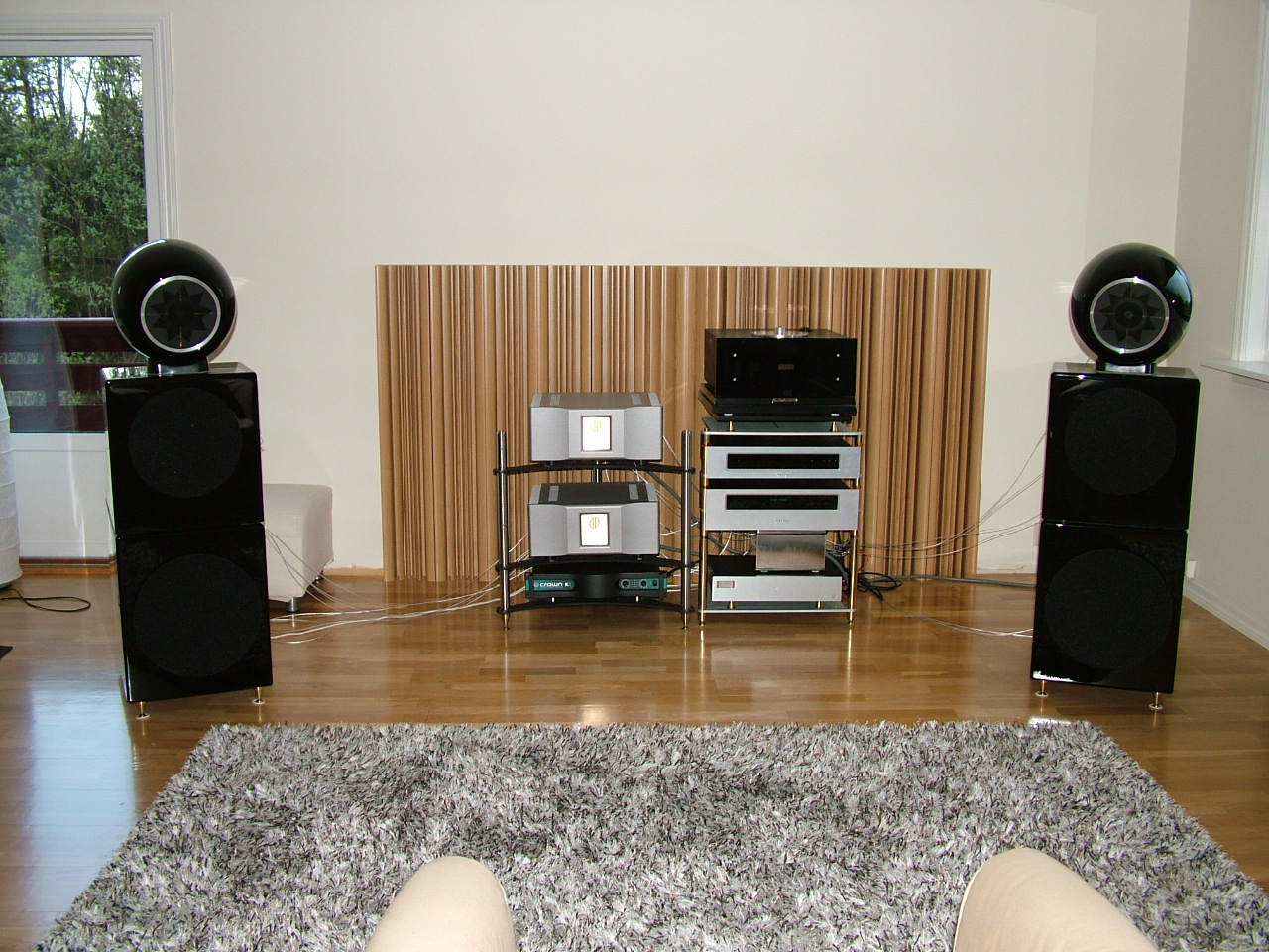

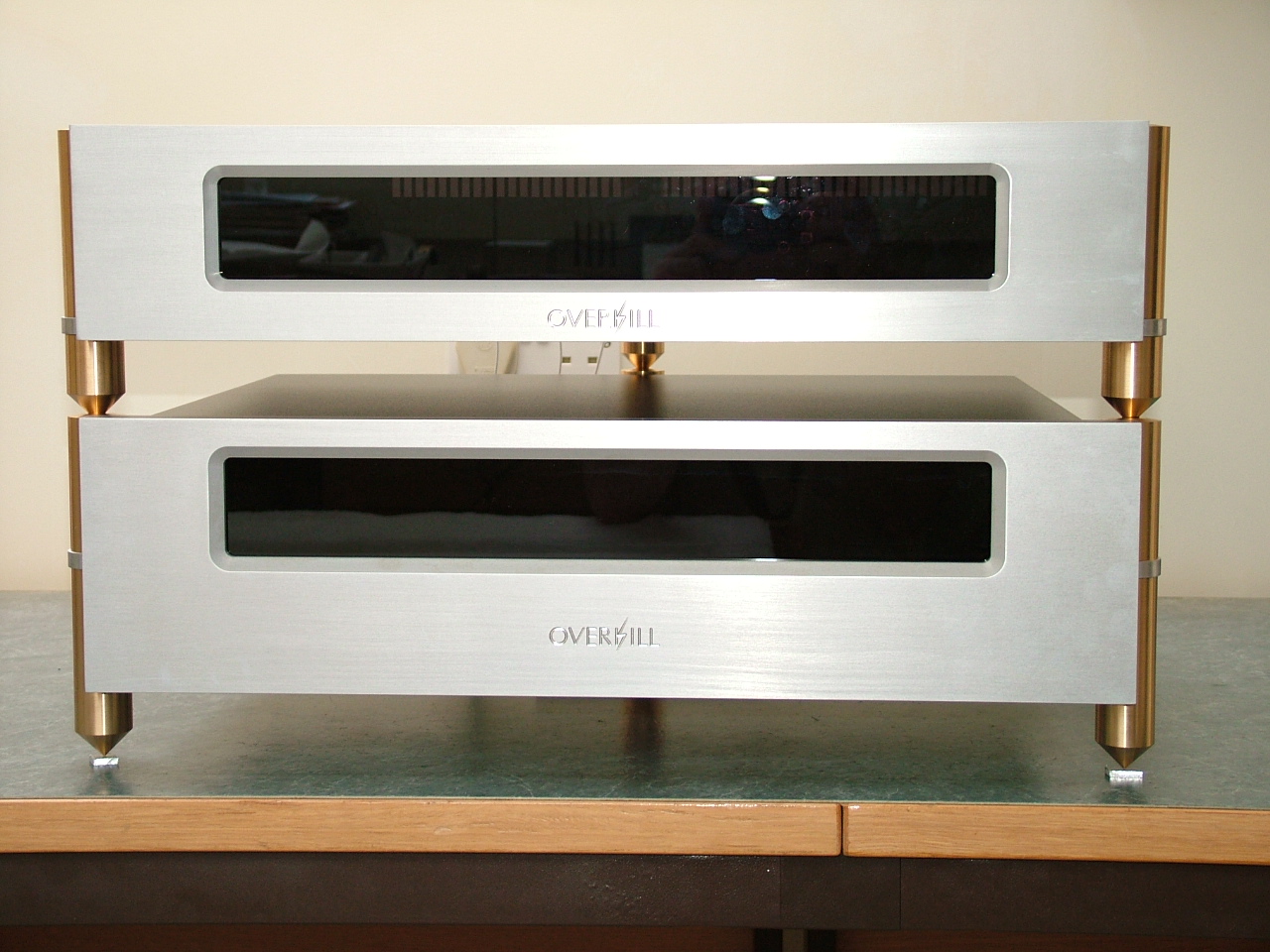

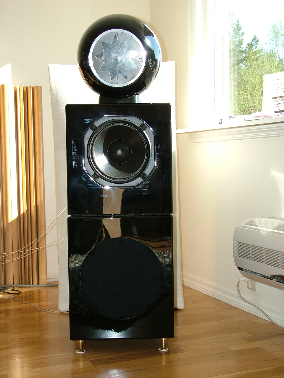

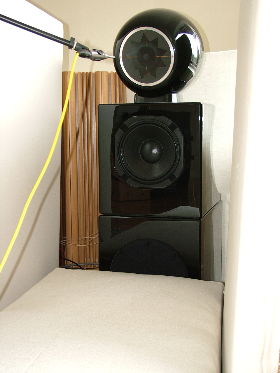

I love the DEQX....I used one of the first DEQX units back in 2004 / 5 at the CES show in Vegas....Won a best newcomer that year and joint best in show the next year....Checkout this old review.... 6moons audio reviews: Overkill Audio Encore Speaker System
I ended up taking the DEQX to crazy highs...See pics....Separate enclosures for the DSP boards and our own mega power supplies, then battery power supplies, external DAC's with autoformer volume control, resonance control, RFI / EMI blocking, Sistrum stands.....OMG looking back I really was an addict!
But the core DEQX DSP is still a great choice, just use the digital in / out and use your own DAC's.
I used the Manger driver (another great candidate for your wide band mids?) from around 300Hz 400Hz up, its a lovely sound, but for the last 4 or 5 years have been developing the BMR into something even better....
I have never heard the Seas F8 or the Voxativ AC 2.8.....But I am familiar with various Raal ribbons, OEM and DIY.....My advice would be have a listen to the Stage Accompany....!
All the best
Derek.

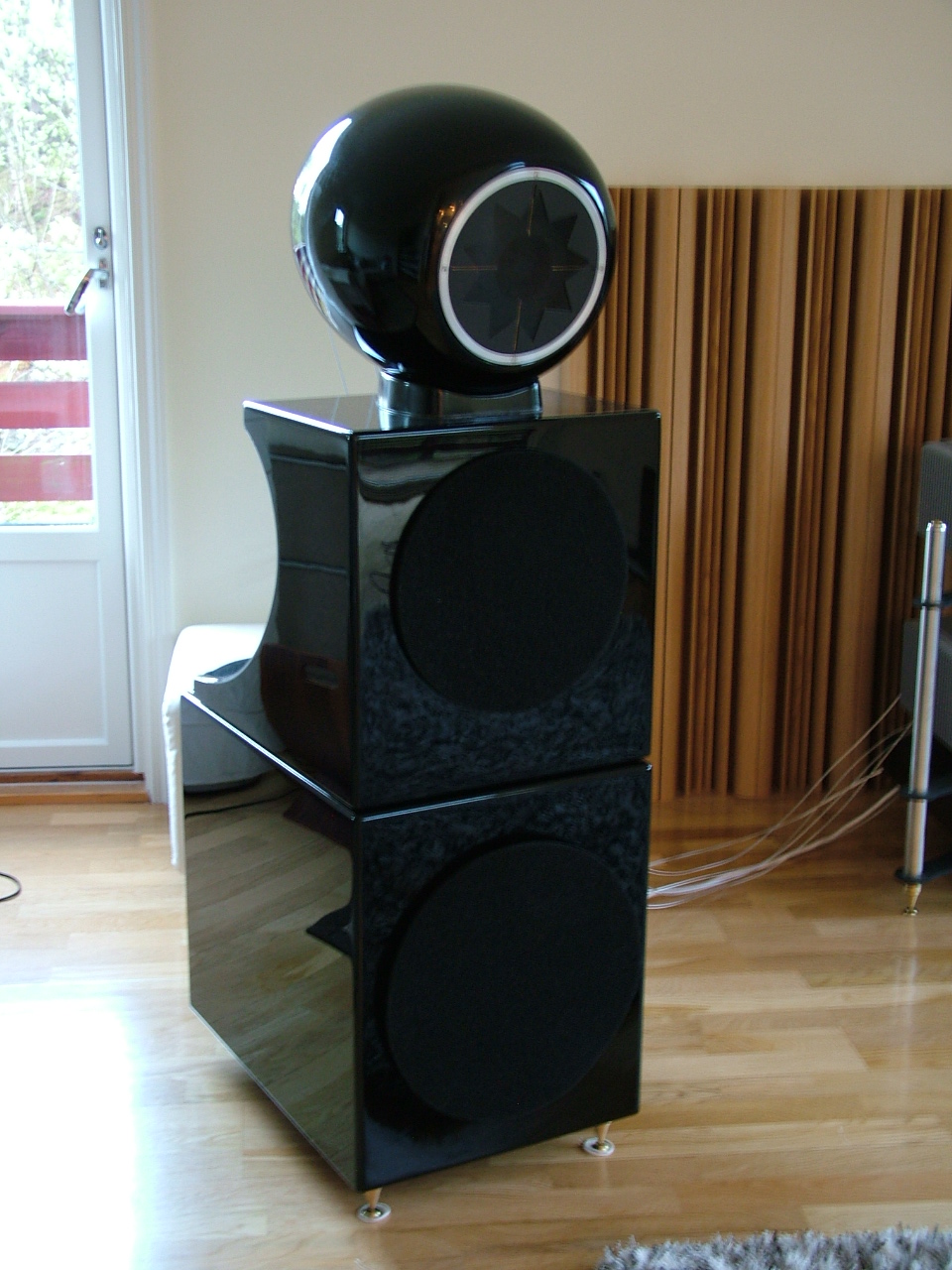

Funny you mention the Volt BM2500.4....
I'm using that one for almost 10 years now:
Volt Loudspeakers | BM2500.4 (10″)
I'm not afraid to say that this might be the weakest part of my speakers now. Partly because i don't have a real 4-way active set-up (DEQX = 3-way) and also because that driver lacks of the details/dynamics level my mid and tweeter offers. On the other hand, it's very far from being unsatisfactory...

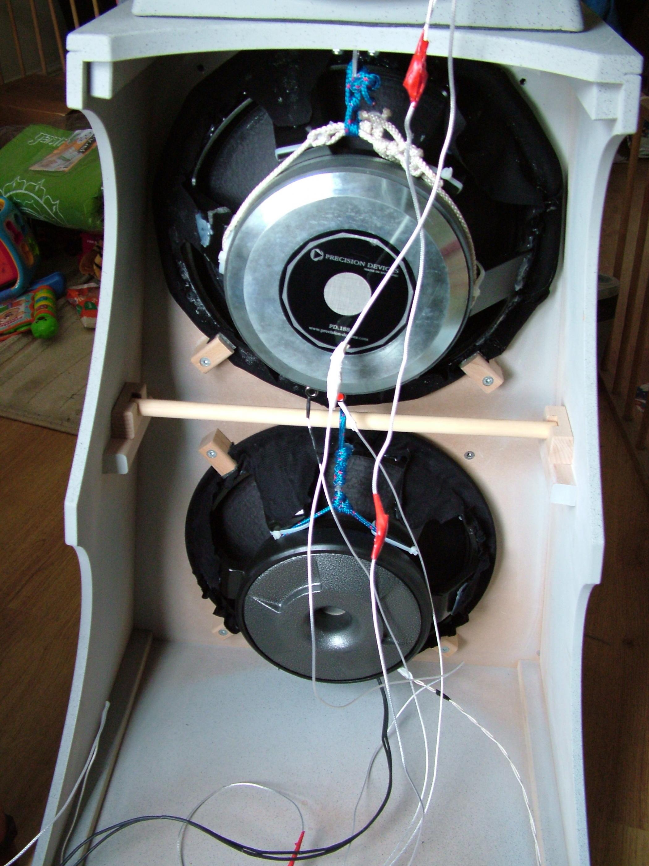

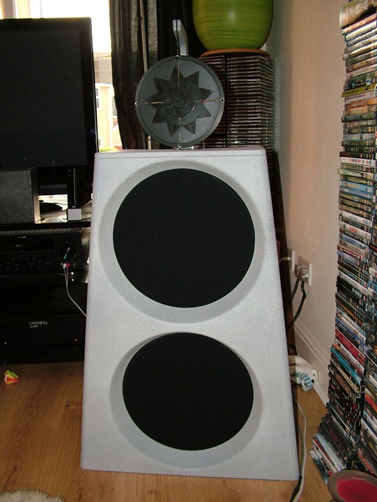

The volt BM 2500.4 was what I used for 7 years....Until the Beyma was released!
Here is the volt BM2500.4 in a very special VPL open baffle....This massively improves the performance over a flat baffle.
If you have your Volt in a ported box you are in for a very pleasant shock when you hear the same driver in a correctly designed sealed box and DEQX'd.
Now if you have the room ( 6 feet clear air behind the cabinet) you can use the VPL open baffle....That will elevate the Volt to another level again.
The Beyma is even better than the Volt......!
Yes i also tried the Manger driver 🙂
That is another beast completely. A very unique sonic signature, extremely smooth but detailed at the same time. Almost weird.
We should include that one in the big boys semi-finals of this thread's test!
FR cone v.s. ATC dome v.s. Compression driver v.s. Manger driver technology... how this can't not be interesting !

I took the open baffle concept as far as I could, including suspending drivers with poly prop cord so the did not touch the cabinets.....
In an open baffle set up its easily better than the Beyma and just kills the Volt BM255.4.
The PD has the perfect Mms to Bl for a 15 inch driver, 0.24 Qts / 0.25 Qe and a fantastic Qms of 14.91!
Ultra low power compression, genuine life like dynamics (its used in stage monitors for drum kits!) and yet it has the texture and detail to melt your heart with solo Cello / string bass / vocals.....
In a VPL open baffle with the Manger above and a Beyma or PD 1550 or 1850 below it remains my reference for any free standing loudspeaker system at any price.

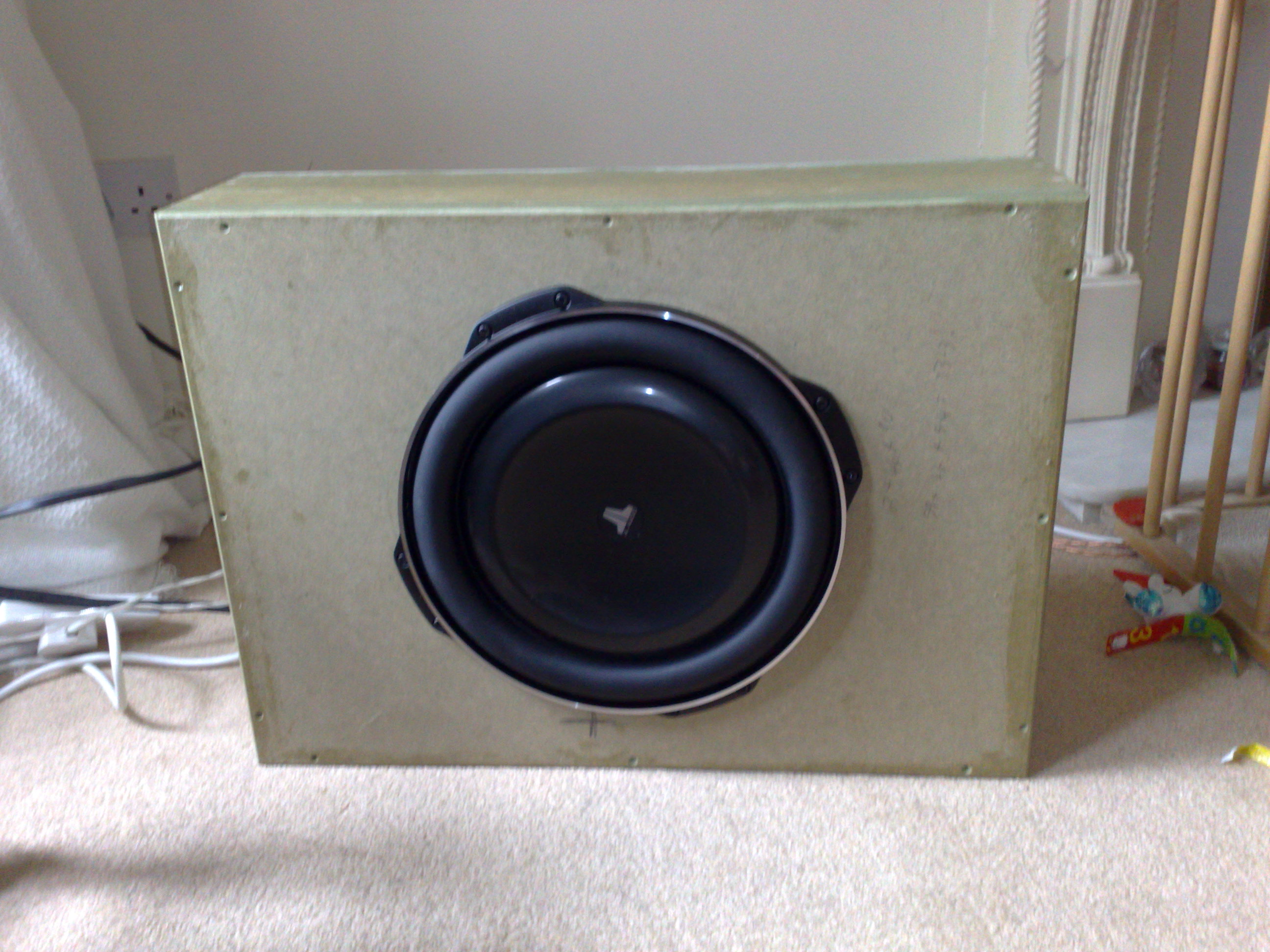

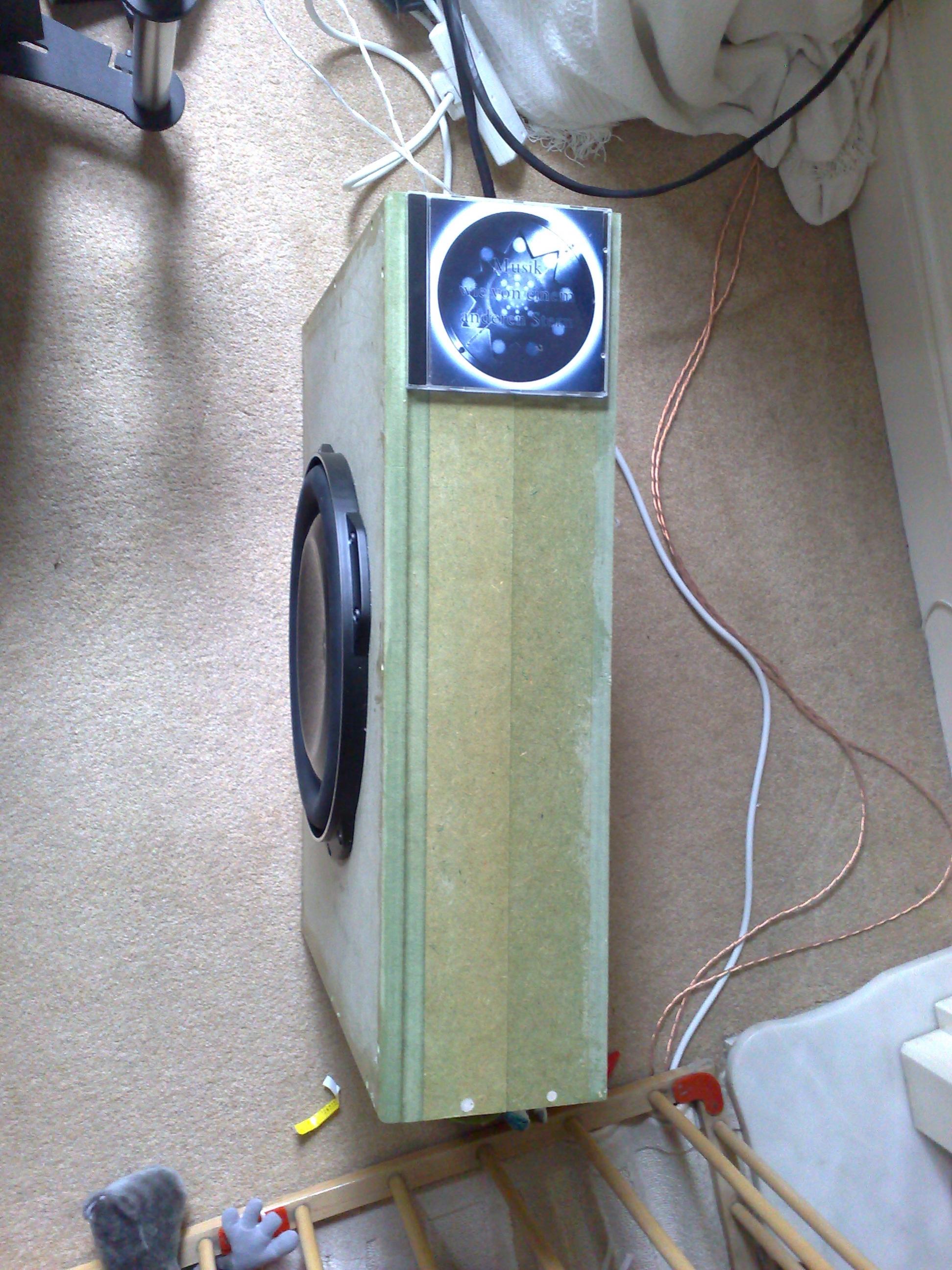

Back in 2010 I tested several JL Audio subwoofers and sold a few to some local " sound off" automotive competition guys.
They went deep and loud but in no way can you compare their performance on music material to any of the top Pro Sound drivers.
I did find one interesting JL driver that is useful for on wall or in wall home cinema installs, the attached pics show how slim it is....The cabinet was only the depth of a CD.
It's good for LF effects in small rooms but again its a long way short on musical performance.
