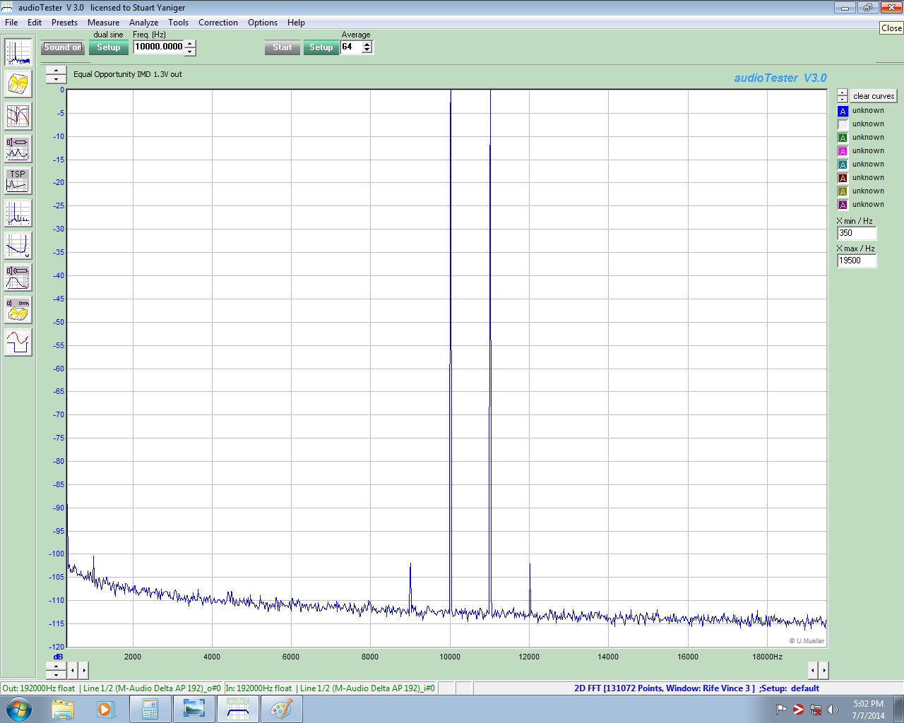

And all this handwringing about hash would show up in a second on an two-tone IM test. Actually, just a single tone should work, no? I mean these spurious signals are what we'd expect to IM...
Huh, who'd have figured?
