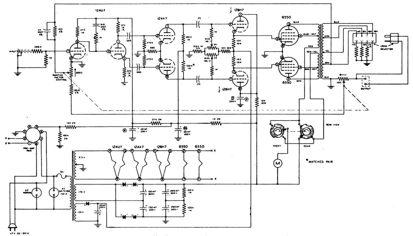

I've a funny feeling that the valve amps wouldn't have the required drive for the B&W's
While nominally 8 Ω, the impedance dips as low as 3 Ω. You have to connect the 803s to 4 Ω speaker taps and derate the claimed sensitivity to 87 dB. Build something using Williamson style circuitry and KT88 "finals". Something along the lines of the Heath W6M (schematic uploaded) would do, nicely. However, please steer clear of the non-linear 12AU7/ECC82.
If you have time, peruse this AA thread, where the W6M was "dissected".

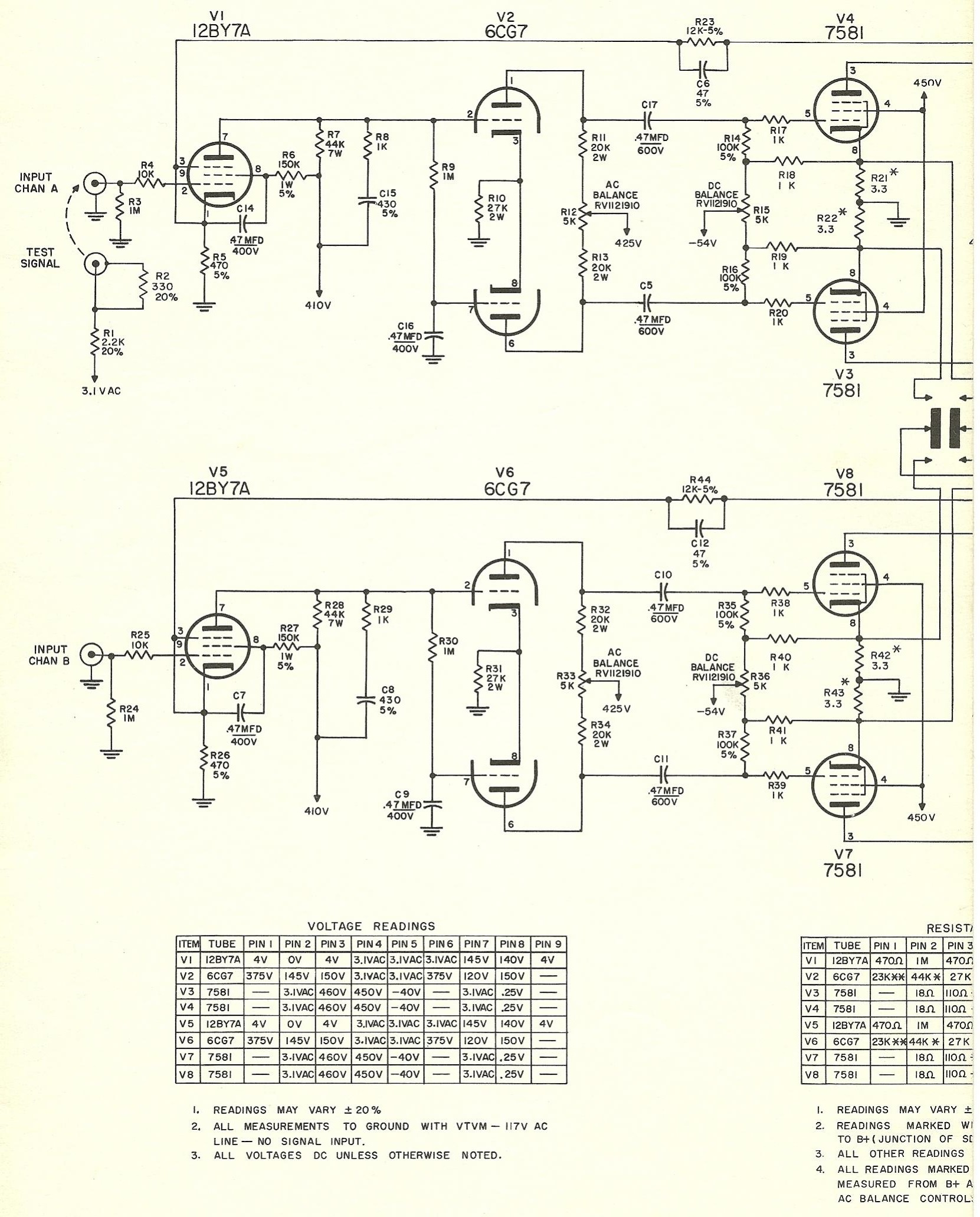

Mullard style circuitry is somewhat simpler than Williamson style.
"Steal" the small signal circuitry from a H/K Cit. 5, using a 6CL6 as the voltage amplifier. Use a 10M45S CCS to load the LTP's tail, instead of a resistor.
Graft the 12BH7/KT88 Class "AB2" O/P setup, from the W6M, onto the split phases. Yes, the Class "AB2" setup is more complicated than a "routine" PP pair. However, you gain increased power O/P and immunity to blocking distortion.
