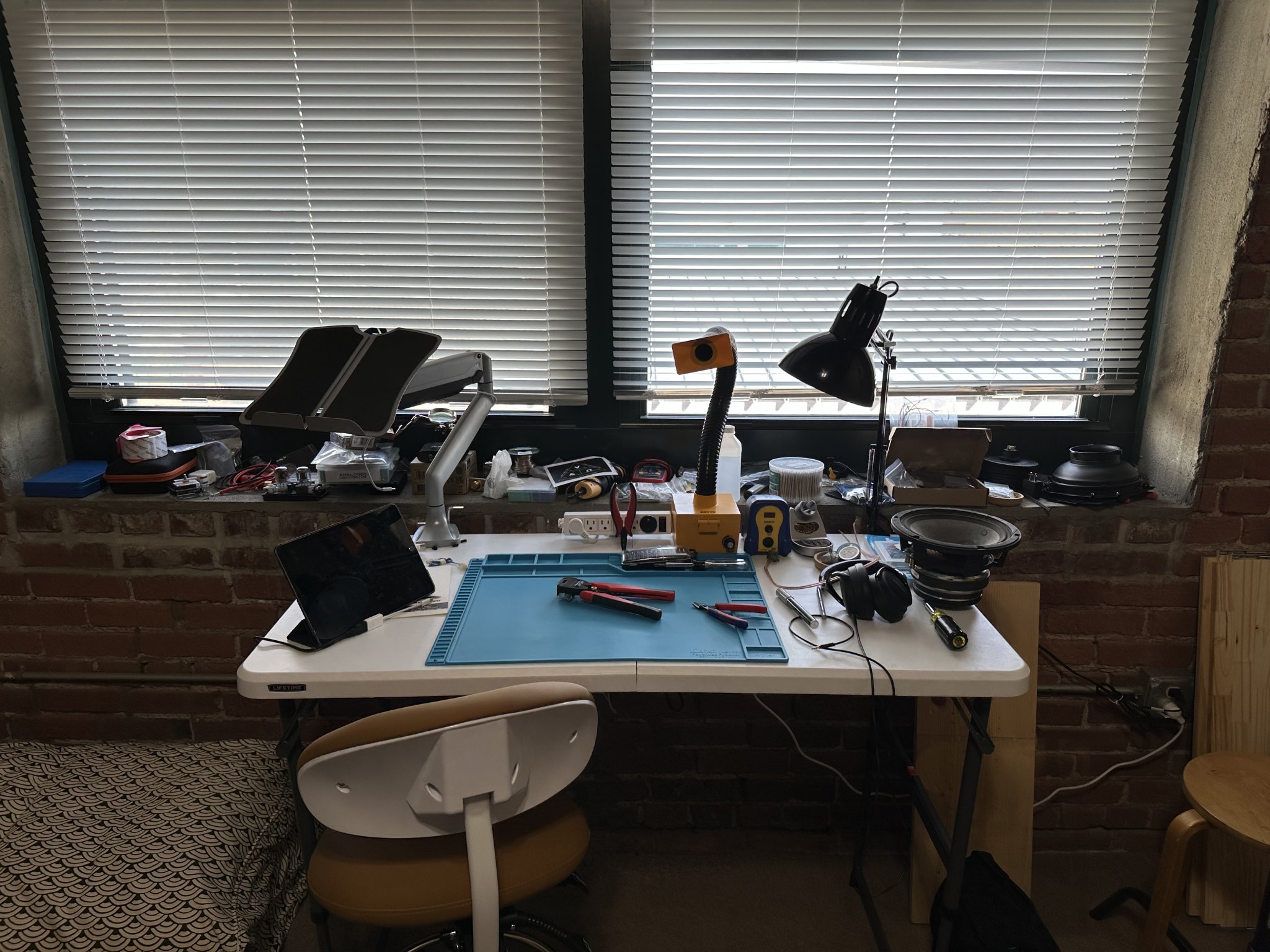

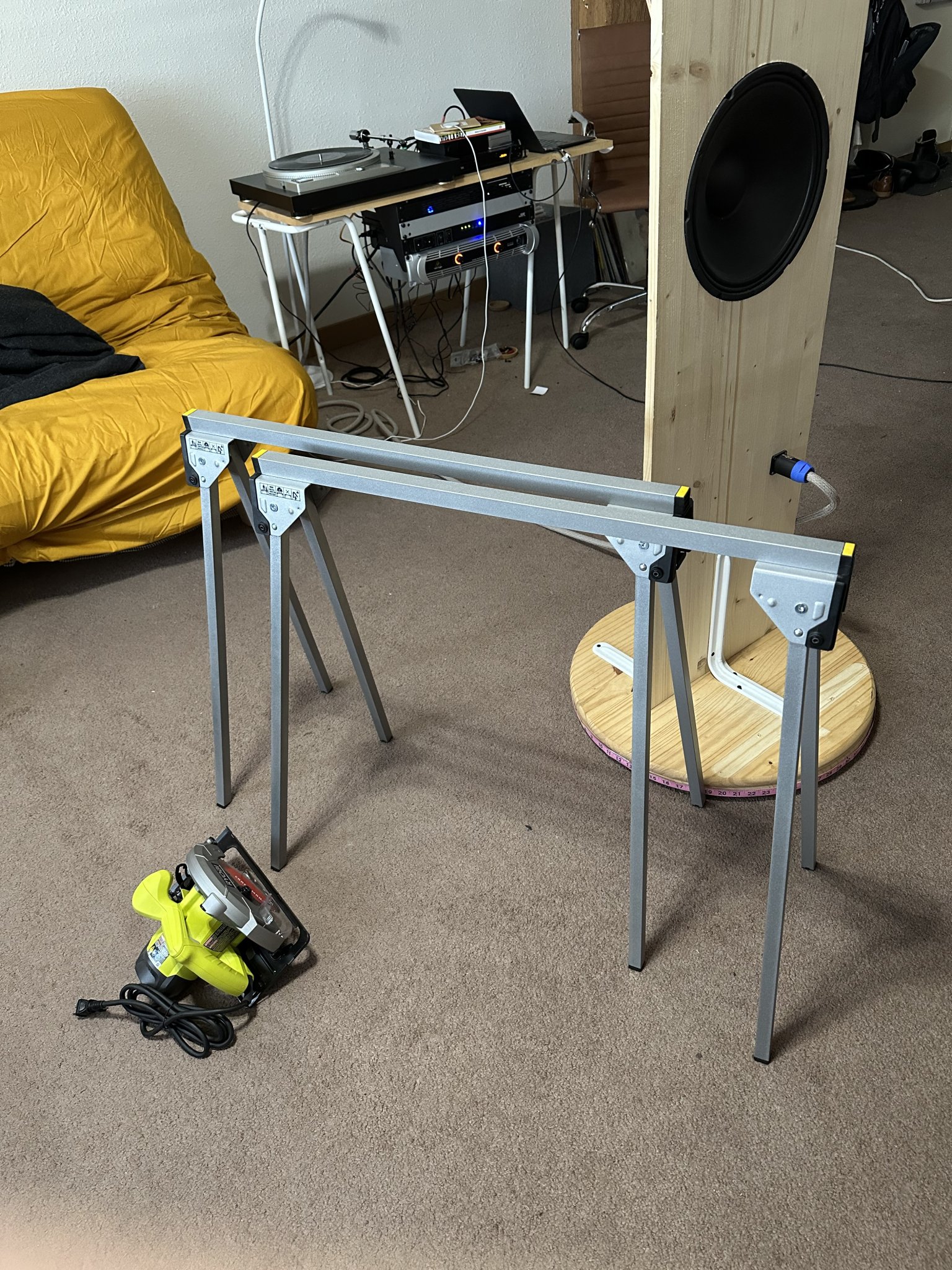

I'm now building out a workspace in my large studio apartment. I have trestles and a large battery pack that I haul downstairs into the back alley to route holes into my open baffle projects.
Currently a foldable plastic table with adjustable height is my work bench but I'll be splurging on an 8ft x 2ft countertop soon using fittings from makerpipe.com and electrical conduit.
I got a saddle stool popular with dental assistants/tattoo artists and love it. The lamp is good for now but have my eye out for better solutions as better coverage would be great.

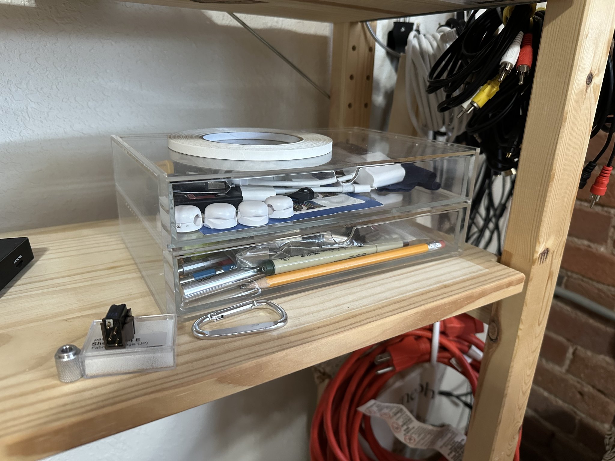

@Turbowatch2 mentioned transparent storage solutions from Ikea. If you are a disorganized person like me being able to see everything that is inside is a big help. This is an acrylic makeup case from Muji (Ikea of Japan) but you can find similar products for less money at office supply stores etc.
Of course cables are a real hassle as well... I ended up getting large S-hooks for bird feeders and velcro for the longer cables and this little rack off amazon.

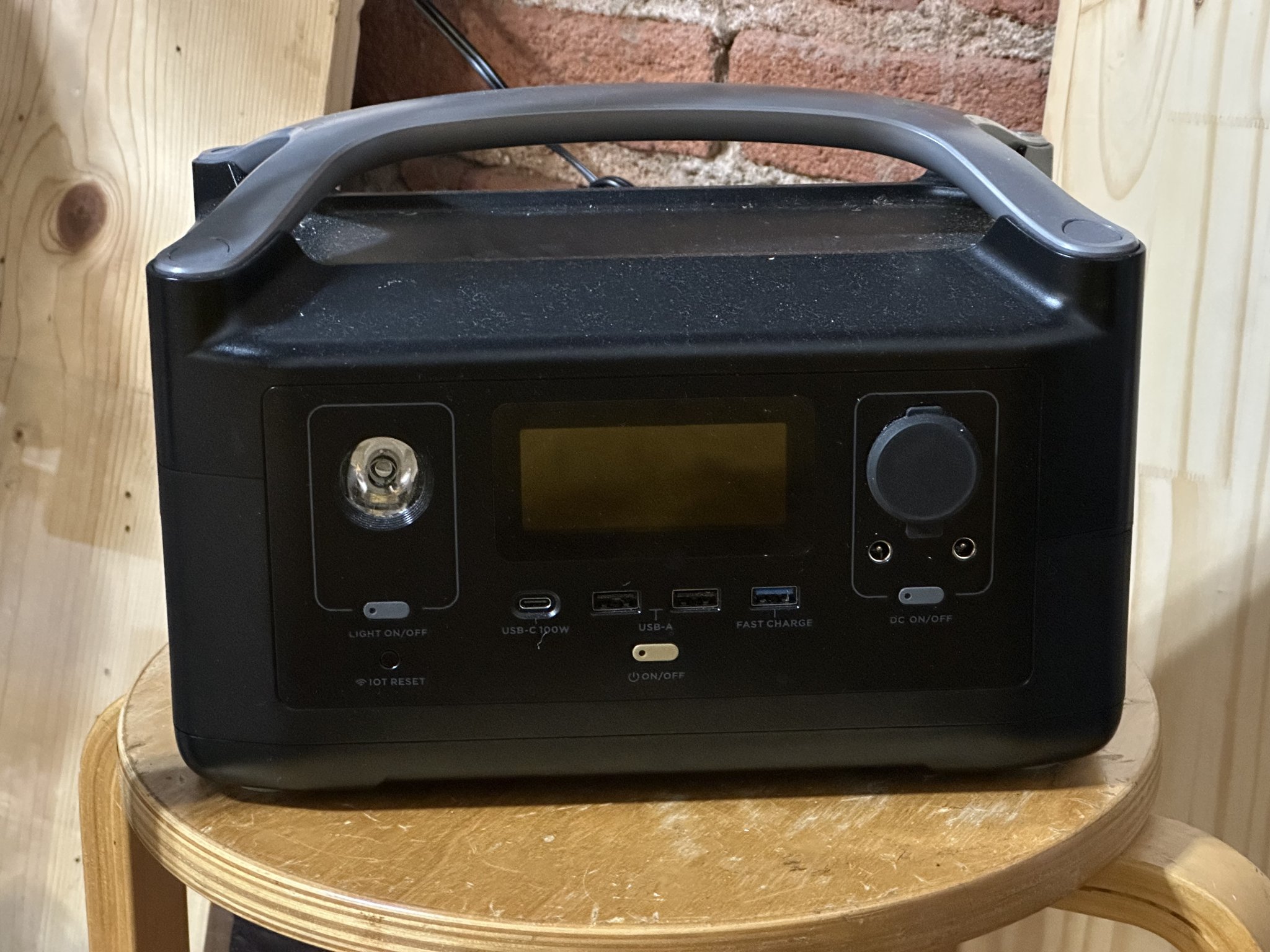

You have a battery pack, with corded tools and an inverter, or...?
I have a battery pack with a built in inverter:
I could only route the circles on one side at a time, however. Took two trips. They do come in larger sizes if budget allows but this size fits nicely in a wagon along with the tools, wood and saw horses.

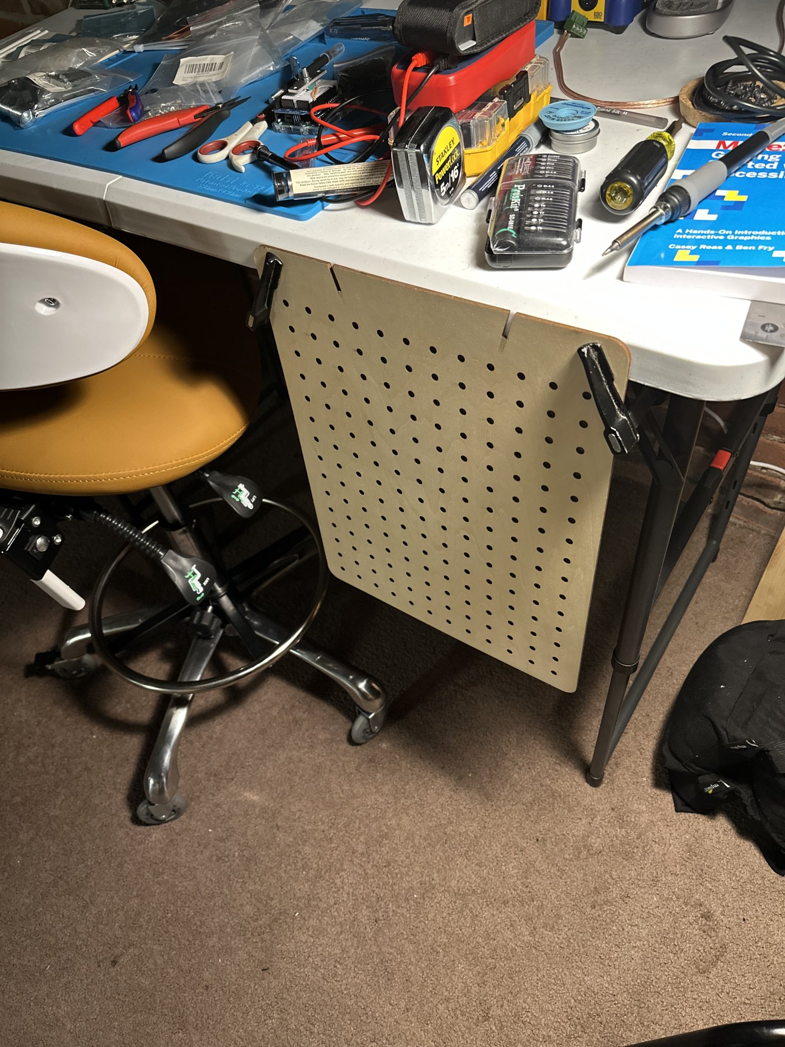

Arm reach is super important. I just clamped this cheap craft display to my bench today:
My hand reaches to the bottom of it so it's perfect for everything I'll reach for regularly. I'm a total beginner so I opted for an Analog Discovery, which is a USB electronics lab for EE students. I'll screw it in to the butcher block when the time comes.
My space will alternate uses between film editing, coding and maybe some mold-making. I initially bought a huge 10ft x 4ft plastic sheet for rolling chairs to lay underneath and protect the carpet from any mess. What a mistake—the static was so bad I could see sparks fly off my fingers! I'm now looking into rubber gym mats because the anti-static options are just too expensive...

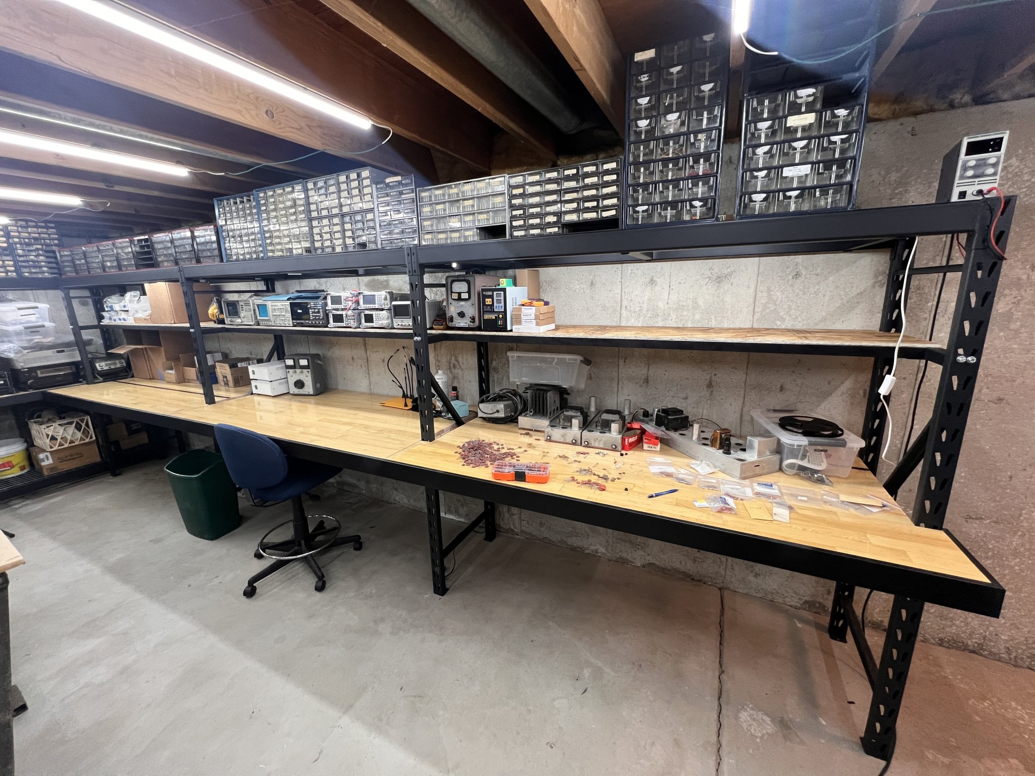

I recently started an overhaul in my basement to accommodate my newfound audio/tube audio restoration interest. I rent a hangar at the local airport where I have a decent metalwork setup with lathe/mill/fixture table etc. but I wanted something at the house so I didn't have to travel 30min every time I wanted to work on projects. My basement is roughly 1250 sqft (116 m2??) with half taken up by two simulators and the other half was just a bunch of shelves with stuff randomly stacked on them. I would say I am about 2/3s of the way through the overhaul and am quite pleased with the outcome. I had planned on welding up framing for all the benches from scratch but in the process of reorganizing all the shelving (from Costo) I realized I could just modify the shelving system to accept a work surface. With a bit of additional framing I was able to come up with the bench system you see in the picture. I have yet to finish the central work benches but am planning on 2 to 3 3'x6' (roughly 1x3 meter) work surfaces as that is the largest size I can practically get down the stairwell. I wanted/neede a relatively large flat work surface as I also dabble in sewing a bit as well, stuff like upholstery, equipment covers, backpack mods, etc. I'm almost done. Still a few things to finish out but I am able to work on projects for the moment.
The problem with watching mend it Mark's video is that you will likely end up getting "test equipment envy" and have a wallet thinning event of disturbing magnitude. lol...
Not that that has ever happened to me... 😉
I really like Erik's Electronics Workbench video on isolation transformer/current limiter/variac setup. It's very comprehensive.
A couple of comments: A lot of the light is being wasted from those fluorescents. You really want lots of light in a lab/workshop. Ideally, the ceiling fluorescents want to come down. I understand why they're above the bottom of the joists, but a lot of light is being lost. It would seriously help to paint the joists white. The fluorescents above the bench are lighting the top of the test equipment. Is that useful? Probably not. But moving them to the front underside of the lower shelf and putting something in the way to prevent direct sight of them would illuminate the work surface. The other thing to think about is electrical muckiness. I have a clean end (where electrometers live) and a dirty end (where the leaky Topaz isolating transformer lives). Other than that, I'm deeply envious of that amount of bench space - my bench is only 6ft long and its (sturdy) shelf is stacked high with test gear. At one end is floorstanding rack of shelves, and beyond that are the electrometer shelves. At the other end are book shelves and the Topaz. Available walls are covered with Raaco cabinets and the fitted wardrobe is filled with floorstanding racks of shelves.
Just a thought, but I would rotate those shelves up against the wall on the left hand side by ninety degrees so that they stick out from the wall with narrow paths in between - that would give you more space around your workbenches. You also have some wasted space in the corner, but if you've done as I suggest, you could slide the three shelves along the top to the left, to butt into the corner, moving that wasted space to be next to the 3D printer where it can be used.
You will need loads of power outlets. I have a strip of 21 x IEC guzzouters for the test gear and it's still not enough. Fortunately, I have eleven double mains outlets at working surface height, but almost all of those have now been stolen. Do make sure the bench metalwork is earth-bonded.
Thanks so much for the suggestions...
All the lighting in the basement is actually LED. The lighting you see turned on here was just half the lights actually available. There are in fact lights under the "test gear shelf" that I had just not wired up before I had taken this picture. I'm telling you, when the lights are all on, there isn't a shadow to be found!
Power wise there is one 20a dedicated circuit per 6' bay and a full length power strip on the main bench as well as the "equipment shelf". Two of the bays have isolation an transformer available and I hadn't put the dim bulb tester in place prior to this picture that is in the center bay where I will do most of my work. Also, since this is a modular system and the additions I made are also modular I can adjust the arrangement as well as shelving and work surface heights if needed.
Trust me, I have tried many many permutations of this layout including arrangements with the shelving 90 degrees to the outside walls (library like). I have found that with the space I have available and the type of work I do, this has been the most useful layout I have come up with. The two shelves back to back kinda out in the middle on the left side are actually me just experimenting with additional shelf spacing and orientations, they aren't actually there at the moment. It's sometimes hard to tell from a two dimensional drawing how things work out. Never mind that there a ton of non movable obstructions (plumbing, vents, etc) that are not shown in the drawing. Dead space in the corners is a result of pre-fabricated shelf size as well as obstructions so there isn't much I can do about that. Most of the corners I use for storage of lengthy items like metal and wood stock and the like.
Maybe once it is all complete I will do a proper tour but it's still a work in progress at the moment.

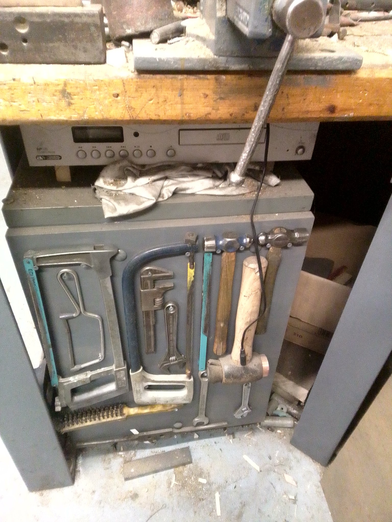

This is what I have under my bench, I can just reach down and grab what I want, and it doesn't get in the way of my feet or knees. It's mounted on the back of a filling cabinet, as my office space is on the other side. It's just stuff hanging on wood screws, driven into MDF, painted battleship grey, I've painted a lot of stuff the same colour to give the space some "unity".
