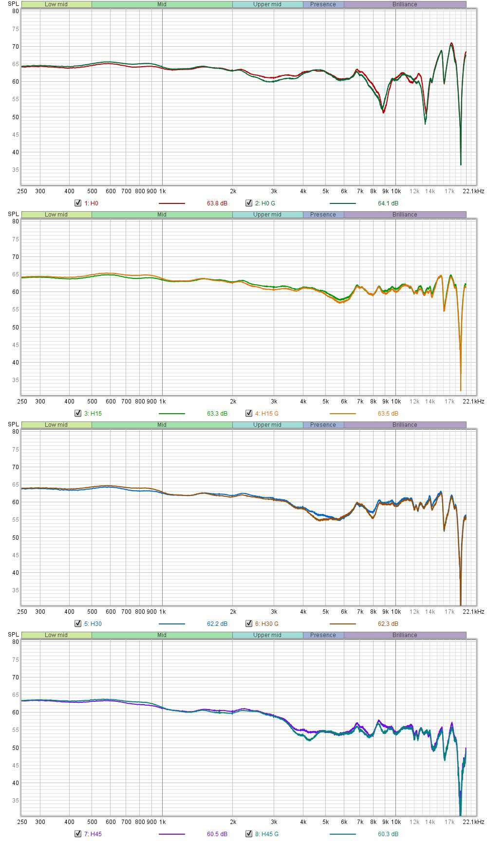

great to see high freq responses, thanks! if i where you i would have measured the responses from 0-30-60-90 degrees as a minimum to get a feel of the behavior, i think you are looking at too small a window

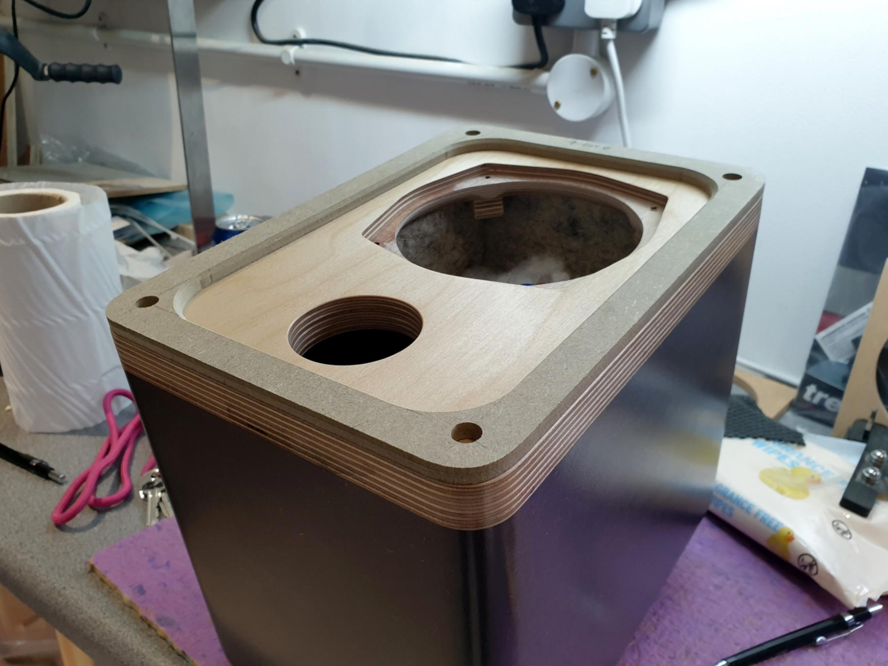

you have nice smooth rounded edges on the back, why did you not do them on the baffle where they really counts?
Ah, yes, I forgot to annotate. Those polars are 0-15-30-45.
TBH, I can't see that there would be any information I could use beyond 45 degrees. What are you expecting to see or detect?
As for the radius on the rear of the cabinet: it is purely for aesthetics and to cut the cabinet size down a bit. A roundover /radius is only useful or effective above a certain size and/or ratio to the baffle.
"If the edge has a radius of ¼ wavelength of the sound, then above this
frequency little to no diffraction will occur while below this frequency diffraction will
occur" - Geddes
This means to have a properly effective roundover I would need a radius of 43mm/2000hz for the baffle width (172mm) where the diffraction would occur.
Besides which, the diffaction happens above the crossover point and the horn tweeter doesn't even see the baffle edges
occur" - Geddes

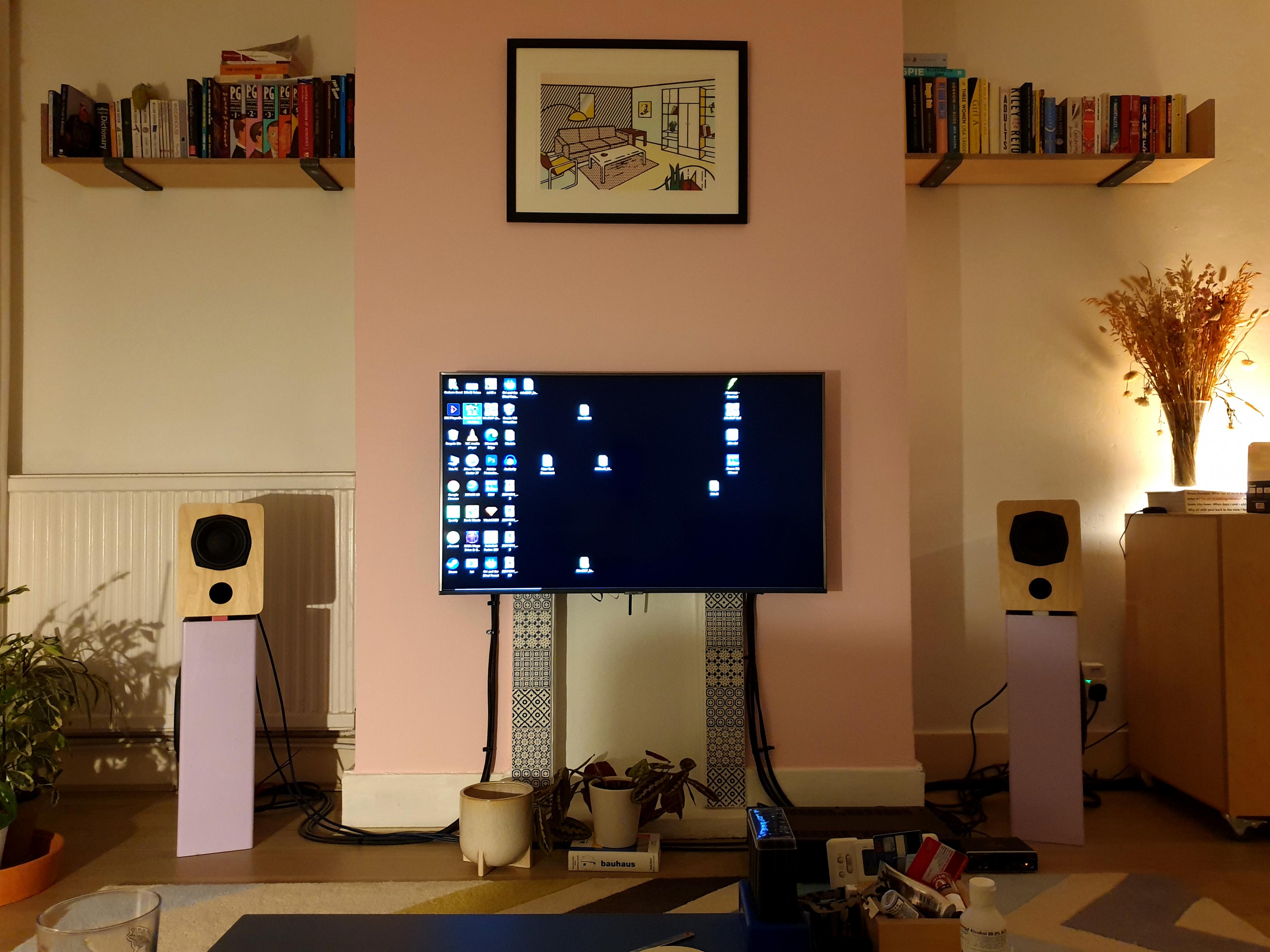

grahamgraham- what are you running for speaker stands? Looks like some side mounted subs? Where are you crossing over to them?
Haha, joensd, think I'll have em with chips. Cheers and you're right. Wife has been gently warned of the other project!
Mordikai, they are some 8" SB Acoustics sealed subs that I haven't had on for a year now. The house we are in has paper thin walls and with the boundary loading I get from being against the wall they aren't needed. I have two pairs of these but they'll go in to the attic until we buy a house big enough to utilise them! They are rather discordant with the decor so I need to sort them out for the 10" project!
I have been enjoying a simple two way now for a year and I think for the forseable future that's how I'd like to keep it.

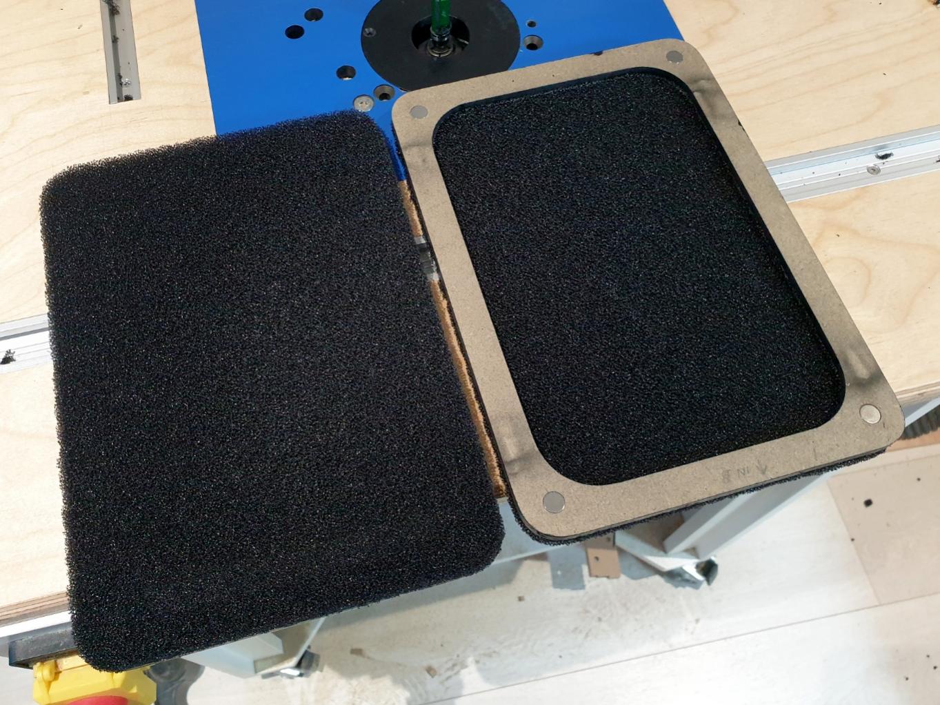

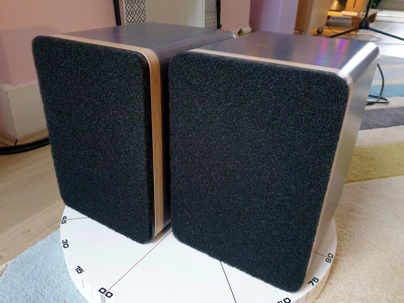

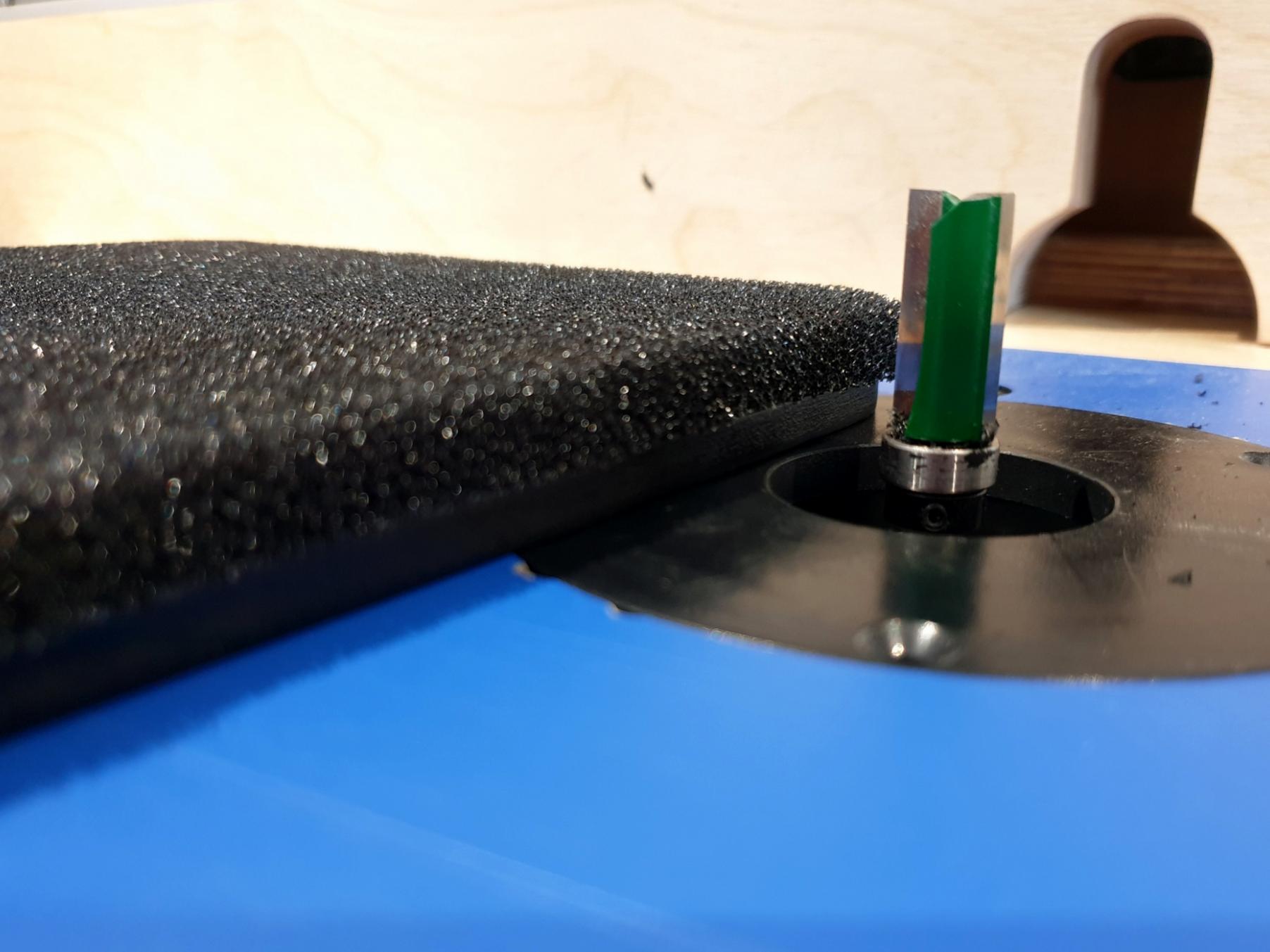

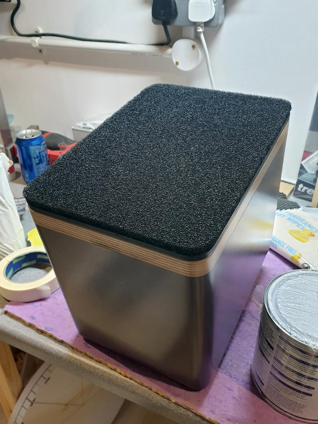

Finished the grilles. TBH I'm not awfully happy with the look of the foam as I wasn't able to get a crisp edge. I ended up using a template cutter on the router table which I was surprised did as good as it did but it still isn't perfect. Intially I was worried the cutter would grab the foam and pull it in but I did a test run and it just flung it off fairly well.
Measurements show neglible disruption to FR.
At least I have the shape of the baffles to make a better grille later down the line if they ever come in to the house.

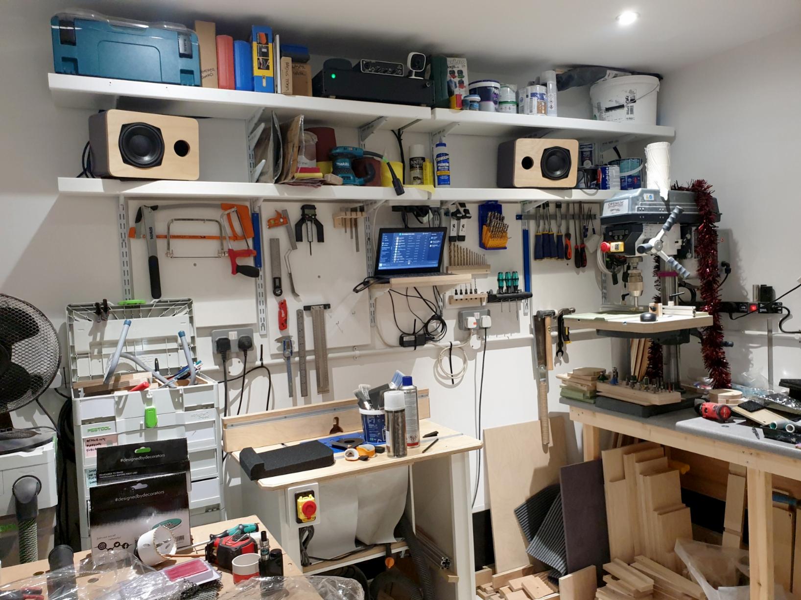

I finally got them in to my workshop on sunday and gave them a good testing out. Wow, these little drivers can reach some epic SPL levels. They ate Infected Mushrooms for breakfast and just laughed at The Prodigy. I came back in the house realising I need to be careful with my hearing out there.
They need EQing for the room which being a very reflective space is difficult. I did some measurements to take the bass ring out of the 3.5x3.5m room but not really sure how to deal with the top end. Maybe just do it by ear.
One overwhelming aspect I didn't really get the gravity of until they were in situ is that these drivers are several pay grades higher than the job they have been given. These drivers is art!

Nice shop! Those are really compact. I like how they turned out. They look very unassuming yet deliver them goods. Your guests to the workshop will be impressed I think. You should take some careful measurements I’ll help you with a passive XO if you want.

From a beginner POV, how is it possible that they sound good with a "uneven" FR? Is it because the HF highs and dips are not broad? After all these are USD$200 drivers

Congrats to a nicely executed project!! The step - shouldn't it be possible to merge the 2 peaks into one with the use of delay? 0,3ms delay for the tweet? Not sure one can hear it but hey, its there for grabs.. ;-)

I didn't look in to what Scott did for the crossover, I just measured them at 15 degrees and made a flat downwardish straight slope that had the best trade off with diffraction/beamwidth/hashiness taken in to account. The hash/peaks and troughs are generally only there when on axis which is the least likely listening position unless they're in a fixed listening spot. Even then you can tow them in or out to get thebest response.
However, I was watching or reading (can't remeber) an Audio Science Review on how to interpret speaker measurements. He was tlking about which peaks are more noticeable. I'd always assumed that low peaks or troughs were as noticeable as high but apparently we don't notice it so much in the treble. This gave me the push to ignore the choppy FR and just go in. Also, Scott is a trustworth designer and if he used them then, well, yanno.
If you are REALLY paying attention you can notice it when moving yourself around the speakers but in normal use it's totally not a factor. You do have to move around a lot though.
