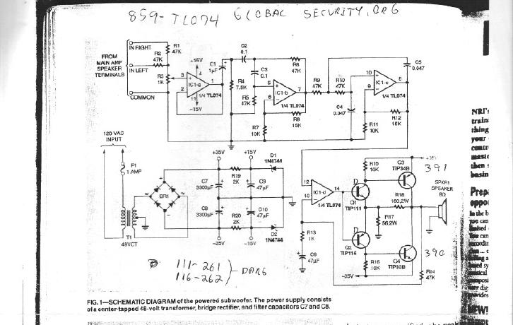

steven344 Member Joined 2005 2005-11-27 1:18 pm #1 2005-11-27 1:18 pm #1 I found this in a magazine and works pretty good,It might be possible to improve it,Any thoughts welcome Attachments sub.jpg 57.7 KB · Views: 316 A AndrewT R.I.P. Joined 2004 2005-11-27 6:19 pm #2 2005-11-27 6:19 pm #2 Hi, works pretty good or looks pretty good? Neither! Keep searching. Status Not open for further replies.
