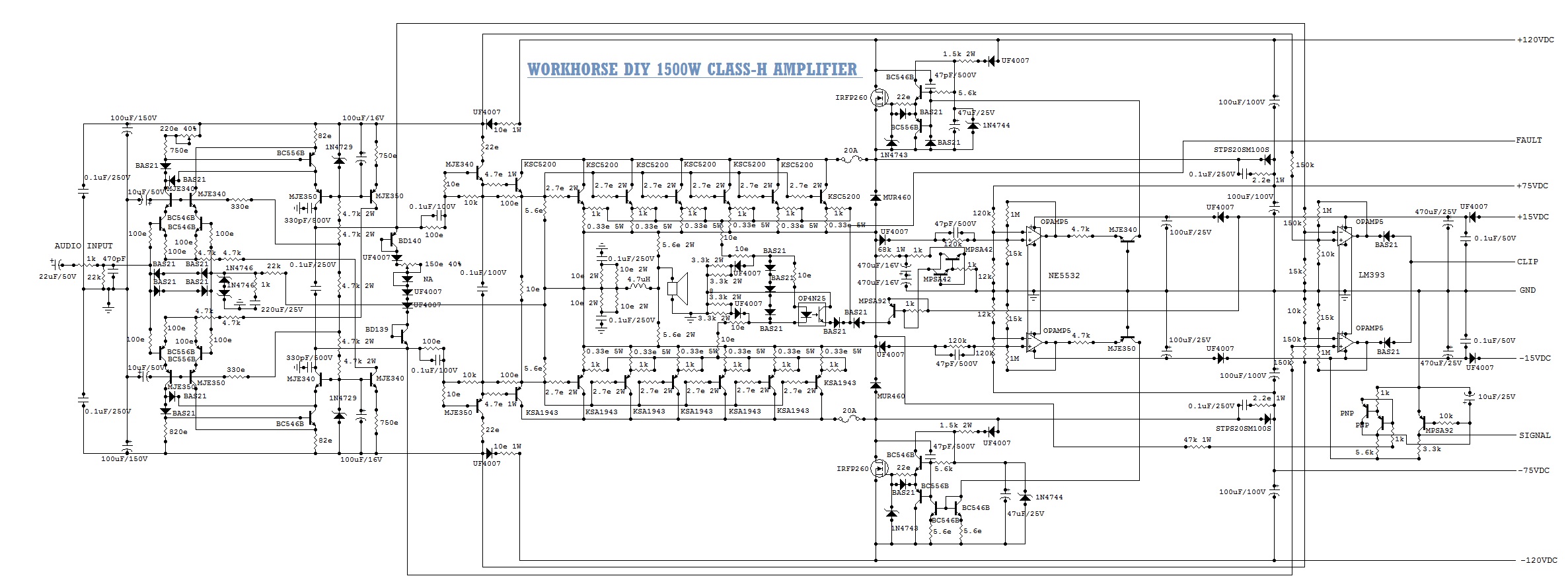

Do it yourself, Class-H power amplifier 1500WRMS @ 2ohms
[h=Introduction]%2[/h]
Its a Class-H amplifier with following features:
1: Fully complementary symmetry input differential with Cascode loading.
2: CE-CB Cascode VAS for wider bandwidth.
3: 2 Step rail switching with controlled slew for minimizing switching noise.
4: Triple EF output stage for high damping factor and ease in 2 ohms load driving.
5: All set of required basic professional protection circuitry.
6: Almost Half the heat dissipation of same wattage class-ab amplifier due to Rail Tier Switching and excellent handling of reactive loads.
[h=Goals]%2[/h]
Goal: To design a reliable amplifier with professional standards.
Result: All design goals met.

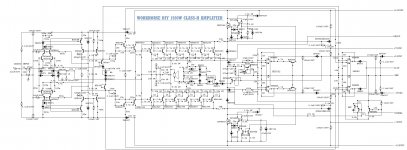

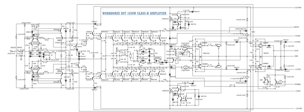

[h=Schematic/Blueprint]%2[/h]

* Requires 2800VA transformer with following winding specs: 85-50-15-0-15-50-85 14A secondary.
* PCBs should be printed with minimum 35micron and PTH is must as there are vias on the board
* PCB measures 37 X 12 cm (4.75 x 14.5 in)
* Bias Pots: 10mV across emitter resistors of output devices corresponds to 30mA through each device, should be optimum
[h=Known Substitutions]%2[/h]
* You can use Genuine 5200/1943 upto 1.5KW or MJL21196/95 for 2KW
