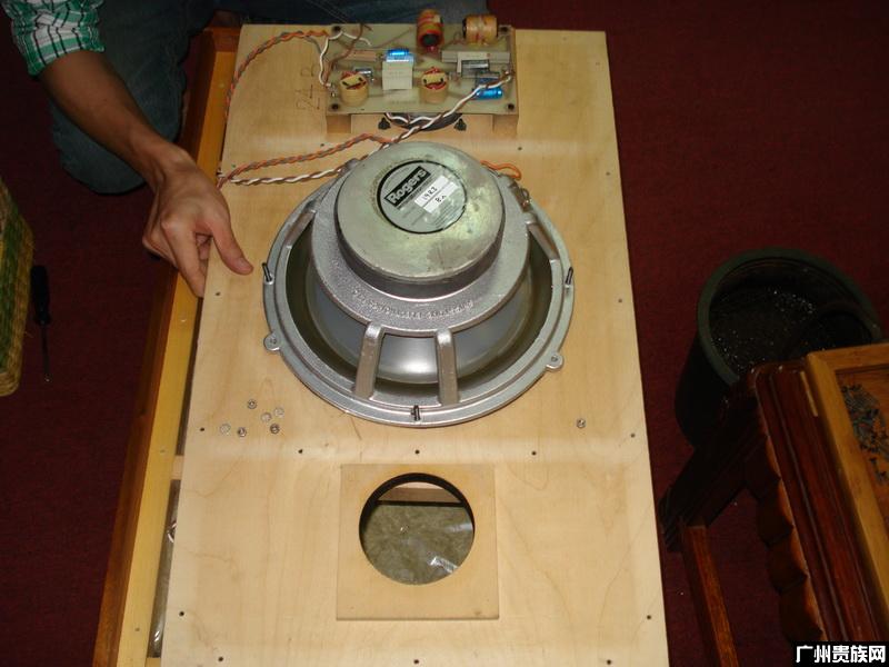

I was looking at some British classic speakers like the Rogers PM510 S2
I have noticed that the woofer is mounted on the inside of the baffle
This is quite unusual .. is there a technical reason for this ?

In fact it's quite the other way 🙂
Most speakers in the World are inside mounted 😱 , for the technical reason that it's easier to do so and any one can be mounted that way.
"Front mounting" requires :
a) a speaker frame which allows it, meaning it has a relatively wide lip or mounting "ears" which to boot provides a flat surface, which can be back gasketed.
As you know, 99.99% of speakers provide both (a flat gasketed lip all around) at the front 😉
Meaning practically all speakers are built so they can be mounted inside. 😱
b) some frame to support a front grill on its own, which allows its removal for mounting/unmounting speakers.
An inside speaker cabinet can have the front grill permanently stapled or glued, which is simpler and cheaper.
That said, front mounting is better, mainly because you lower edge diffraction, the resonance of the short tube you have in front (hole diameter and wood thickness), you improve dispersion a little, etc.
Not so bad in a woofer, but definitely hurts in a midrange or tweeter, so if you front mount 1 speaker ... you may as well front mount all. 🙂

Hi and thanks a lot for the very kind and valuable reply
So there is no specific technical reason
I was thinking that with the woofer inside the box the cone is more free to move ... there is more "air" behind it
Instead with the woofer outside the edges of the hole can have an impact on the movement of the cone ?
As i said i saw this technique used by Rogers, Spendor and BBC speakers

We've had this recessed bass question a lot of times. The reason you get away with it in BBC type designs is that if you wire negative polarity on the tweeter, and arrange the alignment error in the bass and tweeter at 2 to 3kHz crossover to be half a wavelength, which is 7.5 cm to 5 cm, the phase around crossover then aligns perfectly with big 8" to 12" drivers. 😎

Harbeth (and myself) still do it. It sounds good. If you look at old relevant KEF and Rogers 3rd order crossover designs, you will see that the tweeter IS always wired negative polarity. Let's consider the additional 90 degree phase difference in 3rd order butterworth an added complication, strictly for the enthusiast...

It requires a removable front or rear baffle, though some
BBC types have both. It allows a simple and thin grill.
FWIW most cheap boxes made nowadays have no
removable panels and drivers are front mounted,
usually, though exceptions through the bass
hole exist for for some mids, and rear press
fit tweeters in general - the latter usually
implying a 12mm thick front baffle.

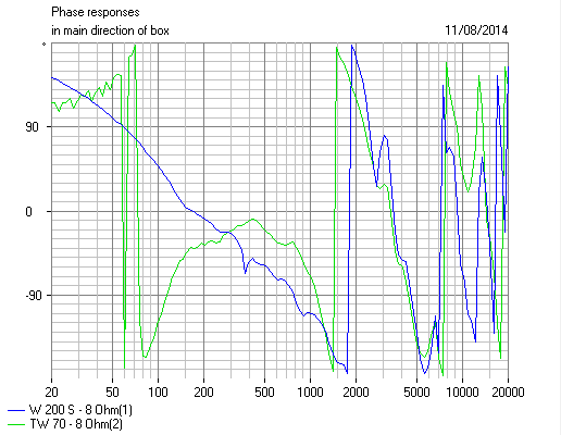

Good phase matching, or at least control of, makes for the drivers reinforcing each other at crossover, rather than cancelling each other out and creating a hole in the power response on axis.
I had a look at a flat baffle 8" woofer plus small tweeter on a BW3 (Butterworth 3rd Order filter) here:
http://www.diyaudio.com/forums/multi-way/190129-8-1-two-way-diy-speakers-11.html#post4016777
On the following page I looked at some other filter choices like LR4.
http://www.diyaudio.com/forums/multi-way/190129-8-1-two-way-diy-speakers-12.html#post4021676
The negative polarity principle applies to bigger woofers too, which otherwise would have lousy phase matching due to the deepness of the woofer and its acoustic centre.

Hi and thanks for the very interesting review
But as i said for me is very difficult to understand all this phase issue
You have attached this graph
I do not understand it. What does it show ? how can i read it ?
How should the "perfect" phase graph look like ?

Phase is the graph that people find hard.
What it shows is the 8" woofer has a significant energy storage, aka cone breakup at 3kHz. That is the S-shaped kink in the phase. It is good to have rolled off the response significantly at that frequency to reduce its audibility.
Aligning phase well on Linkwitz-Riley 4th order (Steep 24dB per octave rolloff) is important too. It's probably the cleanest sounding filter around, with steep rolloff which just works well. BW3 (A shallower 18dB per octave) needs a lot of skill to do, because the phase has to be 90 degrees different between the drivers.

Hi and sorry sincerely for the late reply
I must confess ... i still do not "see" the issue from the graph but thank you anyway for trying to explain
It is not like a freq response .. a distortion spectrum ... a time alignment ... that i can see

question? what would happen to the phase response if the position of the drivers in the BBc 510 where swapped as in tweeter mounted to the inside of the baffle and woofer on the outside assuming an average baffle thickness of 3/4 inch?

- Woofers mounted from the inside
