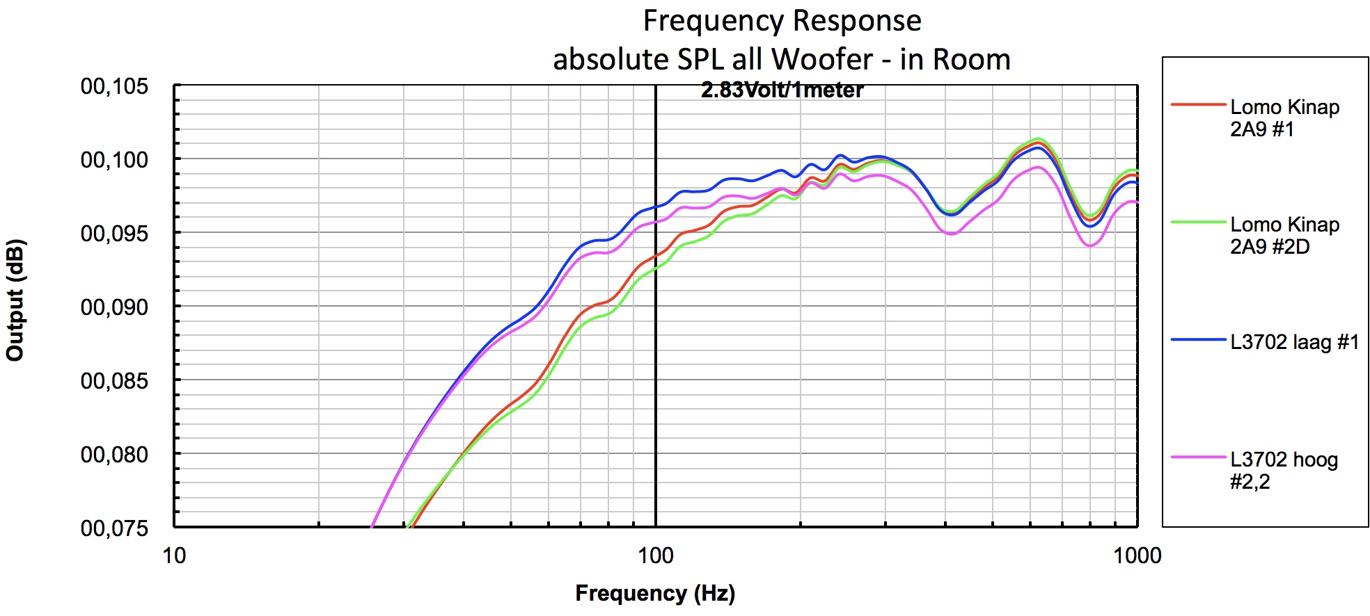

from reading all this, I have a question.
My woofers have a LOW Qms (Qms #one is 2.00, the #two 1.40).
Also Qes is low (#One 0.44; #two 0.20). And the Fres is unequal too: #1 52, #2 something like 38-42.
It is a 38 cm speaker, paper cone. Paper surround (3 plies) & Alnico magnet. Built in 1956 or so.​
So they differ.
Although on an open baffle simulator the sound pressure equates to almost the same - within a dB :confused:
What should I do to get them more equal. (I think) I like a higher Qms; I am afraid I cannot increase the Qes.
Might be a stupid question all together.
I was surprised by the open baffle simulation, seeing the big 'differences' in parameters; but as I read in this thread, the parameters are only based on one frequency: the resonance.
There is something evasive going on.
Now I liked the L3702 very much in the room, but it only started to shine at louder levels. Then the sound was really what I preferred: on voices, singers. It has Qms 5,12, Qts 0,56.
On low level detail the 2A9 shines, it gives more depth and background, small music details, but bass lacks on open baffle. So needs more correction. I dropped the OB idea [for now].
I plan to go closed box.
Question: would the difference in parameters also be negligable in a closed box?
Found a calculator. Targeting a Qts of the box of 0,6, I get: #1 - 50 liters, F3 119, Fb 98; #2 - 46 liters, F3 122, Fb 101.​
That also is a small difference in my opinion.
It implies those big differences in parameters do not say much.
