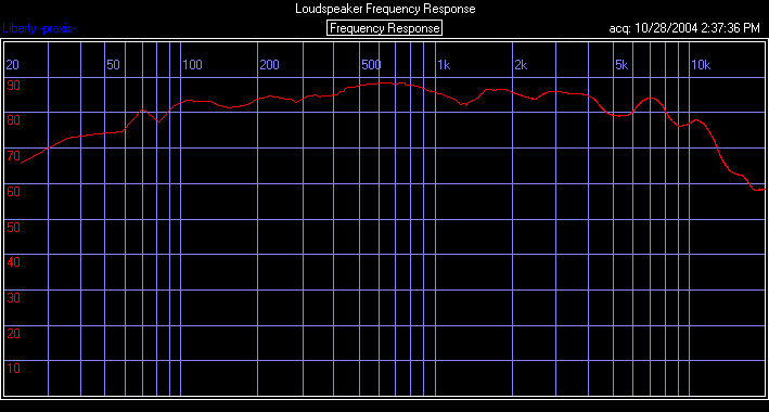

dmitriy167 said:As far as the Extremis goes, it has pretty uneven response and I wouldn't like to deal with it.
What makes you say this? I've only seen the graphs published by Adire, and they're very even. I'd be interested in seeing any third-party measurements.
I would not call the Adire FR graph very even. From 90Hz to 5kHz, it fluctuates by about 8dB. Plus, don't forget that the curve is smoothed, so the actual response would be worse. It's pretty clear that this woofer needs some corrective filtering, and I would't try that without measuring equipment. It may be a great woofer, but it is definitely not for beginners.
dmitriy167 said:I would not call the Adire FR graph very even. From 90Hz to 5kHz, it fluctuates by about 8dB. Plus, don't forget that the curve is smoothed, so the actual response would be worse.
But the response at 90 Hz would be impacted by the enclosure, and all manufacturers graphs are smoothed.
I guess what I'm looking at is the lack of large breakup excursions above 2kHz such as you see with Scan-Speak drivers for example. I have a major aversion to notch filters, and I thought you could get away without one using the Extremis.
The Extremis lacks the breakup peaks above 2k because it has a flimsier poly cone and not an ultra-stiff carbon fiber or Kevlar one, but that's probably what's causing the broad peak from 400Hz to 1k and the dip right after it. If you look at the SS FR curves, none of them have those midrange fluctuations. Also, the SS curves have much less smoothing than the Adire ones, and all the peaks and dips are probably worse in the Extremis than they seem. But the only way to know for sure is to measure.
