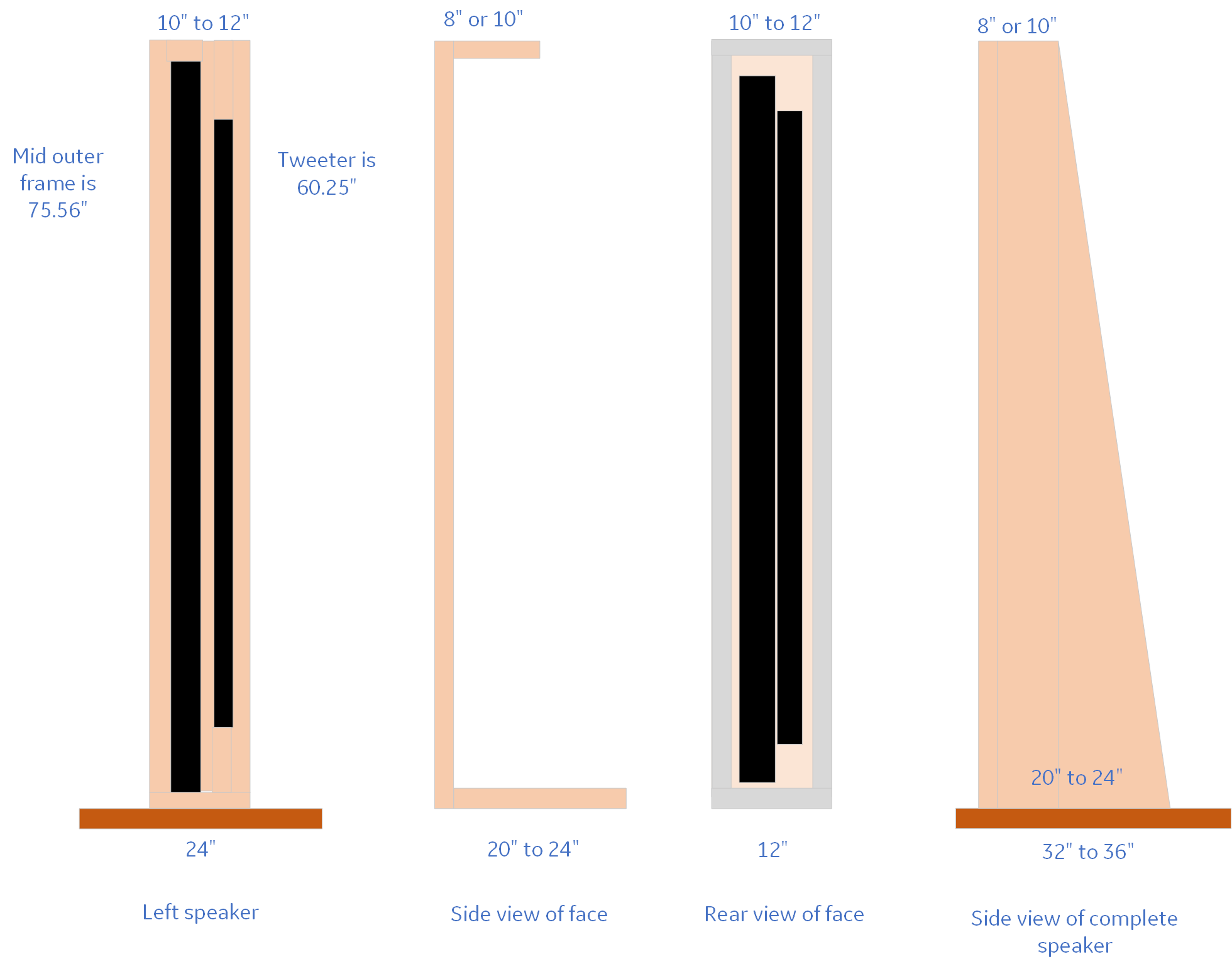

To follow up on this thread. I got a pair of Rythmik F8 for woofers.
I also was able to get a pair of ribbon tweeters used in Magneplanar 30.7's
The speakers I am building are intended for a smaller room which led me to decide not to build dipoles.
The cabinets will be 8 or 10 inches deep to allow for dampening material. 2" of clear space, one or two 2" layers of 701 and two 2" layers of 8# Rockwool.
