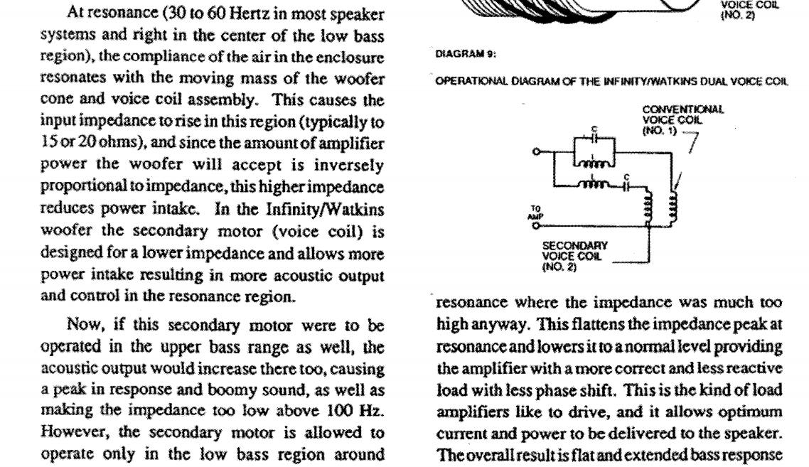

I have done the simulations with the crossovers installed and of course the Zobel filter works as intended on the woofer. The idea of a notch filter at the woofer resonance doesn't seem to do anything regardless of the presence of a low pass crossover at a frequency much higher than the woofer's resonance. (for example, notch is at 60Hz and LP crossover is at 500Hz or higher)
I find it curious that this kind of woofer RLC filter doesn't do anything to any of the other woofer parameters like cone excursion, maximum SPL, etc. This appears to be true for both sealed and vented boxes. I'm working with a Dayton 3" full range driver that I intend to HP cross over @ 500Hz and both a Zobel and a notch filter affect the SPL response of the driver, according to Basta! so it's surprising to me that it doesn't do anything to any of the woofers I tried it on. I would have thought that damping the resonant peak of the woofer would have some effect but I'm apparently mistaken. Maybe it has something to do with the woofer's alignment and thus system Q. I wonder if I simulated an alignment with a really high Q and installed the RLC network what would happen? Maybe later we find out...

Infinity used a "Watkins" woofer with dual voice coil. They claim that the woofer low end response is extended by their technique. It would not really be possible to implement their idea as far as I know because the second voice coil is much lower impedance than the other one. Most DVC woofers have equal impedance coils.

So, you're saying that Mr. Watkins and the Infinity loudspeaker company are wrong? See the white paper I attached to a previous post. Granted, this is a special woofer, but still the RLC circuit was used by them for many years to cancel the bass resonance and apparently lower the low frequency limit of their driver.

How else are you going to put in a HP subsonic filter in a vented loudspeaker in order to control subsonic woofer excursion if you have no choice but to do it passively? Your passive "textbook" crossover would not work without an RLC filter to cancel the bass impedance resonance.
