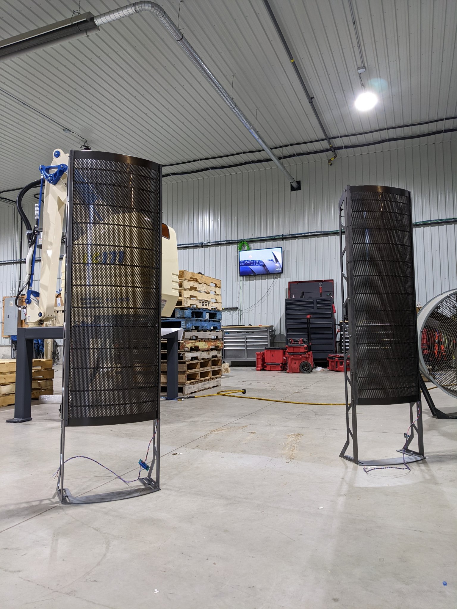

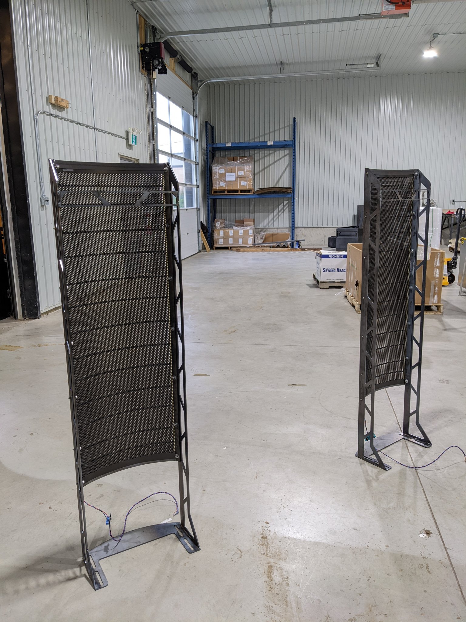

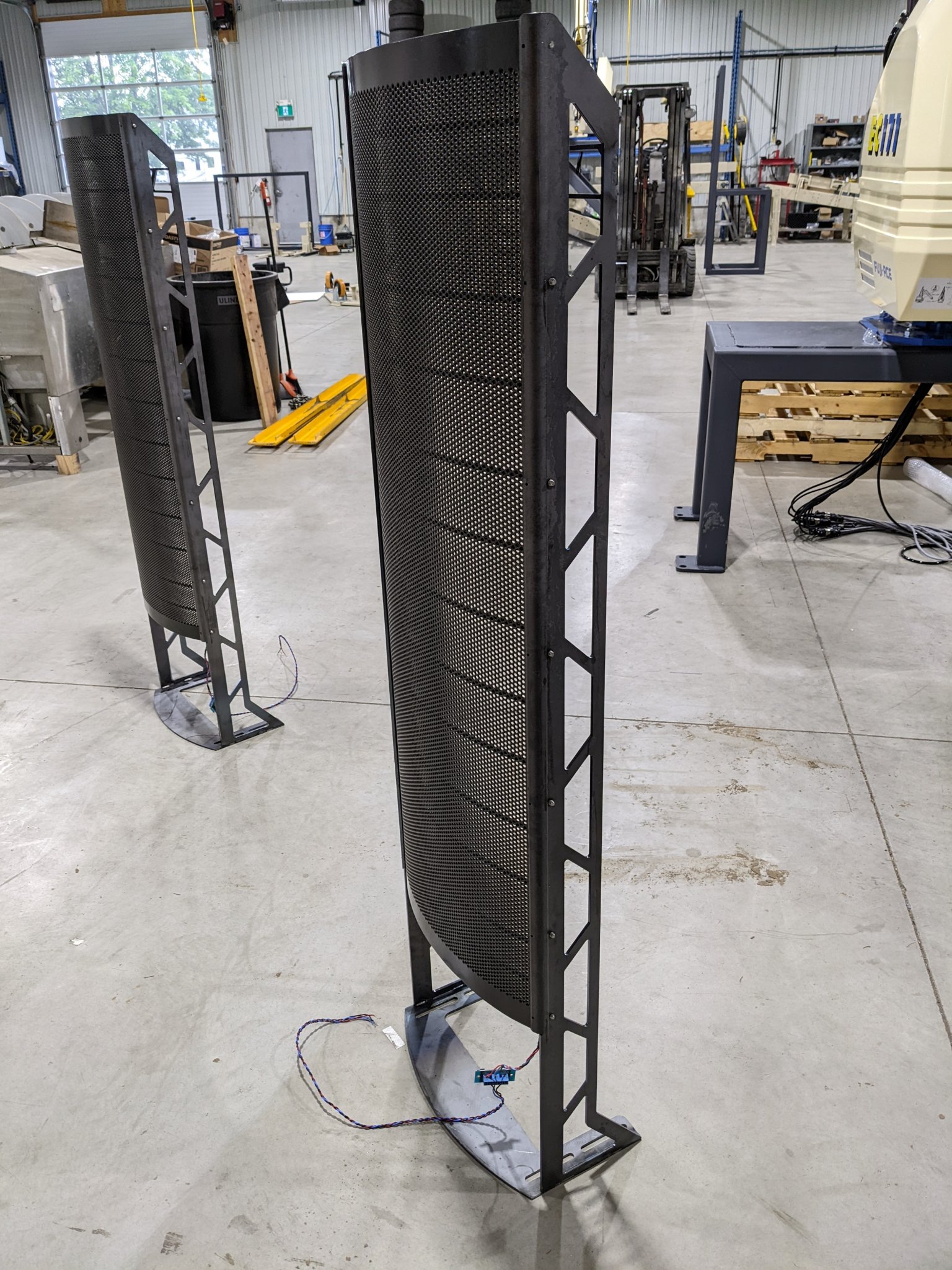

Yesterday I actually purchased a pair of Fane Sovereign Pro 12" woofers that I'm likely going to just stick either underneath the ESL panel in a conventional layout. I'm aware this isn't the "optimal" setup but it should work fine for my needs. The manufacturer recommends a 2ish cubic foot ported box tuned to 50hz so I might try that as a starting point. I modeled it in WINISD and it looks promising for the frequency range I want to hit.
Link below
https://solen.ca/en/products/sovpro-12-500
Since starting this thread I pia Dayton 4X8 DSP unit and integrated it into my setup to run my Martin Logan Aerius speakers fully active. I am going to do the same thing with these large Quest panels and ditch the passive crossover idea completely.
The Dayton DSP is great value. I just wonder with its budget price if the ADC/DAC and output stages are budget sounding. Has it changed the sound on the MLs?
I find it more clear and coherent than it did before if I'm honest. It probably helps somewhat when you bypass that pile of fat resistors, caps and inductors. I haven't seen a lot of people using it so others might have different experiences but I'm totally sold on it, fantastic little unit.The Dayton DSP is great value. I just wonder with its budget price if the ADC/DAC and output stages are budget sounding. Has it changed the sound on the MLs?
