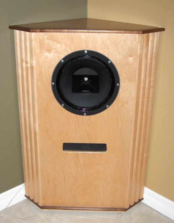

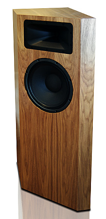

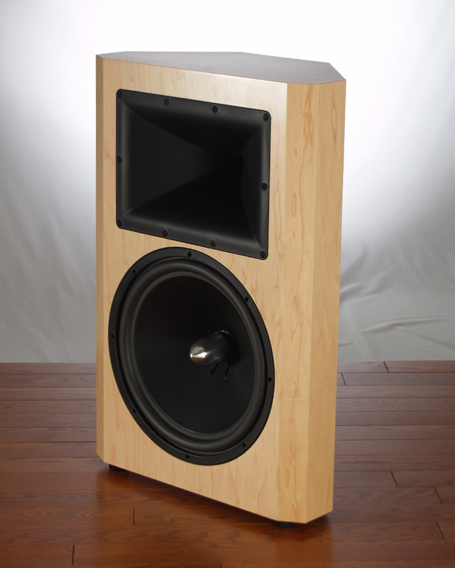

simple corner-speak
~ 4-6db SPL gain in bass, midbass
