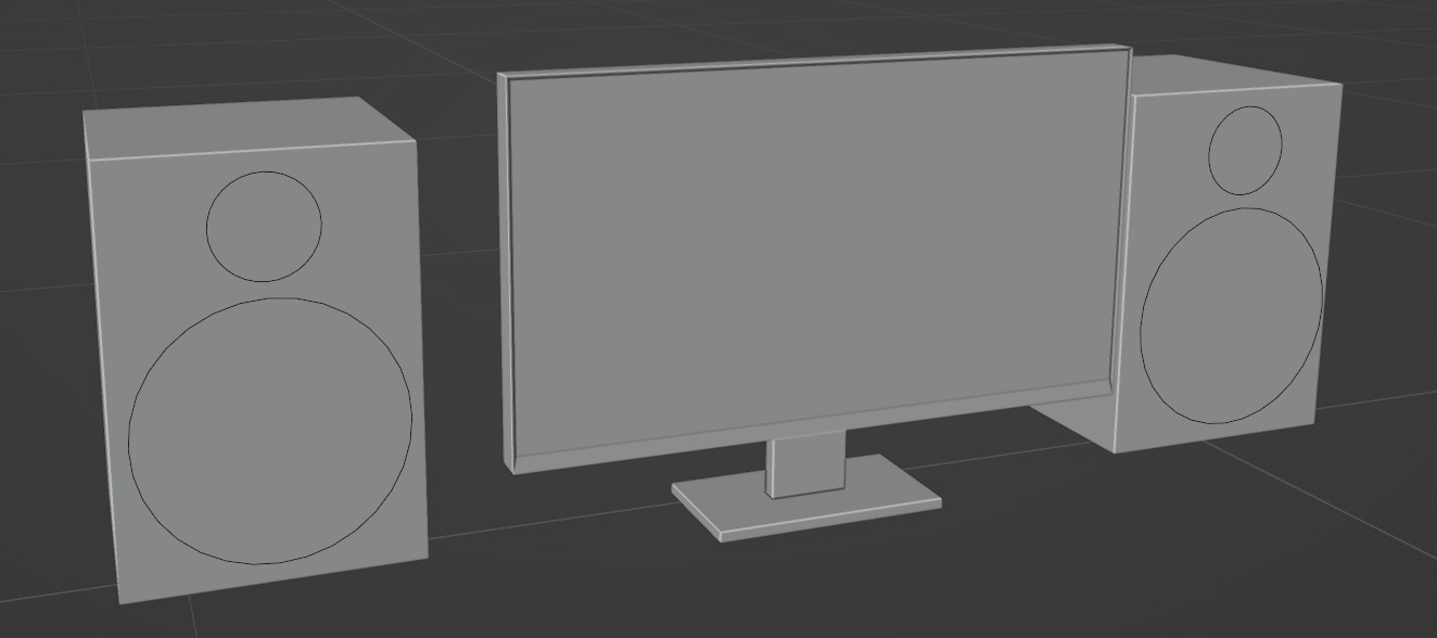

BTW, here are 24 L boxes with the smallest practical baffle for the 8-inch RS225-8 and the 3.5-inch TC9FD18-08 arranged along my 25-inch computer monitor. Circles show outside diameters.
Would you fit these on your desk?

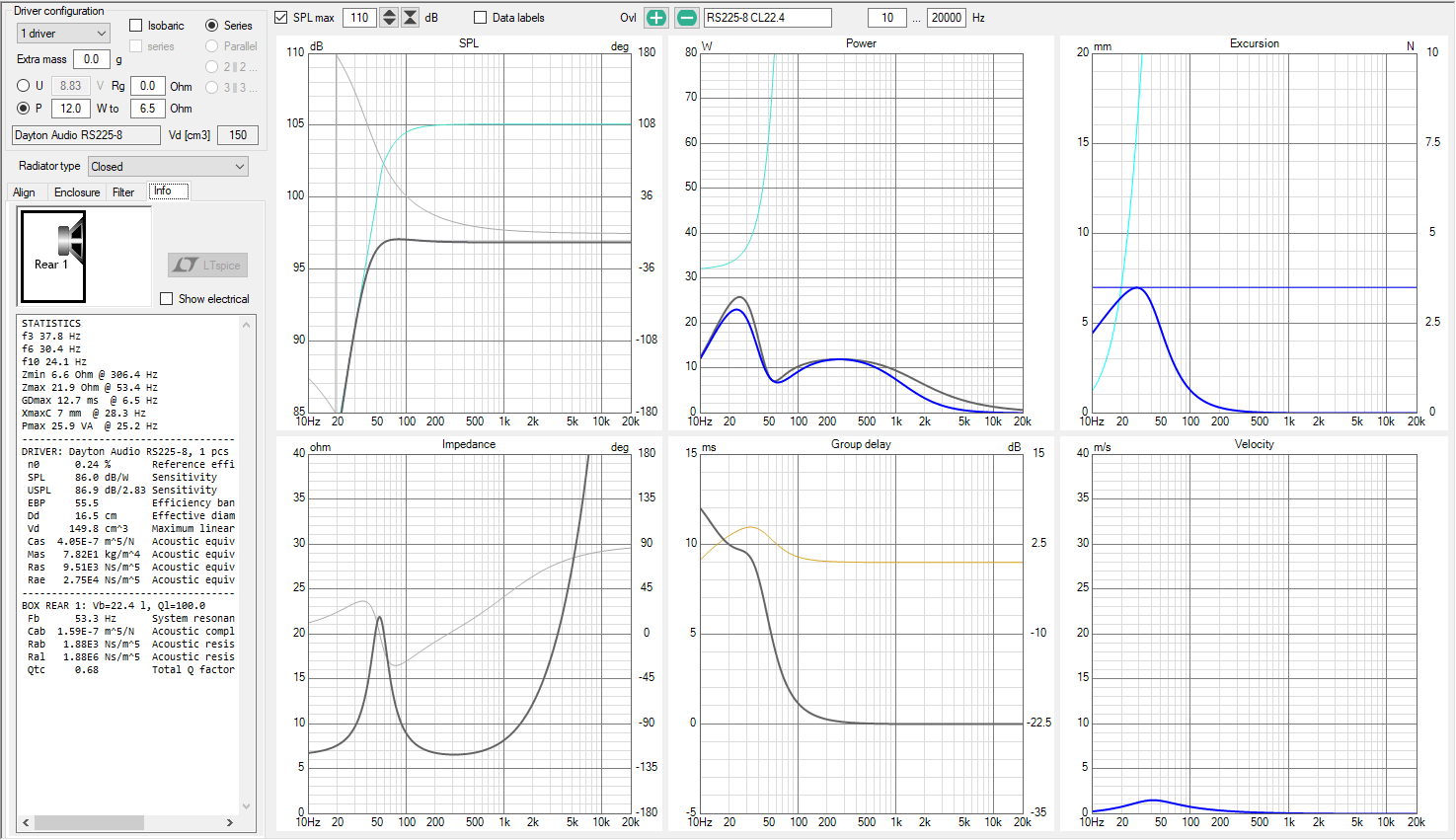

Here are RS225-8 in a 22 L sealed enclosure incorporating Linkwitz Transform and a subsonic highpass to tame excursion. I usually don't crank up the volume over 93-94 db SPL in a nearfield situation pretty much ever, so +3 db to that as a target was selected for LT correction. Excursion limited with 7 mm at 97 db SPL it results in F3 37.8 Hz, F6 30 Hz. Also 97 db SPL isn't that far from the max power you can put into TC9FD18-08 anyway. But I wonder how much will be eaten by diffraction, and how much gain will come from my small room. But I guess I will see(and measure) only if I pull the trigger on a large enclosure and build this contraption.
On paper it looks pretty good for me, apart from 24 L overall boxes, of course.
Also, real music has lower energy bass content than the rest of the range and usually never reaches 0 dbFS peaks in the bottom end. I've checked a few tracks that I listen to.
In my DAW I've cut with a sharp filter everything above 50 Hz and what is left never reaches -9.5 db and lies in the range of -9.5 to -18(!) db. This means that RS225 will be capable of much more than 97 db SPL total with suggested Linkwitz Transform applied, doesn't it? Give me a sanity check on my assumptions.
