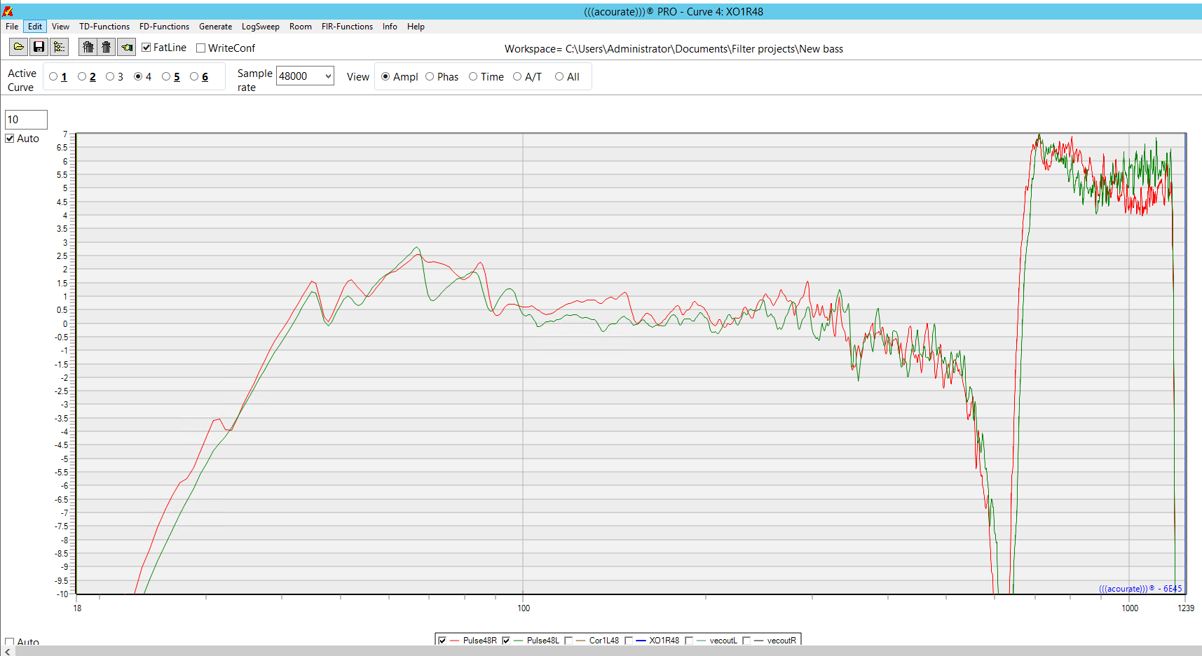

I have now replaced the sub driver with the Woofer 26W/8861T00. I Can state that I am pleased with the result. the Bas performance os very good, affecting the overall sound. I have selected 260 Hz XO and have not experimented with alternatives.
The frequency response in the 63 Liter cabinet is very good and in accordance with the specifications.
I use Acourate for making the phase linear filters and Acourate convolver. I am very pleased with the software.
Br Erik
