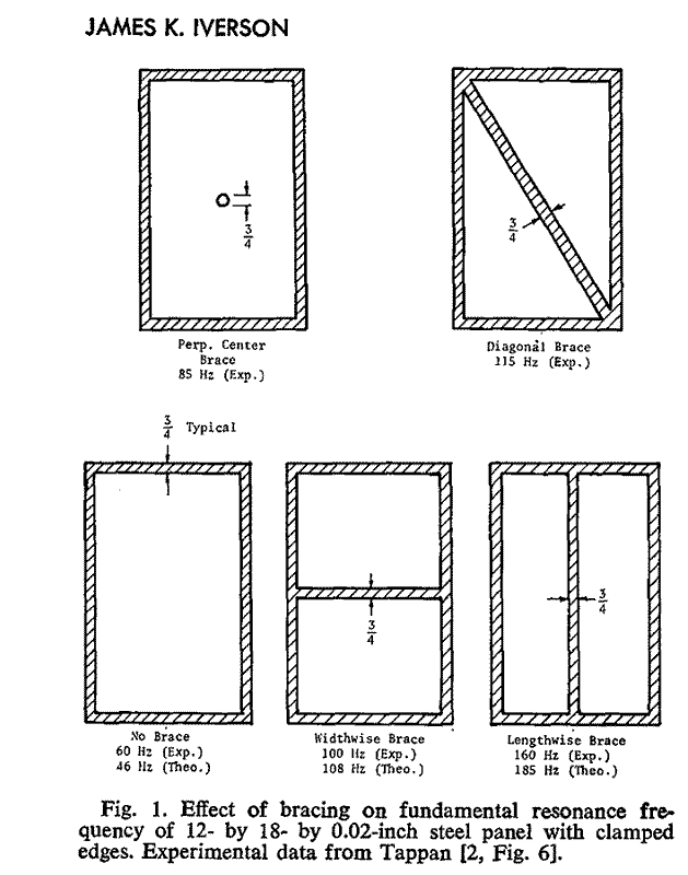

The study behind the image on this paper published in the AES Jouranl seriously disputes that assertion.
The higher the brace pushes the panel resonance the better.

Dave, I'm curious on the conditions of that study.
Is there anything on the other end of that single dowel, like another panel, that would help to stiffen it making it more applicable to how cross-bracing is used in cabinets?
Typically in these diagrams based on plate theory, the diagonal fill on the edges denotes a fixed edge, but the first condition doesn't show this for the center dowel but does for the other bracing conditions. Whether the edges are fixed, simply supported or free will definitely make a difference in the results.
I believe so. But it has been a long time since i read that paper.part of the AES loudspeaker anthologies. i have put it into use very successfully.
