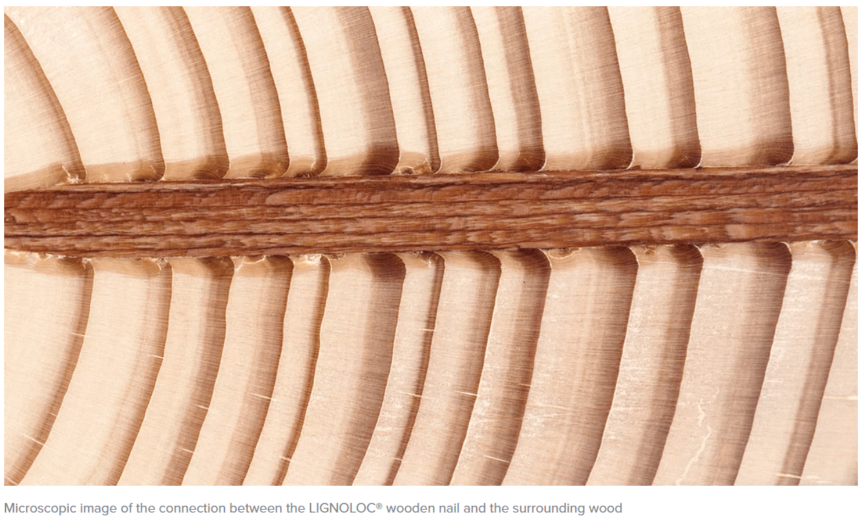

When using Lignoloc you could glue stuff but you could also do without and that also counts for the clamping it seems (!?!??).
I would still use glue 🙂 This new process has some similarity to rivetting. Probably glueless assembly will result. Meaning grooved joint corners for airtight corners.

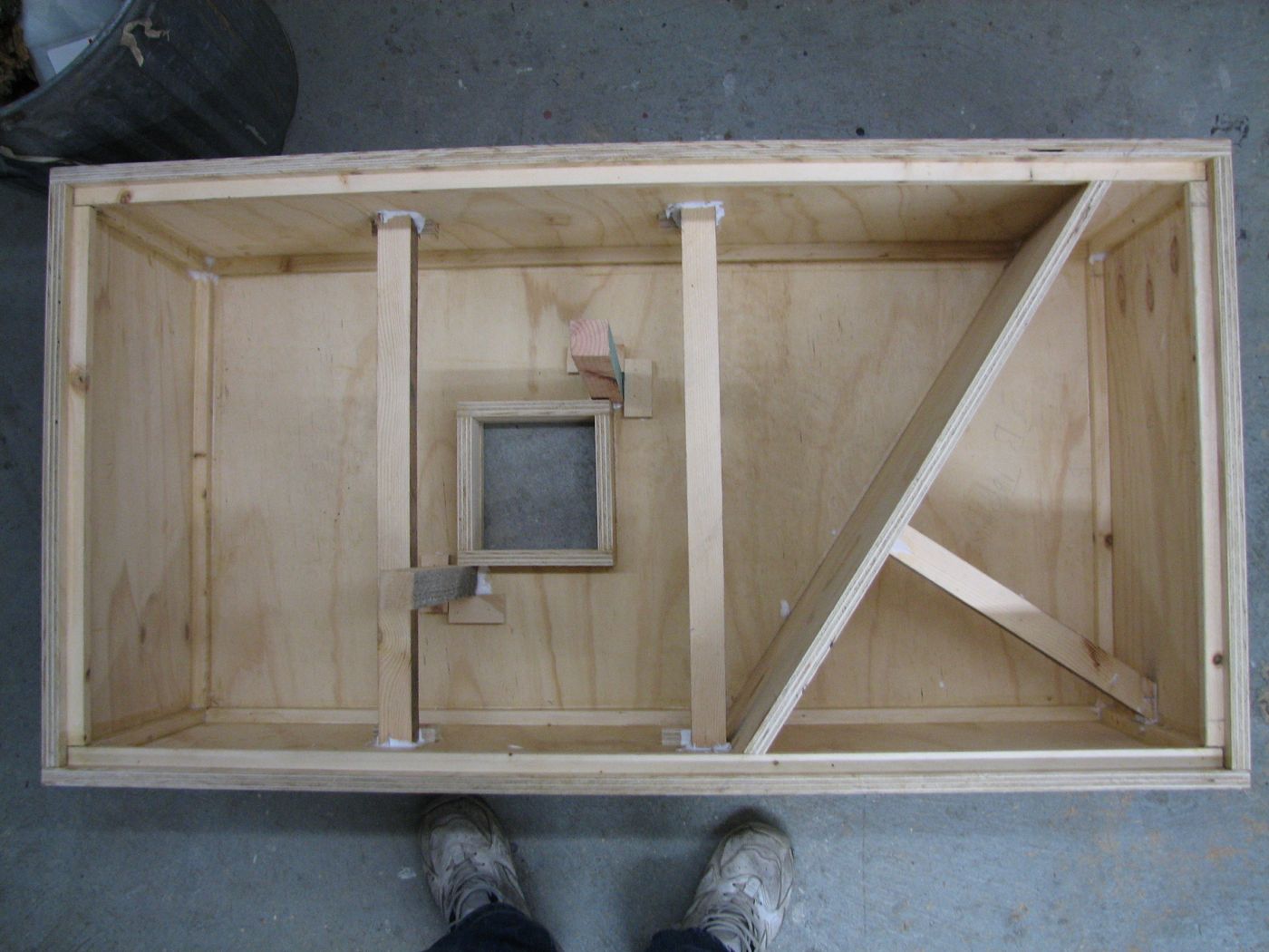

Also: increasing strength of joints without relying on dowels or fancy woodworking techniques that I do not possess or have the luxury of time to master.
The air power nail gun starts at 550€ (top nail gun 1300€), belt of 3,7x50 mm nails is 325€ for 3060 nails.
@prairieboy The difference being I have limited space and amount of large clamps get worrying fast when making 200 liter ++ boxes, it can be really hard to get everything 100% properly aligned, would be really nice to get the parts aligned when glued shoot a couple of almost invisible nails then connect the next segment and so on.
For small boxes I do not have any problem with what you are saying.
@ICG That seems cheap if it allows me to do everything myself rather than pleading for goodwill from my better half, she will gladly help but she has smaller capacity for understanding of how various things should be assembled.
