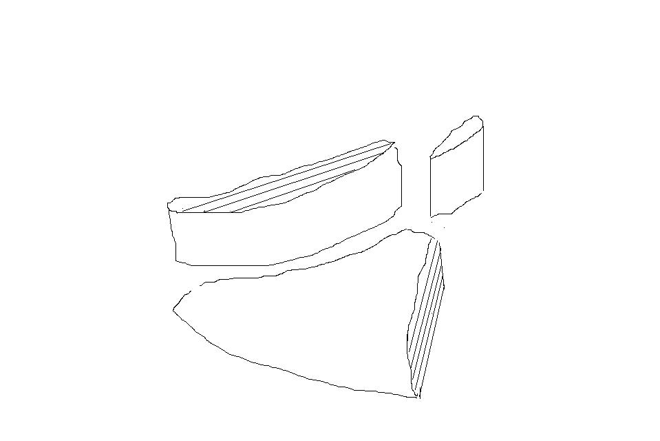

Wooden mid horns
Its not difficult, and no special tools required
You only need good working space, and its a hell of dusty mess
oh, btw
If you are interested, and know how to handle glassfiber laminate, I have "plans" fore doing an easy mold fore elliptical horn, with complex rounded mouth shapes
Afterwards, if you like, It will also be fairly easy to do a 2-part professional mold
But I hate polyesther
:idea:
Mentioning cheese, you just made me remember
You can make this cheese cutting bow like thing
A big one ofcourse
If you put a battery on the string it will get hot
Then you can cut solid polystyrene blocks pretty accurately by following two carefully alligned shape pattern plates
The hard ones fore flooring will be tough enough without any further treatment
Its easy to glue solidly together with polyurethane glue
If you want it to be tougher, paint it, and it will take epoxy laminating
Or maybe ask for poly blocks in surfboards shops
But if reinforcing, I would do that part before assembling
If you want it to be heavier and more durable, put it in a plywood/MDF box
If you are good, you can make some real good looking horns quite easy, and cheap
