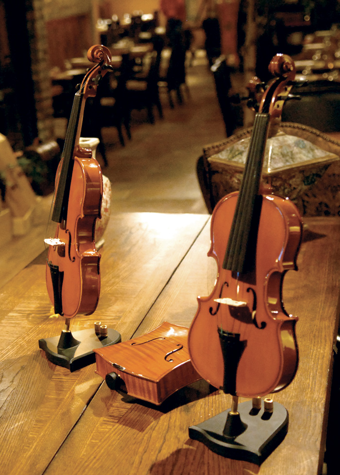

sounger vin
Our products are string speakers using resonance of body of string instruments that attached acoustic vibrators to express strings’ original sounds. They play two roles as speakers and musical instruments. A wonderful sound can be embodied through the acoustic vibrators even if a performer doesn’t play the musical instrument. Actually, musical performance is also possible. In addition, we resolved existing problems of speaker systems concerning acoustical and spatial design. Plane wave emanating from the string speakers clear acoustical blinds in spaces. Further, these string speakers go well with the interior of the spaces.
rgds
jms
The wood cone speaker in the above picture
is mounted wrong IMO.
The propagation of bending waves is faster along
the fibers, so the cone breakup and some widening
of the dispersion occurs predominantly orthogonal
to the fibers.
Thus the fibers should be oriented vertically to
have increased horizontal dispersion.
Strange thing, that a manufacturer does not
understand his own product ...
