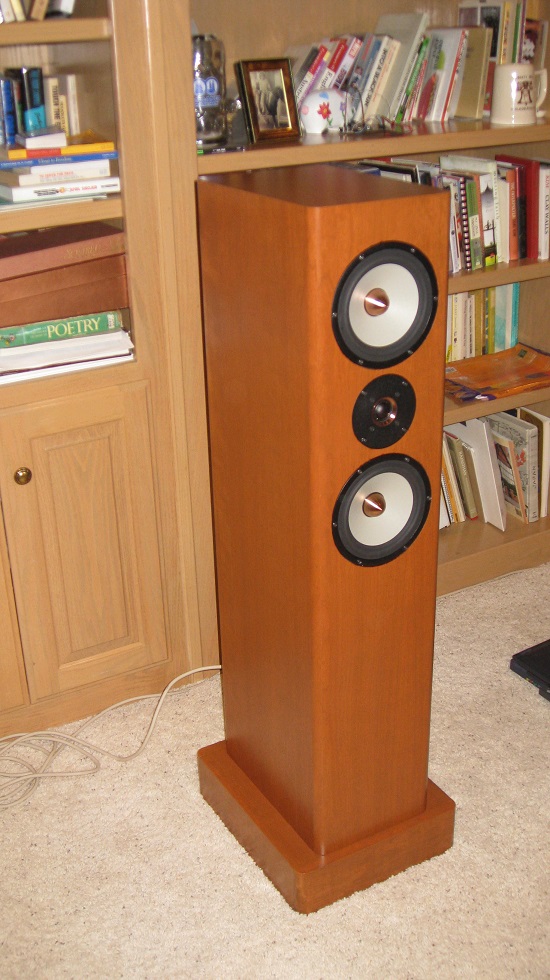

I've had good luck with 10 mil paper-backed veneer, Weldwood contact cement, and a J-Roller (the thing with the green handle, which took a while to find, but worth it.) Lining up the grain to match is tricky but doable. Hope the pics below help.
A great job, I am impressed!
Since you have to use additional glue I guess that it isn't PSA, what is the point of the paper backing?
paper backing allows for much thinner slicing of the "solid" wood veneer, as well as making it flexible enough to allow for easy fabrication, wrapping around curves, etc (in the long grain direction, of course)
and at the risk of boring repetition, the DIY method of tack dried wood glue and iron allows for much easier grain alignment than contacts or PSA
You certainly aren't boring -or- repeating - in my case at least ;)
