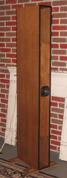

Cherry Ply
I also built a pair of Saburo's out of Cherry Ply. They turned out nice and sounded great too. You may want to see if your lumber yard has Cherry ply.
