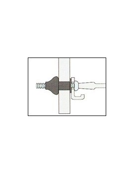

P.S. I know wellnuts as 'Rawlnuts'. These are commonly used for attaching thin items to panels - a bathroom cabinet to a hollow plasterboard wall for example.
Provided your loudspeaker mounting flange is thin, then Rawlnuts would do the job - I can't see why you couldn't use them?? However, you must choose ones of an appropriate length. A Rawlnut will allow you to remove and replace the speaker without having to replace the fixing.

I'm planning to use washers and bolts. Not sure I understand your point about rotation.
The issue I have is that I am reusing a cabinet that I bought from Wilmslow, and I want to use a driver that's rather large. The basket will fit but the mounting diameter for the screws will not.
So I think rawlnuts (seems its a brand, there are at least 3 manufacturers) are out. I can use T-nuts and install before I put the cabinet front on, so long as the bolts do not stick out the back. My plan is to install without rebating the flange and then laminate on a decorative panel (the driver has a 10.5mm flange so I can add plenty more thickness).

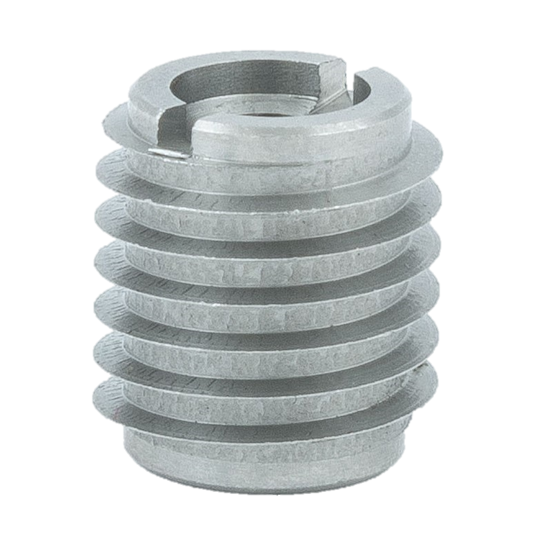

Perhaps threaded wood insert nuts will do for mid and tweeter.
Given that threaded wood insert nuts can be had with quite long length and seem to have a good reputation - is there a reason not to use them? They seem popular for spikes etc but I don't recall seeing them used for driver attachment.
They will. They are also perfect for mounting larger stuff, including bass drivers. You can always use a drop or two of wood glue to fix the nuts in place (but you will then not be able to remove them if you need to).
Use hex-head (Allen) or Torxx machine screws (I prefer black ones) to fit the drivers in place so there is no risk of the screw bit slipping and ruining your day. Add a drop of LocTite to each screw if you're worried about them working loose. (They won't.)
Just make sure you use the largest possible diameter screws (and matching insert nuts) to fit the holes in each driver chassis and you cannot go wrong.

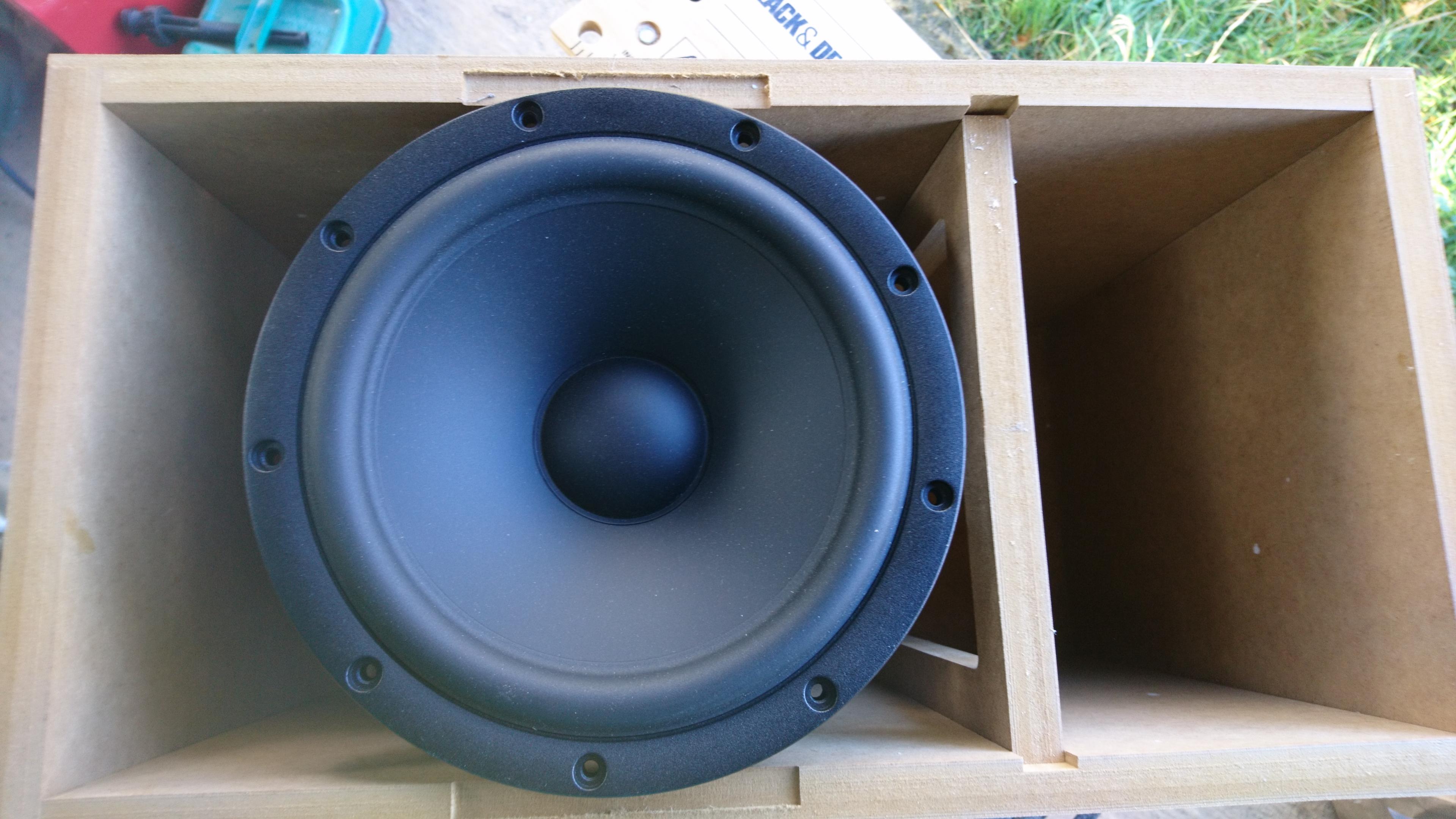

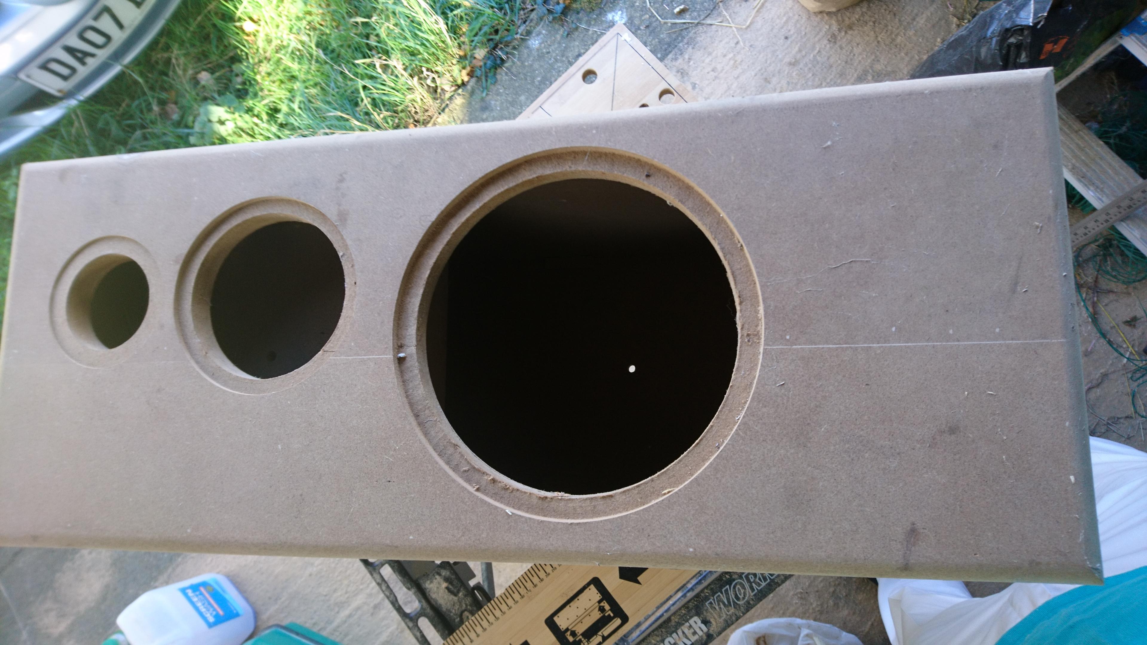

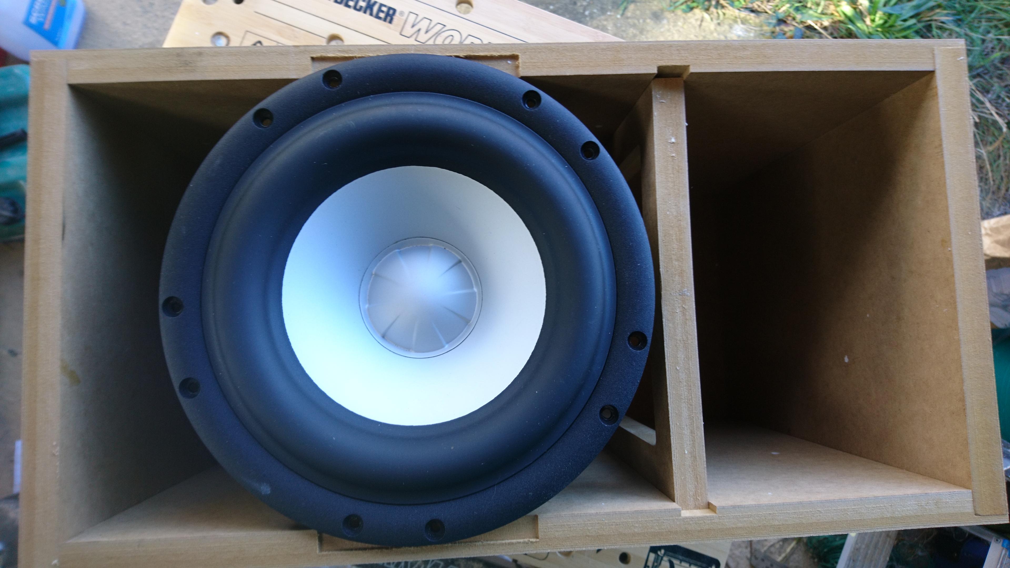

Thanks for your comprehensive reply. However, there's an old saying - a picture is worth a thousand words!
Attached:
WO24P-8 on the Wilmslow HSM. The slight rebates will get filled before I put the new front pieces on, and I will mount the driver much closer to the top. I had considered reserving some space for a 10F or B80 or similar and trying a WAW or whatever - but I'm not brave enough. I can make a series of separate enclosures for wideband or mid+tweeter anyway, and sit them on top and have a play. XO will be DSP so I can reconfigure without cost beyond drivers and cabinetry. In theory, anyway.
Also one of the MDF cabs off ebay, they are a mirror pair. I could just give up on them as too hard to fix given that there is no chamfering inside the mid rebates and they are just a bit small for standard 15cm ScanSpeak chassis (including ones for EAD and Jordan) - but it seems a shame.
Also for completeness, Scan 23W on the Wilmslow cabinet. This was in fact my original plan, after I bought the 23Ws on ebay, and before the 3-way cabs became available. The slight rebates on the sides are related to the way Wilmslow's CNC approach works. They may have told me it wouldn't quite fit, or that I would have some issues with mounting - I can't remember. I've had them a while, and HSM isn't even offered anymore.
Its rather tempting to go with this arrangement and new deeper fronts: the 23W models at 44Hz F3 in this cabinet, sealed - about 10Hz lower than the Satori. But its less flexible in terms of crossover points for WAW experiments.

There are so many mounting holes on those drivers that the use of woodscrews would be more than adequate to mount them securely on the new front pieces.
That would take us back to my post #3.
Is there any reason why that wouldn't suit your Wilmslow box option?
It’s what looks like a relatively narrow margin on that rebated driver cutout for the woofer that I think might cause you some issues with any type of fastener that requires a larger pilot hole than the shank of the machine screw itself.
MDF is notorious for being fragile that close to the edge, and in my experience even more particularly so with as large a pilot hole as would be required, and when the hardened face is removed by rebating as is the case here. If you have scraps, I’d be inclined to experiment with sheet metal screws, no larger than #10, and very carefully sized pilot holes. As long as you don’t plan on removing the drivers numerous times, you’re not likely to strip the MDF’s core.
There are a variety of wood screws designed specifically for use in MDF, but I’ve only ever seen them with flatheads, often nibbed for countersinking, or with a washer round head that could be too large for recessed mounting hole on driver flange, and never larger than #8. The former is a much better construction fastener. I’d counsel against using gyproc / drywall screws in MDF or plywood.

I guess that's true but I was hoping to make something that would allow driver removal for maintenance, perhaps while finishing the box itself.
That might be concerning. I can get 18mm ply if that would be a much better solution. I had been going to add further ply around the carcase anyway, and try to build up so that there is enough width that it does not shatter.

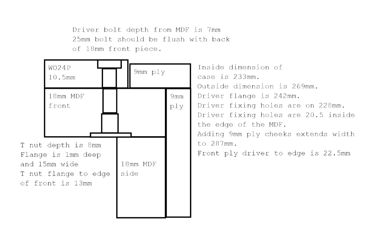

My CAD skills are a bit rubbish. Like my woodworking. ;-)
I've tried to show more or less to scale what I intend - but I had trouble adding dimensions in SmartDraw.

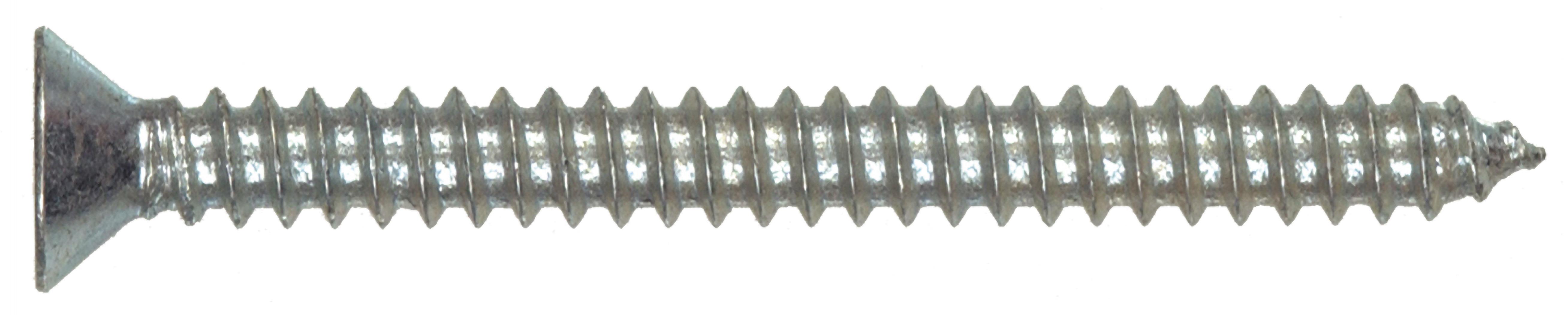

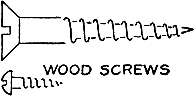

If you do decide to use screws, avoid using an ordinary tapered shank wood screw as it acts like a wedge and pushes the MDF fibres apart.
A parallel shank screw is a better choice - like the sheet metal screw that chrisb has mentioned.
Thank you - I think that's a great call.
Indeed I tried drawing a mounting for the 23W woofers. The cutout in the cabinets is very slightly larger than the specified 225mm - its about 227. And the outer rebate is about 255mm - its quite tight. The flange is about 14mm wide, and the M5 mounting holes are on 240 centres.
So, a 10mm wide rawlnut is going to have 2mm of MDF between it and the cutout. And the wider lip only just fits. I found some M5 wood insert nuts that show 7mm outer diameter and I guess that's not a great deal better.
I had ruled out T-nuts because I cannot create a 6mm hole for the barrel. However I do see talk of people glueing them to stop them popping out.
So maybe I could just treat them like nuts (or indeed just buy some ordinary nuts:
  • drill M5 holes through to match driver (about 4mm MDF to cutout, only a small hole though)
  • Place bolts through without driver and place nuts finger tight to back of cabinet front - reversed so flat is against the MDF and the body faces into the cabinet
  • Glue nuts to inside of cabinet front and allow to dry - fiddly
  • Finish cabinet and then install driver and reinstall bolts
I wonder if it is feasible to glue in 2 steps:
  • Apply very small amounts of superglue to the outsides of the TNut flange
  • Remove bolts once it is holding in place
  • Subsequently apply more glue with the bolts positioned
The same may apply for midrange and tweeter (although M4). The flange is only about 12mm for midrange and tweeter.
So - source flat woodscrews, or try this - or bin the box. I guess woodscrews look attractive at this point.

Unless you plan on removing the drivers more than a couple of times, I’d use sheet metal screws - maybe dope the pilot holes with crazy glue to harden up the fibres before installing. One of the drivers shown has 9 mounting holes, and the other 10. That’s a lot of close margin gambles to make. I’ve tried remounting T-Nuts in large JBL cabinets where the particle board core has blown out, and it ain’t no picnic.
Even if the baffles were of Baltic Birch or equivalent high density plywood, I’d probably still use the screws myself.
