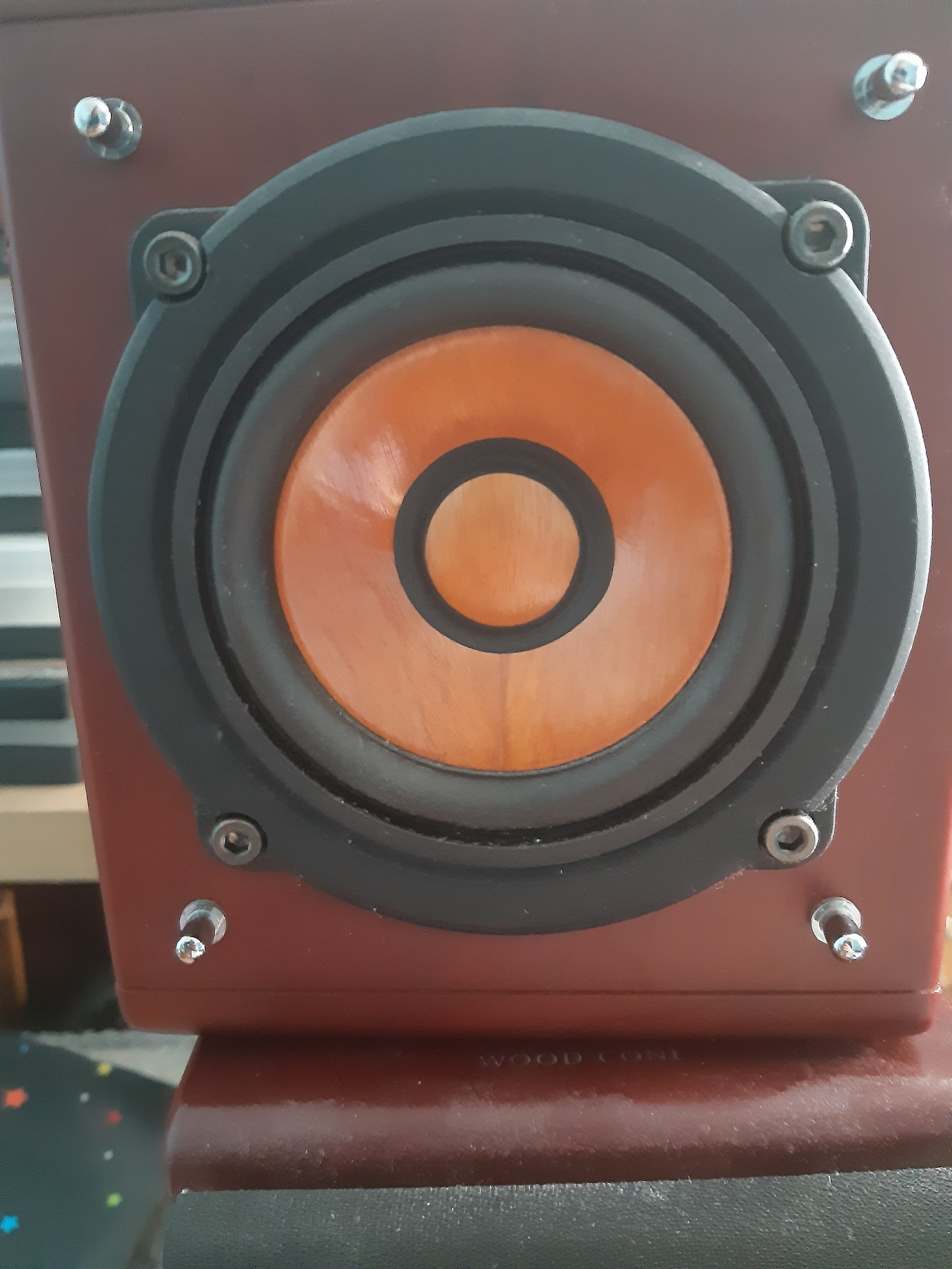

These are the little 3.5" full ranges from a mini system. The drivers are actually rather efficient more than is typical for fullrange this size.
The HiFi reviews of these are pretty accurate:
Listenable, surprising bass warmth, slightly dark in the upper octave.
When comparing with something of a similar size, such as Tangband 3" and Monacor 4" SP40, the JVC woodies have a lot of midrange "bloom", slightly PA sounding bass (tight but not deep), and a seemingly smoothed sound, some nuances are lost.
But in isolation they sound good, pleasurable to listen to, so perhaps they have dominant 2nd order distortion?
