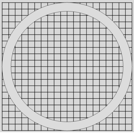

I have to get working on a CNC machine. With a CNC machine I can build three dimensional shapes with specific volumes. I can make CURVES! Compound curves even. Wild shapes that only exist in my curvy mind.
I can't even find BB for under $209 a sheet here in San Jose.
I was trying to make a sphere with this little project. As you can see some of my math was a little off.
[/IMG]
[/IMG]
The driver is just sitting in there for scale.
Any ideas on what to do with it now?
Anybody? Anybody?
I wanted a sphere to sit on top of a speaker and it would hold the speaker inside.
Now if I had a cnc machine I could really rock it out.
Anybody? Anybody?

EmergencyDpt..spheres...
spheres are pretty easy. Just get Ye some correctly sized wooden salad bowls (hopefully made out of Bamboo (a renewable resource), and glue them together.
This has been done innumerable times by folks here.
All you need to know is the internal volume required🙂
you could draw a circle in the XY plane, with the wall thickness required. Then cut it into sections (the same dimension as the thickness of your material) and measure the inner portion and the outer portion. Cut that circle out. Then proceed along until you build up a spheroid of sorts.

I don't want to use salad bowls. Ha ha ha. I want to build them with my hands.
What I need is a way to figure the volume of a sphere from the radius. OK smarties? Can you do that without employing witchcraft? I think I can reasonably make a sphere by drawing a circle, deviding it up into layers the thickness of my board stock, then cutting out circles from my plywood using the width of those layers. Glue, sand, viola!

Volume = 4/3*pi*r^3
Volume = 4/3*pi*r^3
and some more work....
and once you have the rings cut out, you'll need to glue 'em all up, and use a rasp or similar to get the rough shape and then ....sand...sand some more....sand lots more.....until you're so sick of sanding that you pitch the whole project and go get Ye some salad bowls...
or else you could go get a couple of heavy duty round balloons that can be blown up to the correct size. Then glue small pieces of veneer over the balloon to create a spherical shape, and continue on until you have a sphere produced, hopefully with the correct wall thickness.
or make a mould using the balloons and pour yourself some enclosures, or use fibreglass cloth (not chop) and build up a sphere.
Believe me, salad bowls are a lot easier than anything else.
