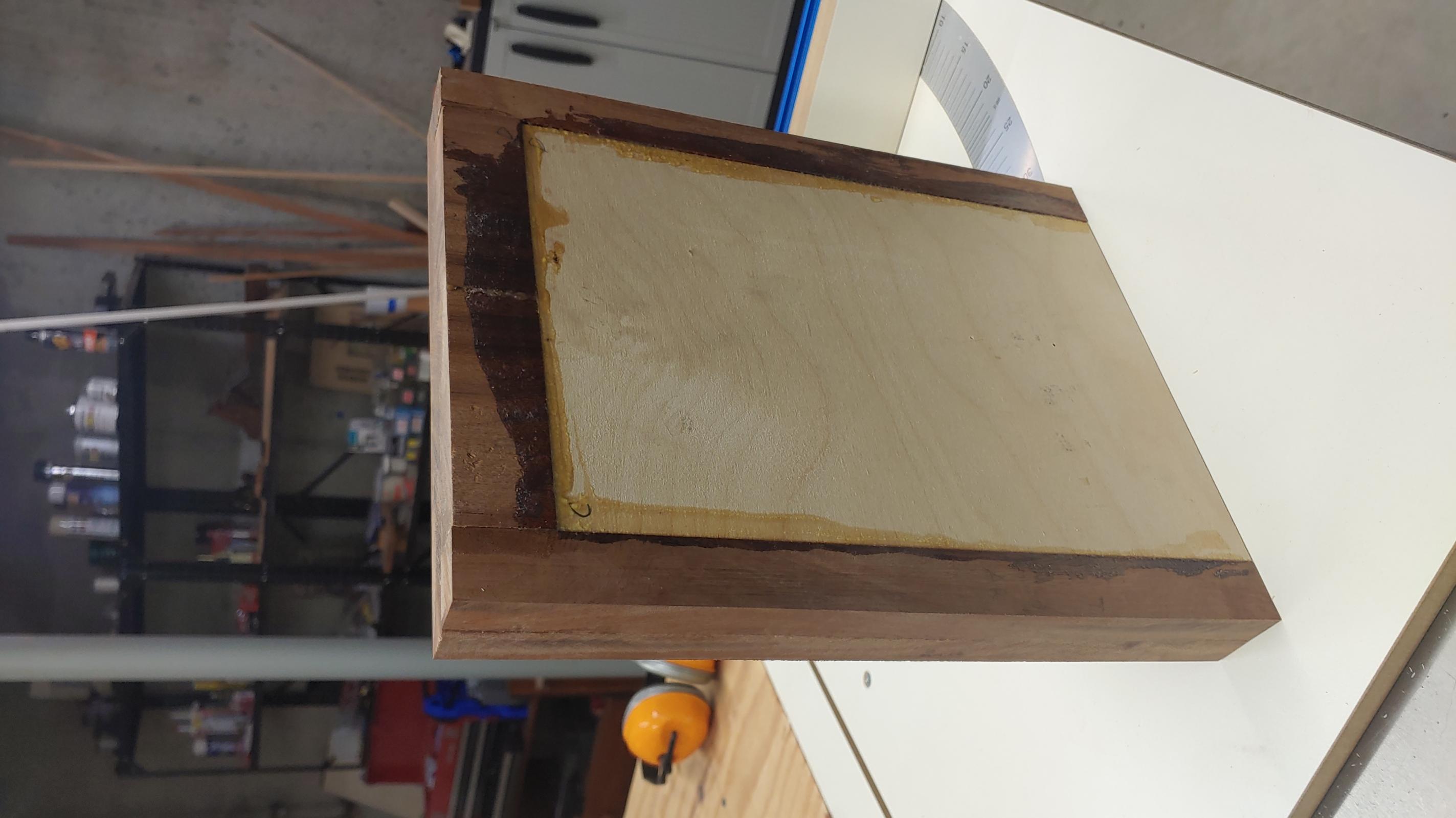

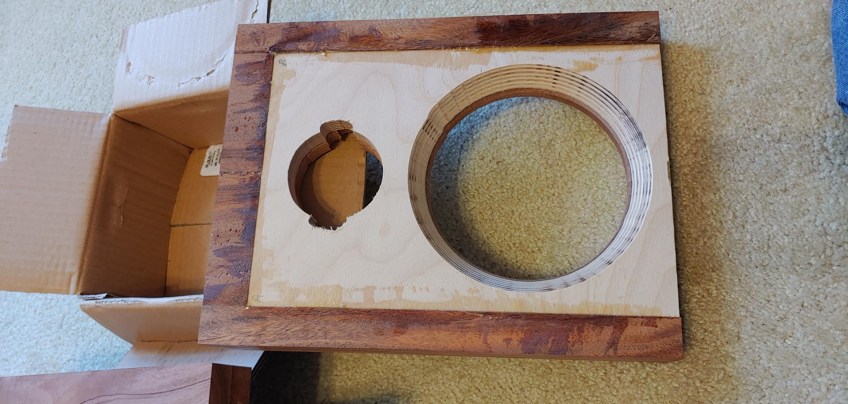

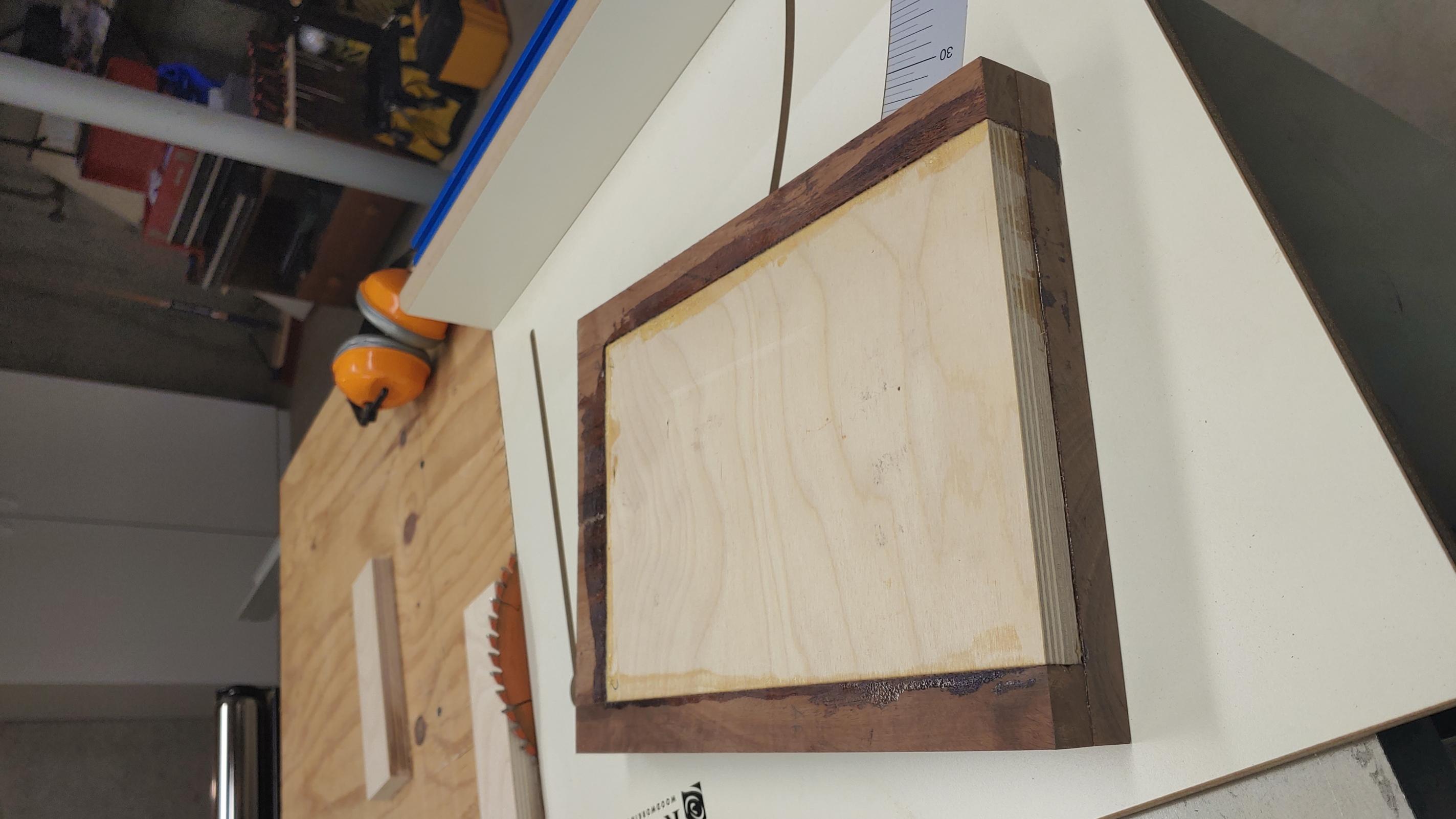

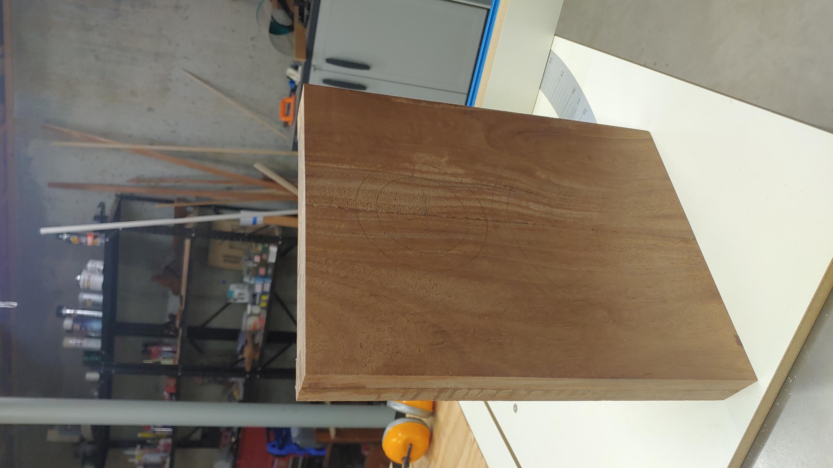

I can offer some thoughts: I recently completed a speaker with what appears to be a solid wood baffle. It is actually a laminated composite of plywood and solid wood.
There is no sonic benefit to a solid wood baffle, it is only done for aesthetics. In my case, with my woodworking skills, it was easier for me to achieve the look I wanted with solid wood. I do not have the veneer skills to veneer a radiused edge to another intersecting radius or beveled edge. Solid wood allowed me to achieve the radiused and beveled edges I was looking for.
My baffle was composed of 19 mm Baltic birch plywood laminated to 19 mm of mahogany. The sides and top edges were also solid mahogany. The plywood was fully encapsulated. I used epoxy to laminate them together.
Solid wood has higher stiffness and strength along its grain than it does across its grain. Therefore to maximize stability and stiffness when working with solid wood, I recommend laminating to plywood. I don't have any experience with MDF or HDF so I don't know if those would work.
Here are the details of my project New active 3-Way, Hypex and SB

You could certainly improve things by using quality plywood instead of MDF. 15mm would be aprox equivalent in stiffness, 18mm would be what i would recommend for a box that big.
And your back will thank you as well.
Do note the very nice bevel on the backside of the woofer cutout in the last picture Jim posted.

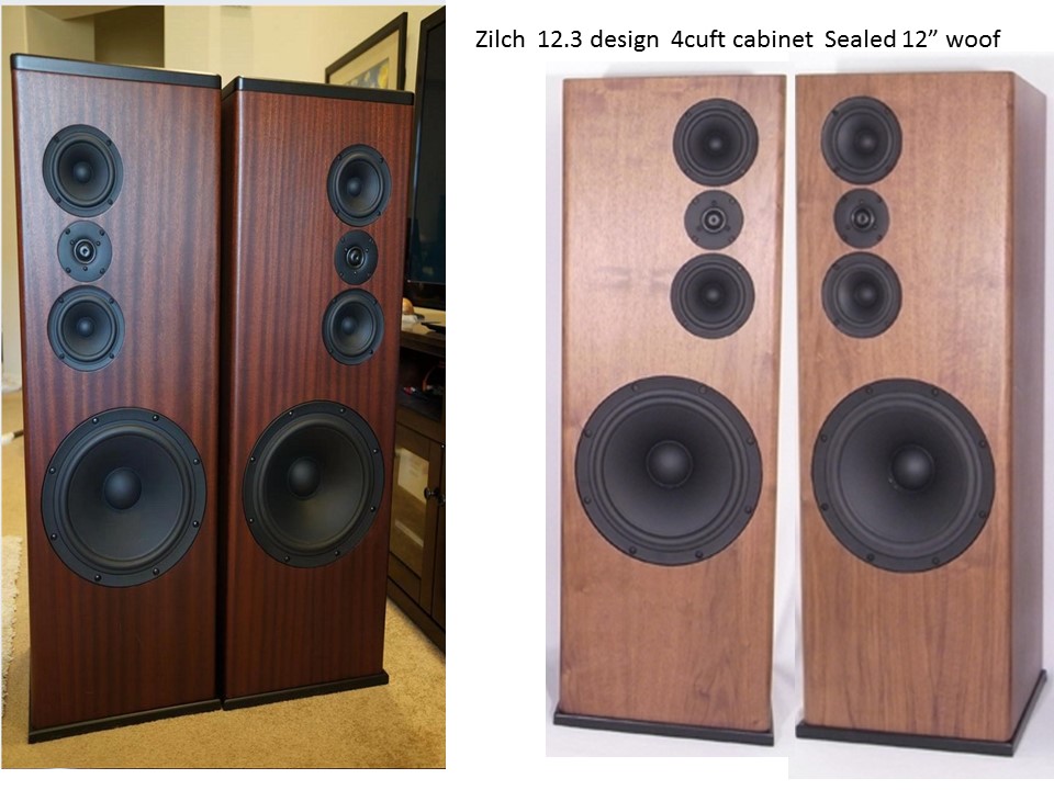

For your MTM, do you plan on using 7" Midranges like the Canton Reference 1.2 DC? Reduce to more common 5" midranges? Zilch build a 12.3 with M=5" which you might review in performance and "appearance".
Specifications
Enclosure type 3½-way Bass reflex system
Frequency Response 18 Hz -40 KHz
Power 500 / 900 watts
Woofer Bass Driver Size (mm) 2 x 12"
Midrange Size mm 2 x 7"
Tweeter 1"
Impedance (Ω) 4-8 ohms
Sensitivity 89.5 db
Subwoofer Size 12"
Product Dimension (H×W×D) 56.3" x 16.5" x 23"
Product Weight 212 lbs
