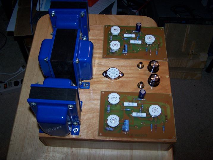

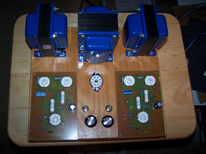

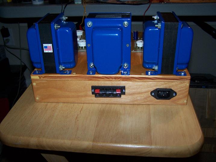

I would like comments on the project I'm working on. I am building an 6BQ5
push/pull amp and I am making an all wood chassis. What pit-falls should I
look for?

long ago I stopped using metal enclosures for tube gear.
Wooden boxes looks nicer, neater and never got microfony with them.
These are my two SET`s: 300B and 6C33C with pentode mode drivers. Point to point wiring, ground bus...
Oak around, 6mm teflon plate on top. No hum, no buzzz, no RF interference, no microphony. Never.
Go ahead. Make neat and you'll be happy for sure.
Just a comment on those speaker connectors: there are better ones out there...

It's not obvious to me that the production of steel is "greener" than the harvesting of wood. The greenest choice is usually the use of used or surplus material. I am able to pick up mill ends (surplus) that make a very nice chassis for very little cost and at zero impact other than the fuel burned on the trip to the store.

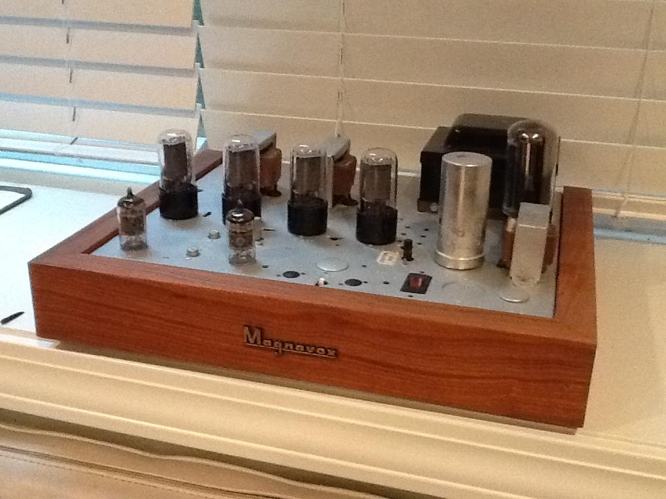

I'm confused. This guy?
You got it Capt Dave. That's him. I have a maggie just like your, except I did not put wood around it, still waiting for the tree to growup so I can cut it down.
