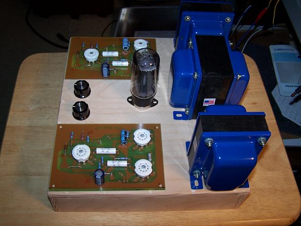

I would like comments on the project I'm working on. I am building an 6BQ5
push/pull amp and I am making an all wood chassis. What pit-falls should I
look for?

Hum (from heaters), buzz (from PSU), RF interference (from everywhere). These problems can be overcome but it is harder because you have no convenient metal screen.

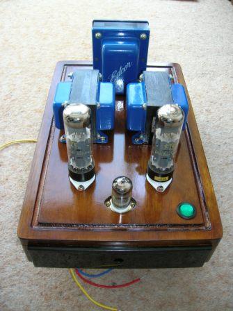

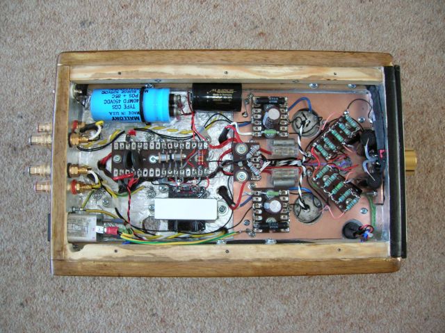

Just for interest, They work great this one is silent 🙂
Its been posted before, I use double sided PCB and aluminium foil.
Just use all the usual twisted heaters etc.
Remember to earth your transformers and all metal parts..Thats why I used a ground plane.
So you could cover the inside of the top with pcb, just take precautions for eddy currents and if you take an AC cable through the ground plane bring the return back though the same hole. Cut any holes and slit the copper to the outside of the board. I prefer wood chassis 🙂

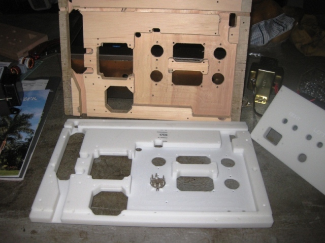

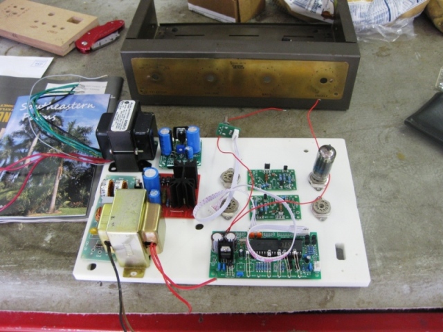

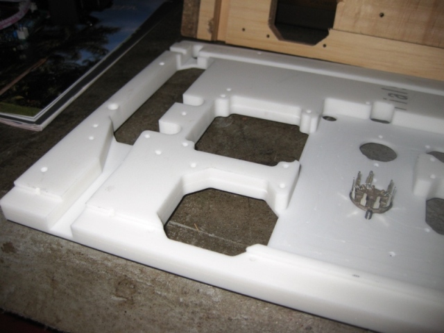

Timely thread. This build is a remote controlled tube preamp. I used my Shopbot CNC to machine a plywood chassis to fit inside an empty Eico metal amp enclosure. I was dreading painting it, worried about temperature issues, etc.
Then a light bulb went on -- use Corian. Corian scraps (especially the part cut out for the sink) can be aquired for cheap or free and machines even easier than wood.
This was pure white Corian. Now I want to get more "artistic" with an amp that looks like it was mounted on a "granite" chassis.

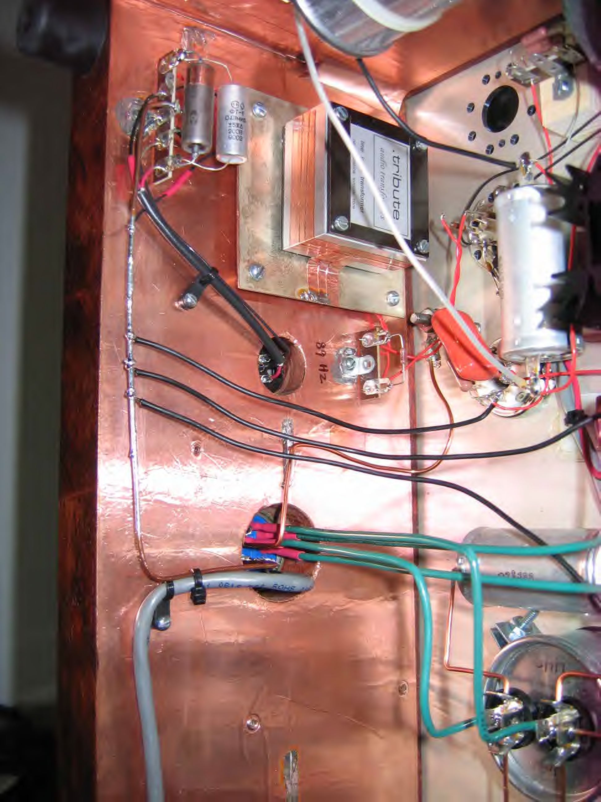

I like to line the internal structure of the wood chassis with copper foil tape, cheap and readily available from McMaster Carr. Solders very easy for a "chassis" type of enclosure. Not shown in the picture, but I also wrap over the lip of the wood, where the top panel rests, so there is contact there, no gaps. Underside of panel is chromated, so there is low resistance.
You can get this copper foil tape with or without conductive adhesive. The conductive style is pricey, so I only use it for grounding cores and maybe capacitor cans as needed (shown in picture on input transformer).
The bottom of the enclosure is of course open, but it also is resting on a steel shelf in my rack, so on a practical level the internals are fairly well shielded from EMI. Nothing is perfect, and as has been mentioned above, the tubes themselves are sticking out in the open.
I see no need for magnetic shielding; my designs are all separate power supplies with 60Hz transformers physically separated from the amplifier proper. I have found this to be so much easier than trying to shield power frequency magnetic fields from an interstage, output xfmr, or triode grid.

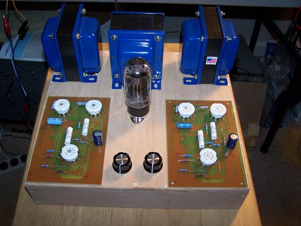

I have made a few amps with an all wood chassis, and two with clear Lexan (Plexiglass melts!). In both Lexan amps I just used a ground wire from the transformers to the PC board. In the wooden amps I stapled a piece of copper screen from Michaels Arts and Crafts to the under side for a ground plane. All amps were hum free. A good PCB layout and grounding scheme is a must.
I have had so so luck doing pcbs...this circuit was simple enough that I wanted to try p2p and it worked great.
You might have better luck with a wooden frame and aluminum top plate.
I look forward to your results...that was my post in the op..
Looks like you are off to a good start.

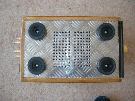

I used aluminium checker plate for the base. Also a single hole at the back of the amp to vent the heat "driven" by the heat from the choke.
